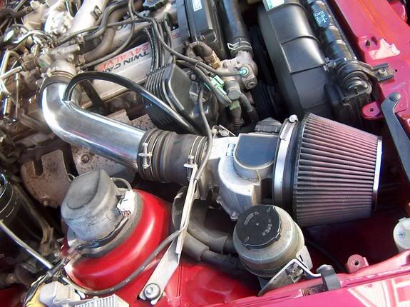

Sorry, but have one question to ask. I also bought the civic intake set up and one of my problem is that the nipple and vac line for ps is too far away. OR was it perfect fit for u guys? If not, how and what to use to get it there? I saw the pic of TAKE....deity.. pretty much the same thing i bought. And i think his blue hose is just hanging there. Correct me if im wrong. Thanks

Mine has the nipple in the same location as the stocker. Another member posted pics of his there as well. However, if you want, you can just replace the hose with a longer one. That or keep looking.
If you look back through the pics you'll see most of the Civic intake users have the PS vac hose running up near where it connects to the throttle body.

yea i see what u are talking about the nipple being close to the throttle body. I will have to go look for a longer hose. Thanks for the fast reply

The best way to do it is simply to purchase a 93-95 honda civic intake system off ebay. Take the pipe and cut about 1-1 and 1/4th of an inch off the bent end and replace with your intake on your supra! Ive got a pic somewere.... I jsut sold my entire setup to bigunitpitcher not to long ago...
edit!
And this set up definatly made my intake more audible. Now, i cant say i realised a power increase, but w/e it looks cool!
I did purchase this from s383! and it sure brightens up the engine bay, and its much louder :)
