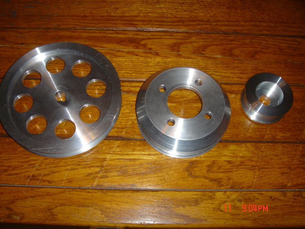

Dave they do have a few scratches in them now but before i send them out for ano'd i would polish them all out. so they look nice and perty i ll see if i can get a pic of all 3

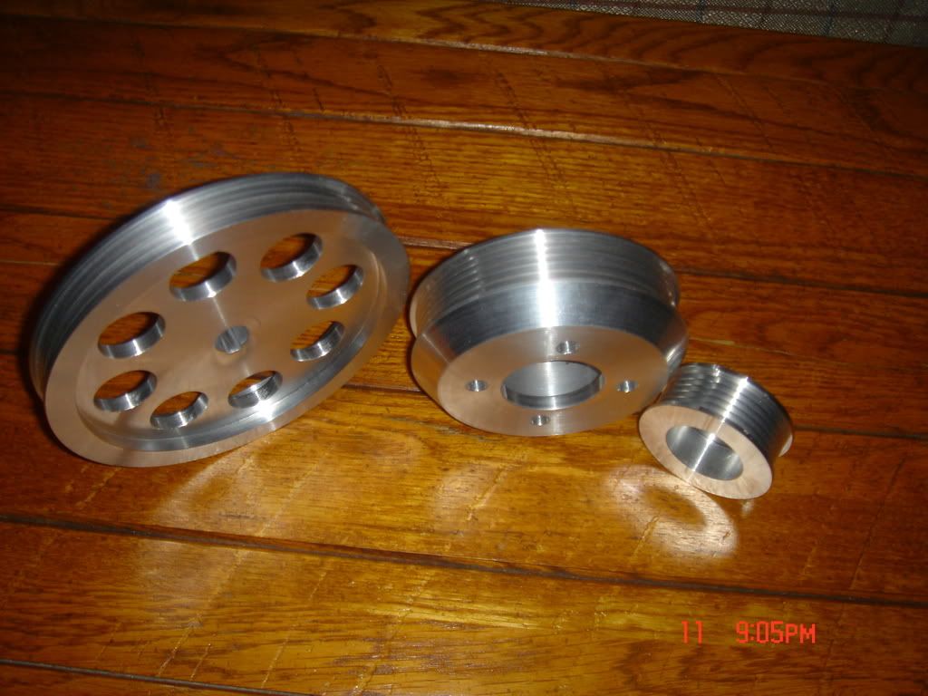

Ok well i have 5 sets avaible now if we can get 5 ppl who want clear it would be the easyst way to do it. Her are a few pics of the 3 pulleys.

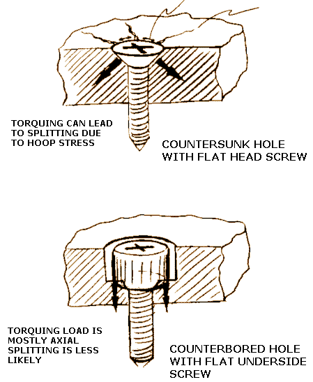

Yes, a counter sink and counter bore are different.
. Counter-sinking is often done to accommodate heads of flat head screws.
. Counter bore is done to accommodate pan-head, fillister-head or round-head screws or other screws with flat-bottomed undersides.
