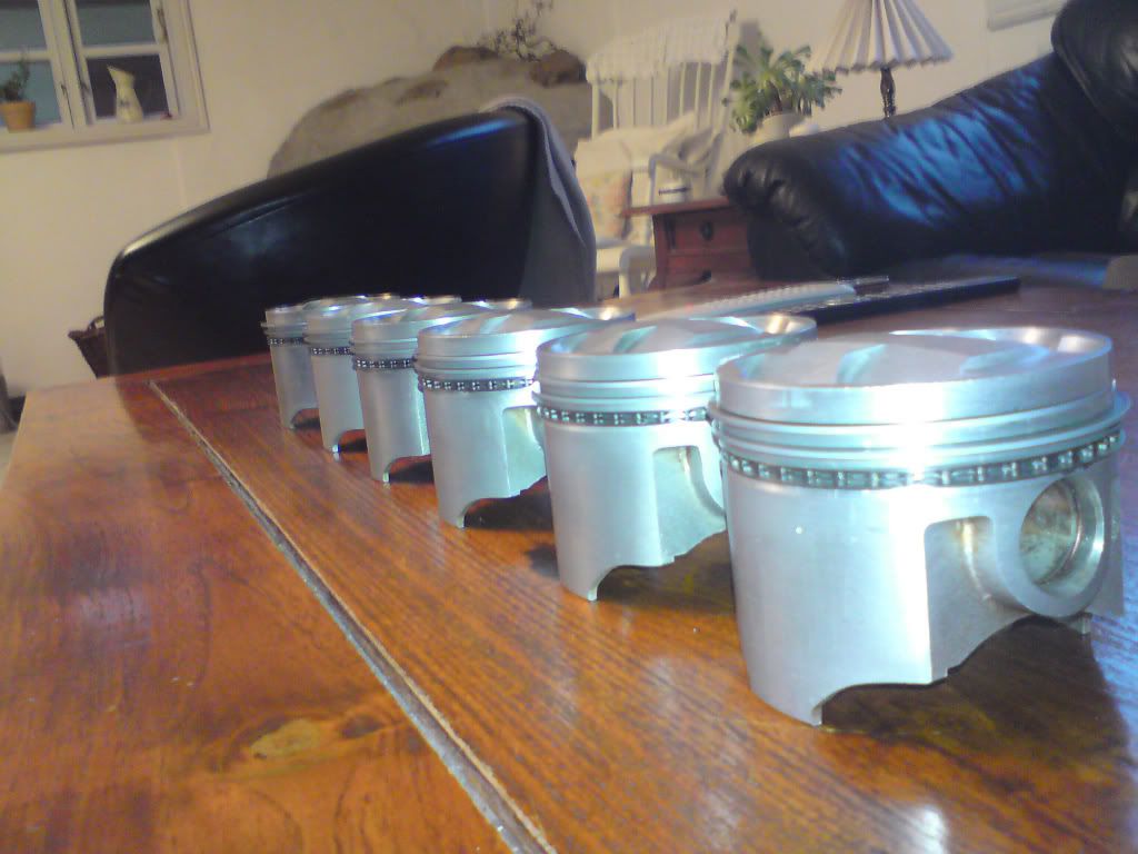

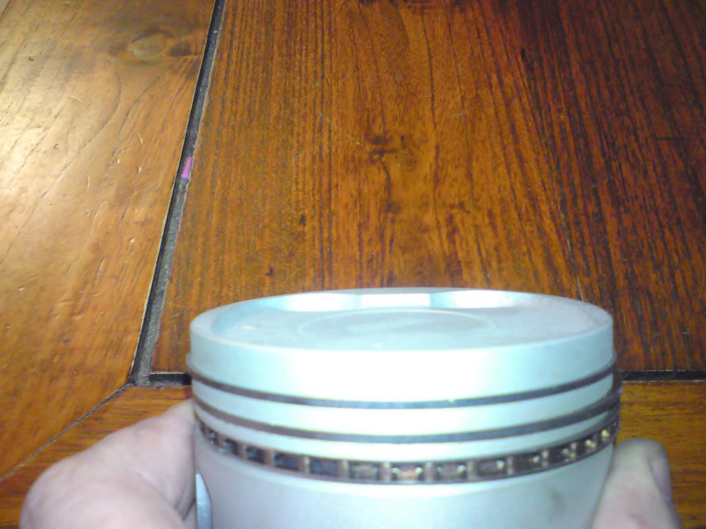

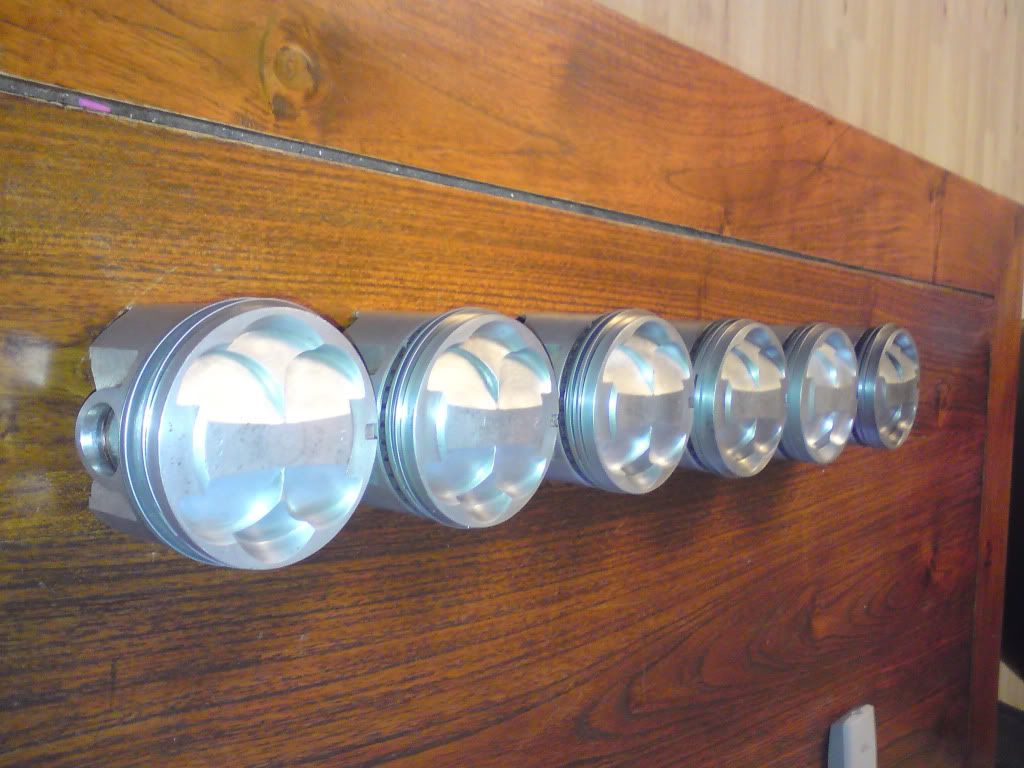

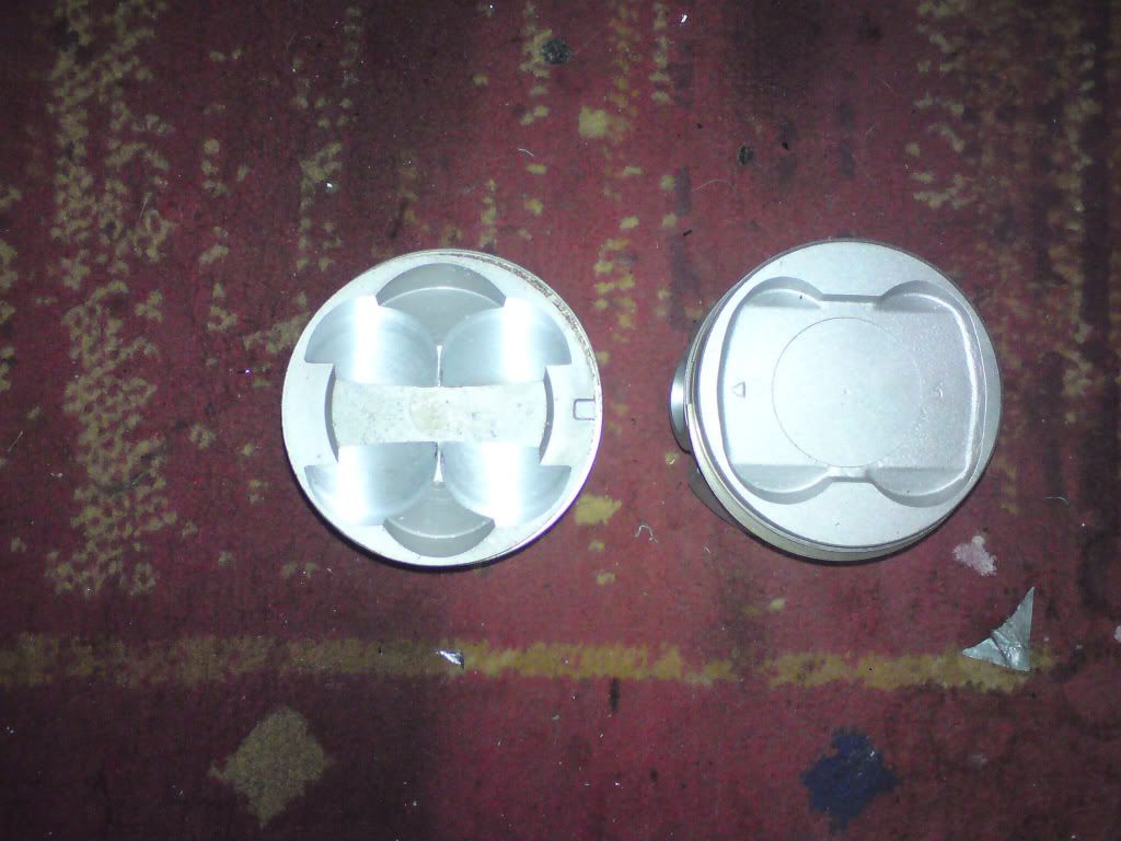

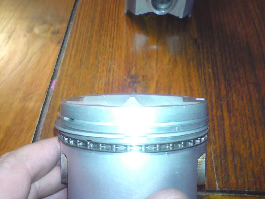

Hey again.
Just for the one who think my compression will be lower.
Here is some pic, where you can see the difference.
Also i got the new ring set mounted here, so tomorrow i will mount the pistons to the rod and perhaps also mount them in the block :)
Best regards Jens Pedersen

Supra_Villan;1431252 said:
why are there 3 valve reliefs?
Original pistons 2 valve per... now cut with 4 valve reliefs, to match the 7M head. (right?)
I see substantial differences in the dome between those... and would buy the increased compression ratio potential on that alone... but there are MANY other factors that ultimately determine his compression ratio... I believe... If he sets his motor up "high", it can be so.;)
Can't WAIT to hear this thing!
