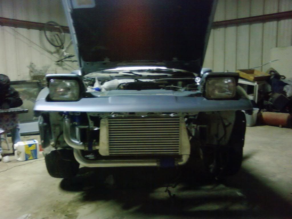

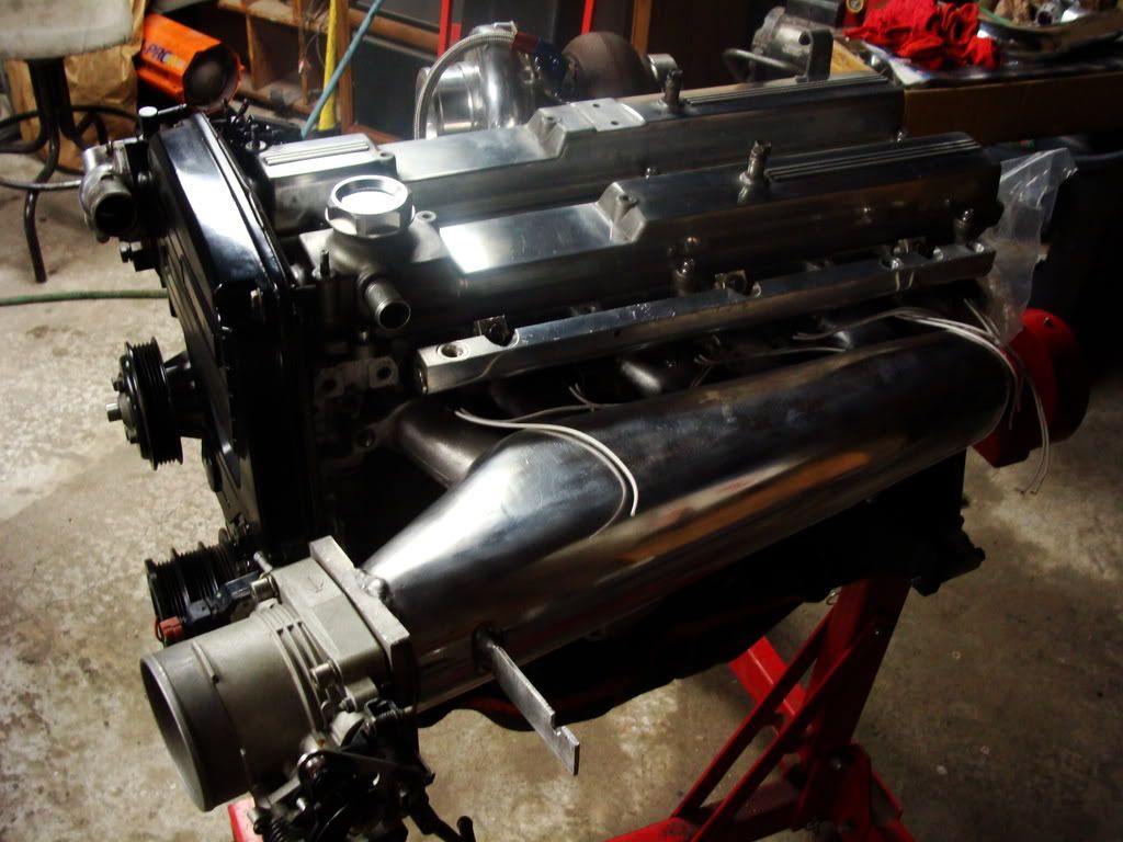

well here it goes....
i need to have the intake mani, lower runner and tb powdercoated(will be done next week!), they look like ass, the paint is all chipped up and faded and they are two different colors, chipped shitty red, and chipped shitty black, I know you ask “why? but your mani and tb look good in those pics!” yeah it did, BUT I had damn near 900 dollars in that setup with the ic and stuff, and the piping still needed to be fabed up, I have zero welding skills, and no one I know has a portable aluminum welder for a decent price so that meant I would have to trailer the car a minimum of 30 miles to have it fabbed up and welded, and pay for that too. So i tapped out, sold the setup, got a bolt on fmic(very nice btw), along with a stock manifold and some other things I needed. So there’s that, I have the downpipe als and my wideband bung needs to be welded on, but I have a friend who will do that, I need to bleed the clutch, brakes, put on the starter(if its worth anything anymore it was kind of sometimey before all this) and run the rest of the harness, and then fill the rear end and trans with 6qts of royal purple 75w90 and lsd additive, (4 for the trans, 2 for the lsd) which I still have to buy btw ugh(77.41) and then put the tune on it and she should be going after working out all the bugs and stuff…

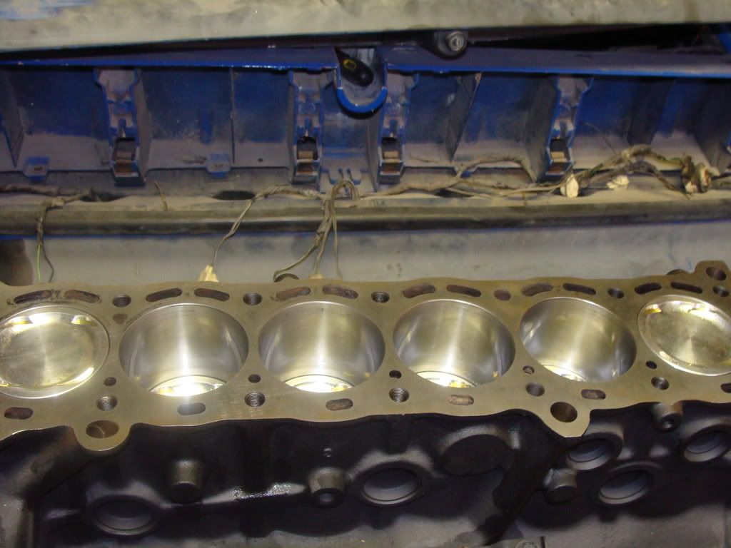

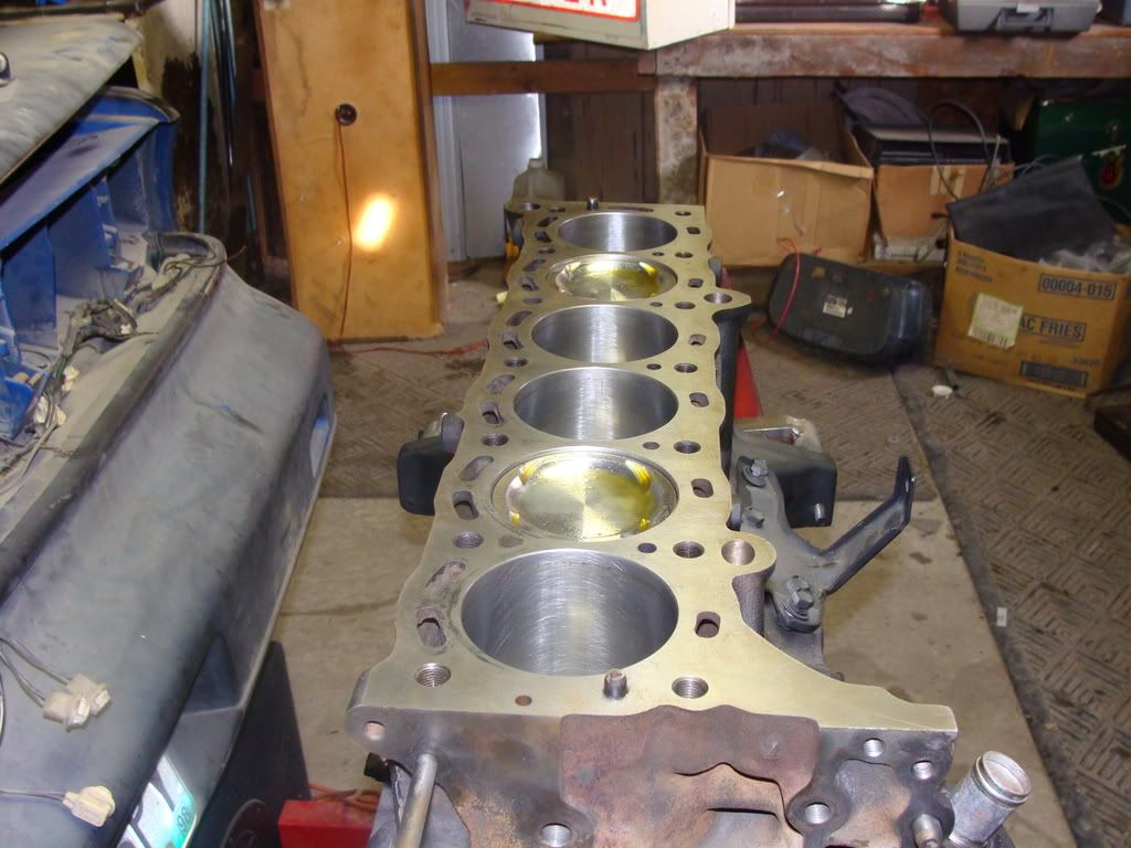

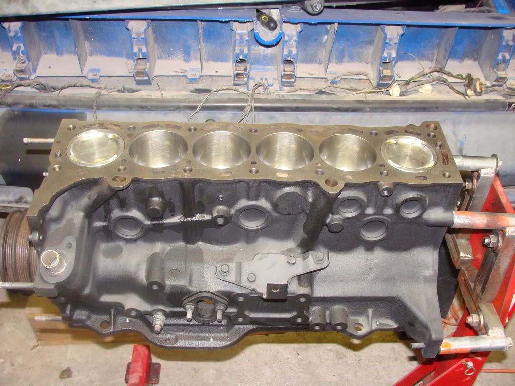

mods thus far-7m, JE's(.20 over) eagle rods, balanced crank, 5-angle valve job w/high temp seals, polished and swirled valves, tms 2mm HG, ARP's, godspeed fmic kit, SSQ, sc61 turbo,custom downpipe, spec pp, act 6-puck disc, fidanza flywheel, PTE 550's/lex afm/afc/lc1 wb, walboro 255lph, aeromotive FPR, 17" Konig's, sumitomo 245's out back, 235's up front, 255/55/16 MT ET streets on mk4 rims for fun fun, Powerslots, ngk plugs n wires, KYBshocks, Eibach Springs, gutted rear, adj. sway bar end links

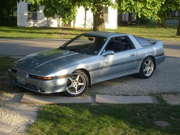

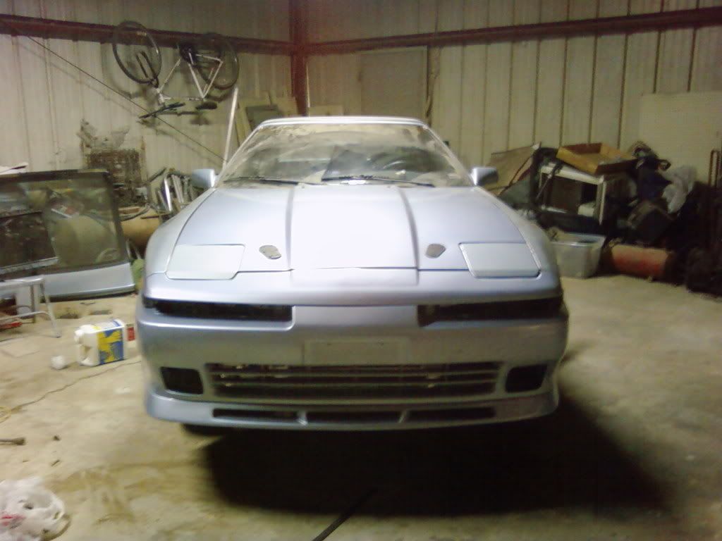

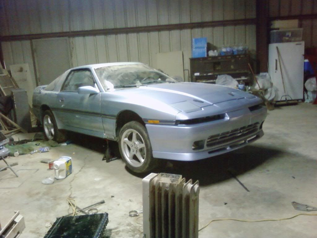

here is a pic from when i got her, she had a mbc running 10 lbs, apex'i air intake, rims, tires, springs, shocks, and an open tms 3" down pipe, before the big build i put on a few things, ssq bov,upper hardpipes, and a spec clutch

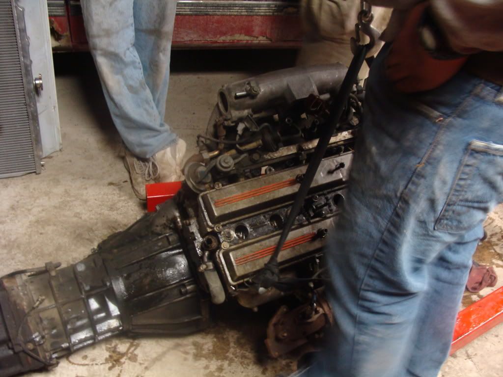

out with the old....
in with the new

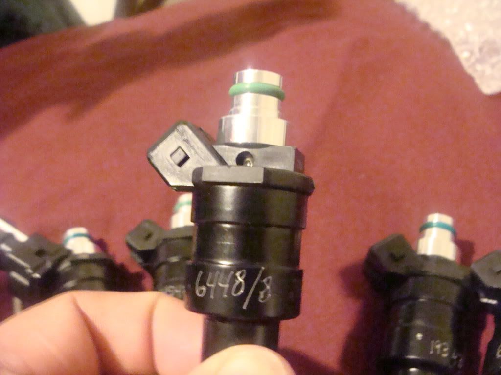

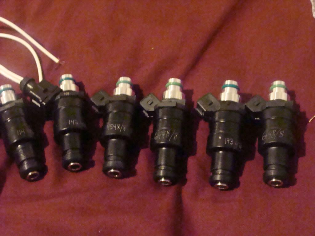

precision turbo engineering 550cc injectors

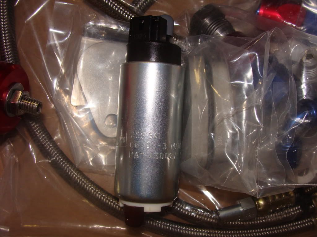

walboro 255lph fuel pump

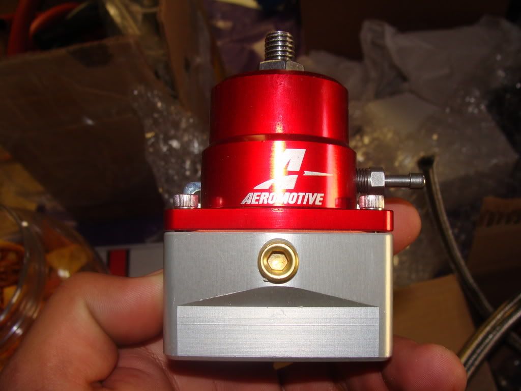

aeromotive fuel pressure regulator

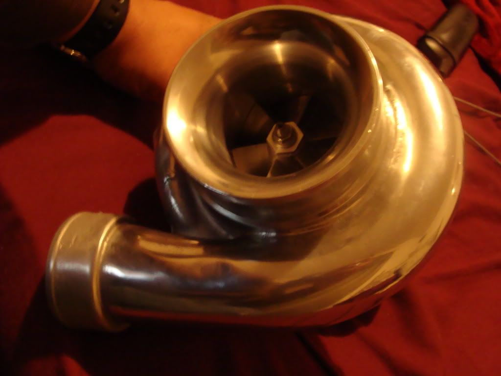

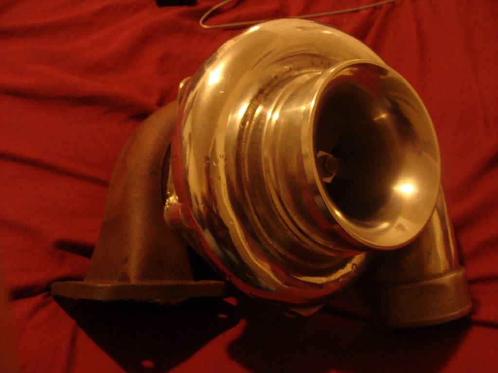

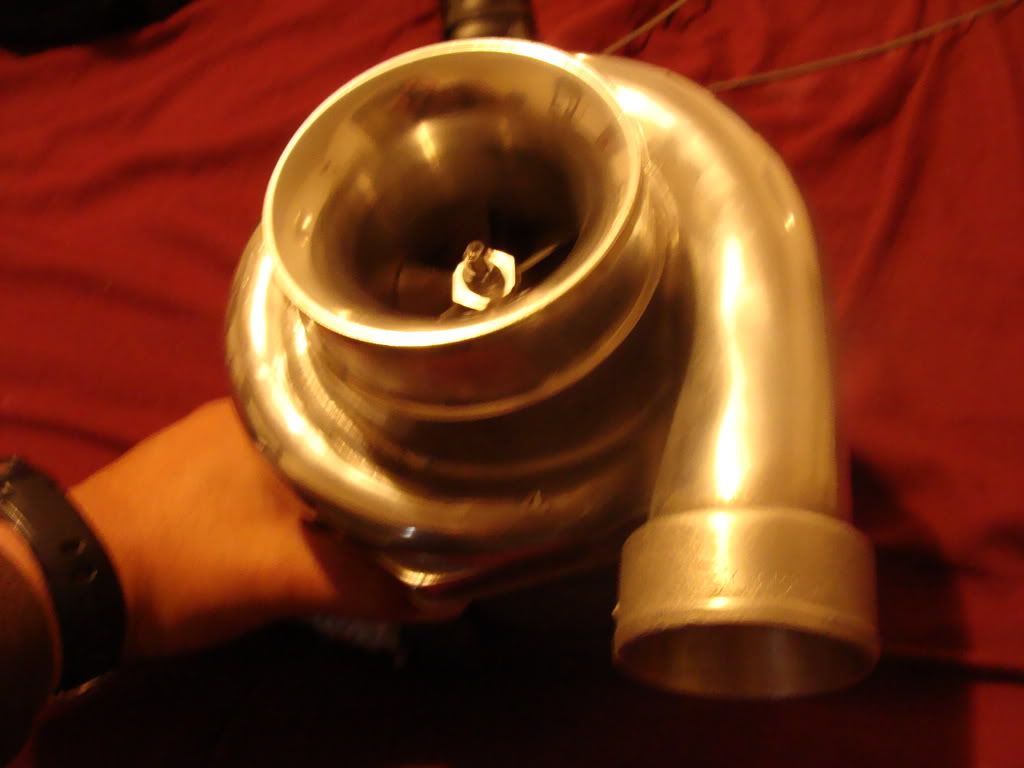

Snail! precision 61mm biatches

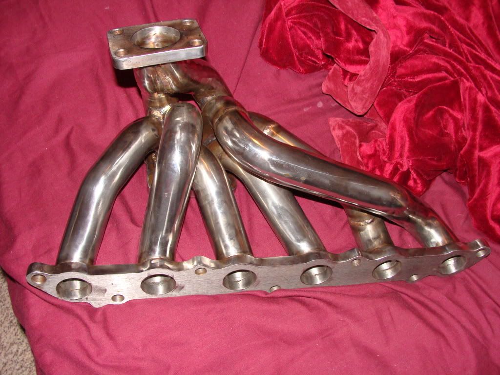

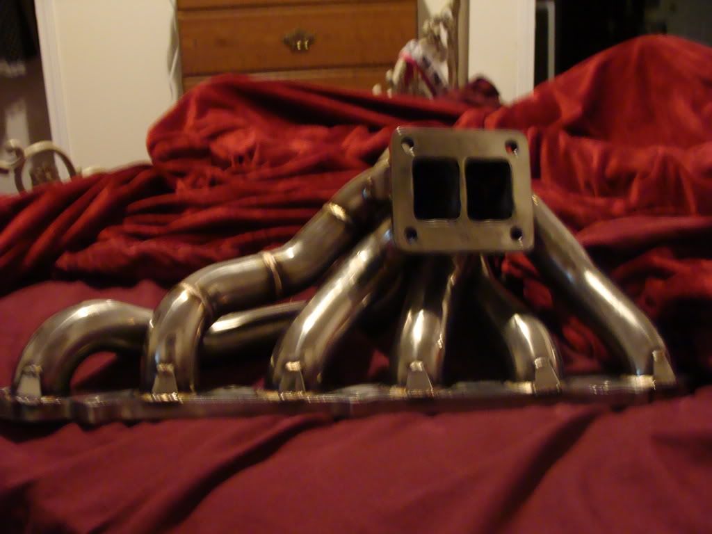

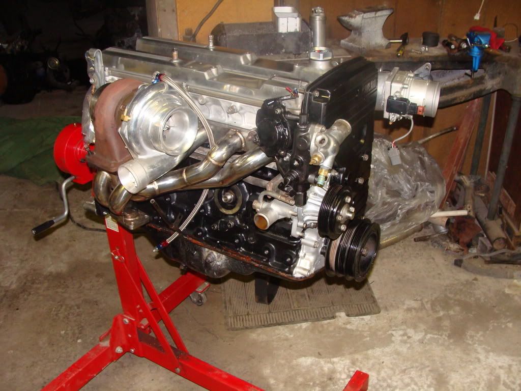

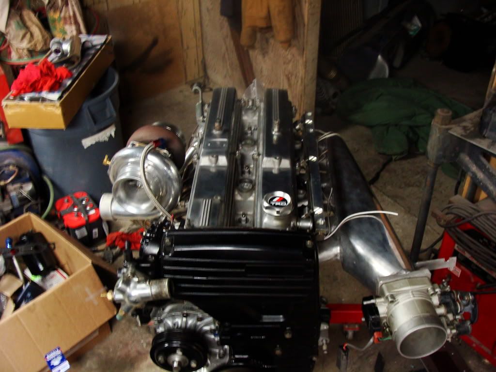

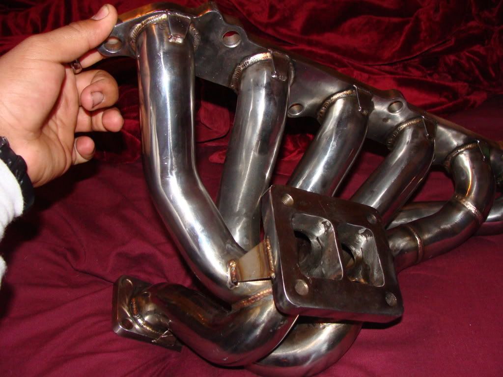

china man t4 manifold w/4-bolt 40mm wastgate flange, i'll be running hks 40mm

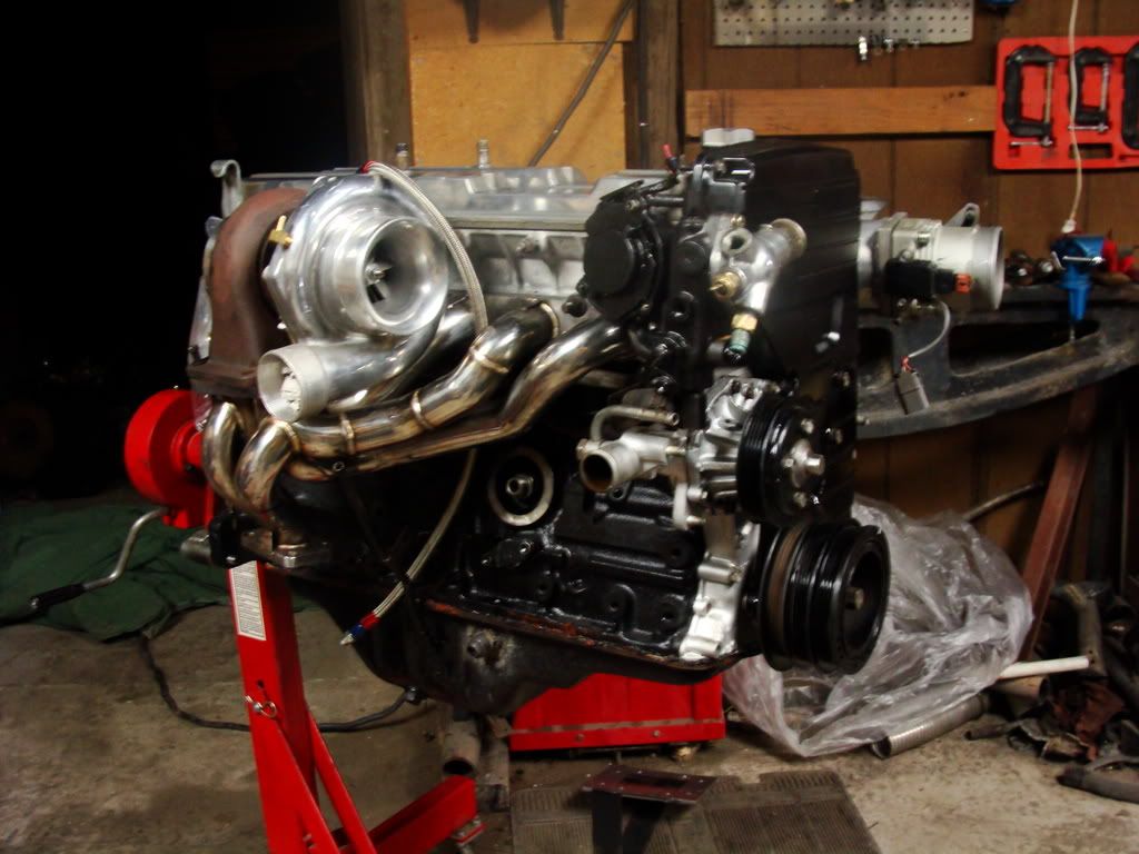

all bolted up

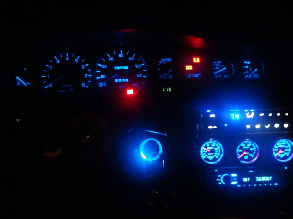

full led cockpit!!!

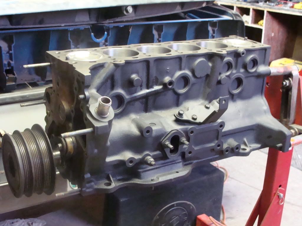

the dash, keyring and glove box lights were supplied by superbrightleds.com, and installed by me. The climate control was done by tsiwithpsi, he is a solder beast! like 20 blue, 20 white and one lonely ass red led's supplied by the chinese!! thanks china! Once my oem parts from tejastoyota in texas(ordered through a guy on on supramania he is an awesome guy to deal with, he got me 20% off!!) get here, which should be next week, i'll finish the engine on the stand, harness and all, and drop that bitch in by the weekend hopefully!!!!!!!!!! but here are pics of the dash and stuff.
gonna keep me comfy
excuse the cell phone pics and dusty ass car
