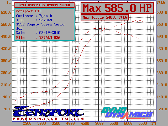

specs are
bc 272
mild ported head
stock vavles
pte 67 with a 68
tail 46 mill gate
I had fair amonte of heat but I blame that on my low timing map wiht good tune heat should be with in reason and nothing to worrrie about
have fun
here is my dyno grauph

awesome!! well i do want to revv up to 7 or a bit more.
Ill get it on the dyno with the .68 and see where it starts to fall off, then i ll just shift at that point until i feel the need to get a .81.
