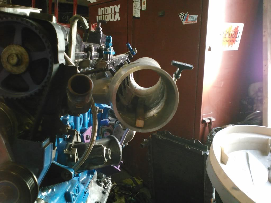

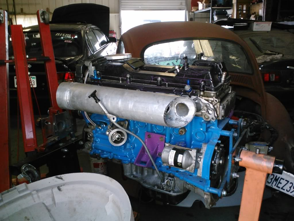

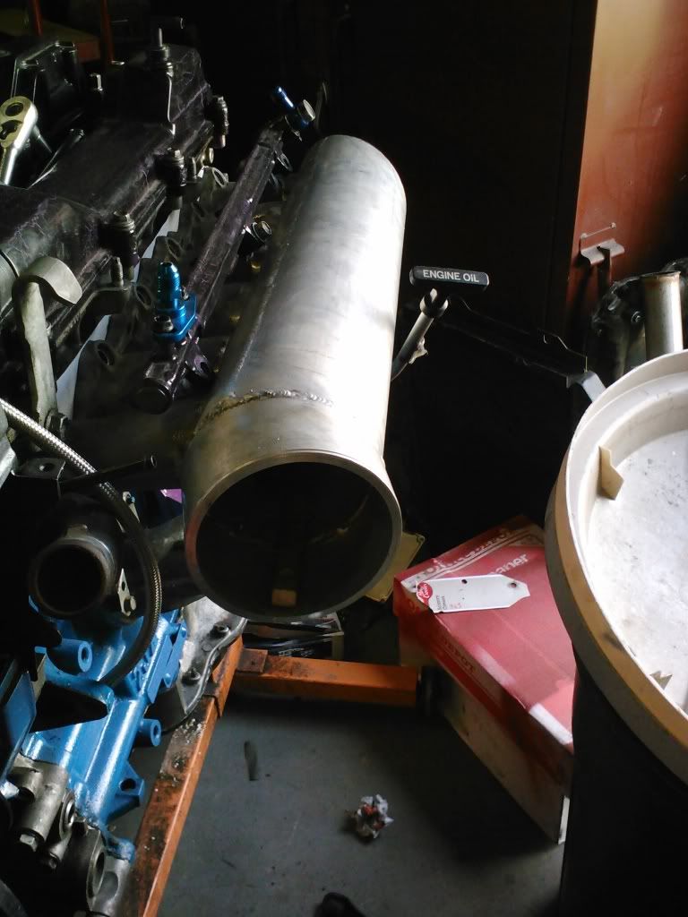

While this may have been enough, I really don't want to risk smacking the compressor housing off the strut tower during some spirited romps on the accelerator pedal. So some more cutting and grinding and we now have this for clearance:
I will be remaking the down pipe due to the upper cat resting a little to close to the floorpan/firewall. Other than that, the factor heat shield even fits - will be modifying the shield a little bit to make it look cleaner.
I will post better pictures of the manifold once I get it finished at work. Probably wil not be coating it as this will only be a temporary setup while I fab the new design/permanent manifold.
