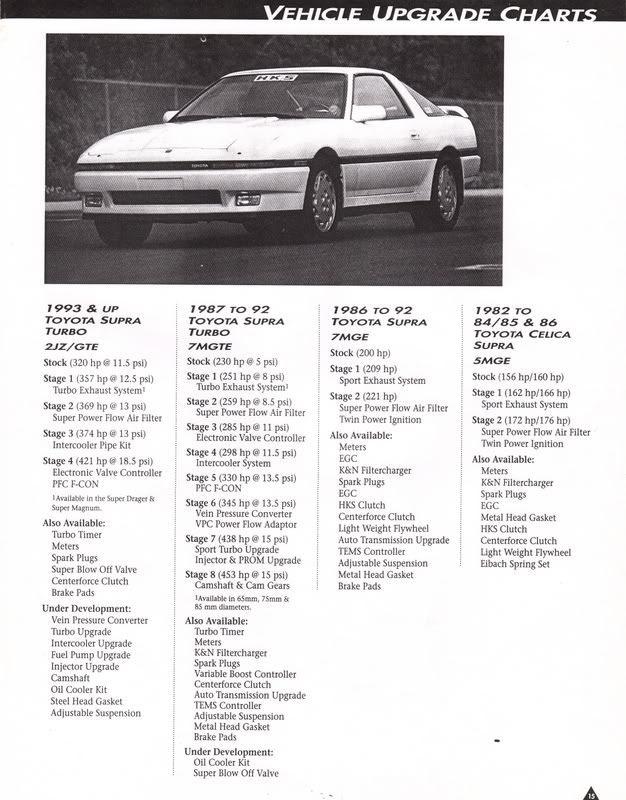

HKS..........................FTW!
Just go through the "same stages" (equivalent) of a "balanced and progressive" upgrade illustrated by HKS' stages... AND consider the "other" performance KEYS such as brakes and suspension... you will be rewarded.
NOTE: This is assuming the car is being "maintained/repaired" to GOOD condition as a platform.
-crisp
