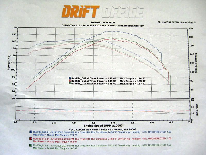

Oh, guess I should mention the car was dyno'd some weeks back. Due to my retardedness, I did not dyno at WOT so the #s are low; 155whp and 175ft/lbs

Will re-dyno again soon. My guess is 180hp 185ft/lbs. Everyone who's been in the car has said 180, and the car smokes all the n/a mk2s around here. Even one of the turbo mk2s here has a hard time catching up to my car.

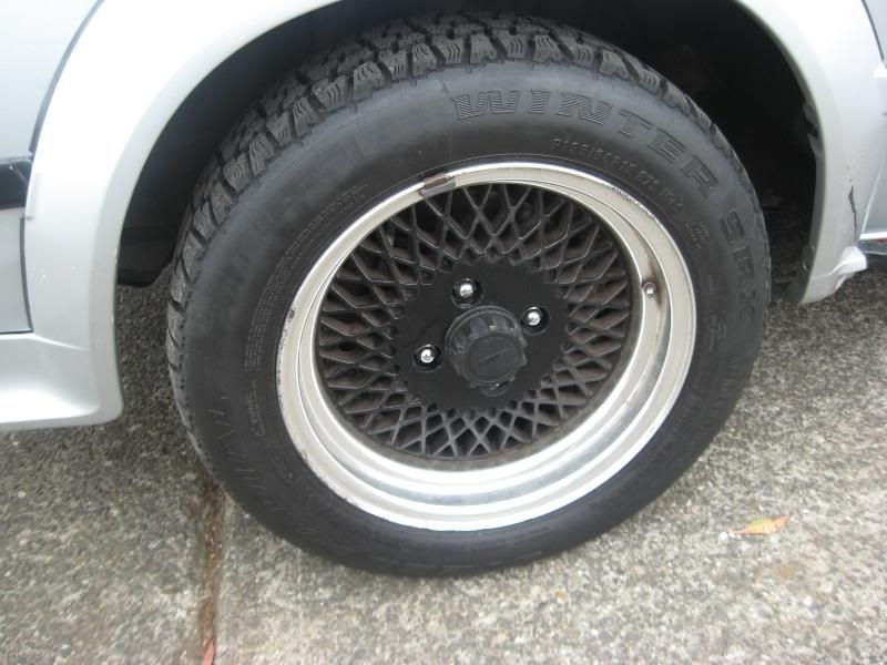

Weeeeee! Not that anyone cares, but I'm getting some wheels finally!
They're not the best, but they're cheap. 15x7s that are curb rashed; they need refinishing and new paint but even so, they will look like sex on my car. SEX I TELLS YA!
They arrive early next week. I need 3 centercaps though, lol.

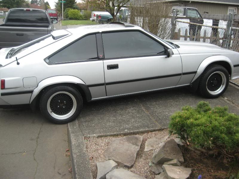

theKnifeArtist;1055593 said:
car looks great with those wheels :)
lol, the silver car isn't mine, it's the car the wheels are currently on. My car is black. I should have the wheels next week.
