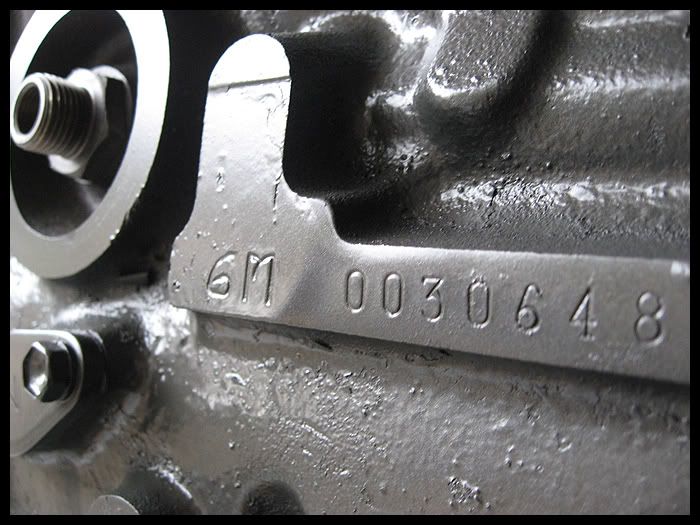

So, as very little of you know, I acquired a 6MGE block on craigslist for $50 back towards the begining of the year. Got it home and gutted it, only to find that the crank and rods were wasted. Thanks to the generosity of a few, I was able to get the parts I needed for my badass build.

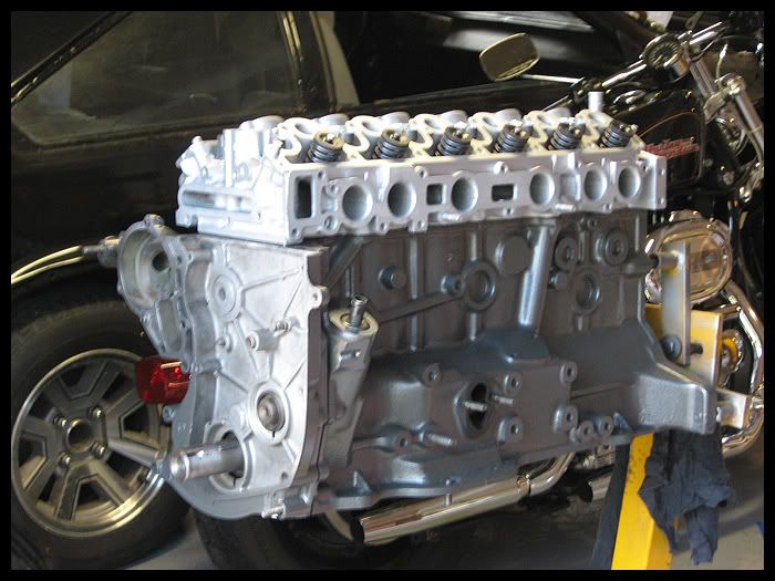

My parts table, slowly started getting cramped
Got some goodies back from the machine shop
Polished & balanced 6M crankshaft (out of an early 7MGTE)

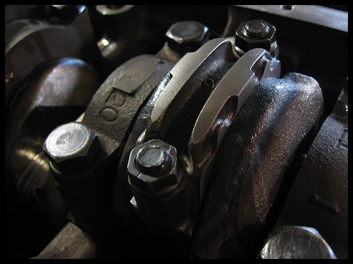

7MGE connecting rods, 7MGE crank pulley

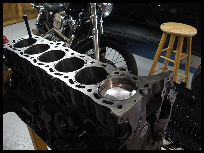

The last ride my 5M car gave was to go pick up her 6M block from the machine shop

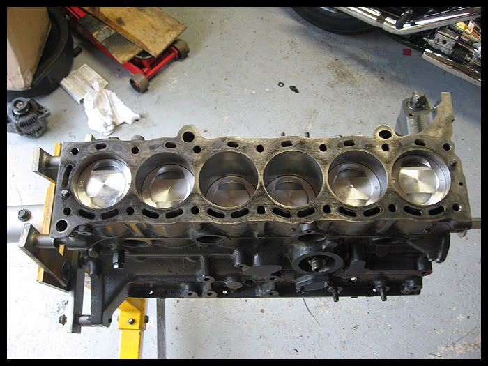

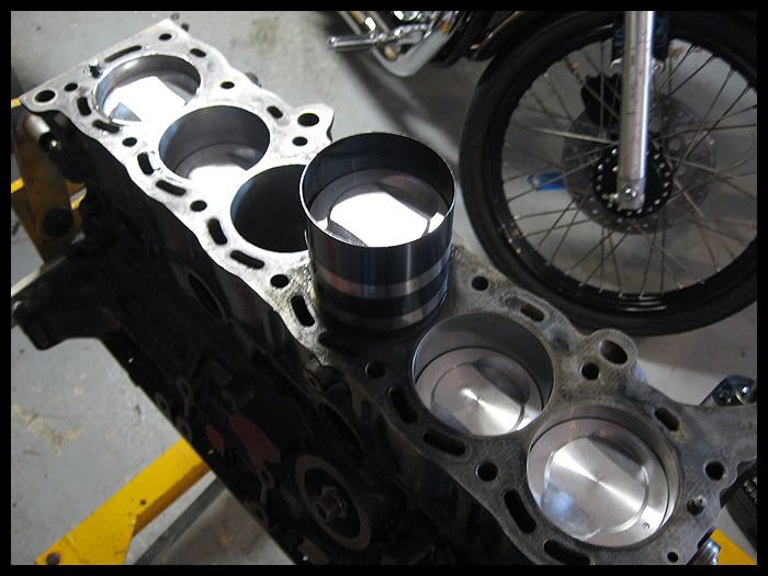

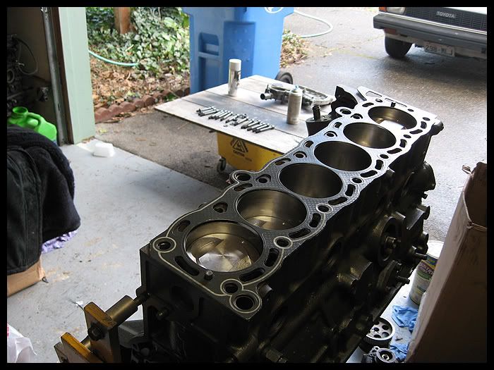

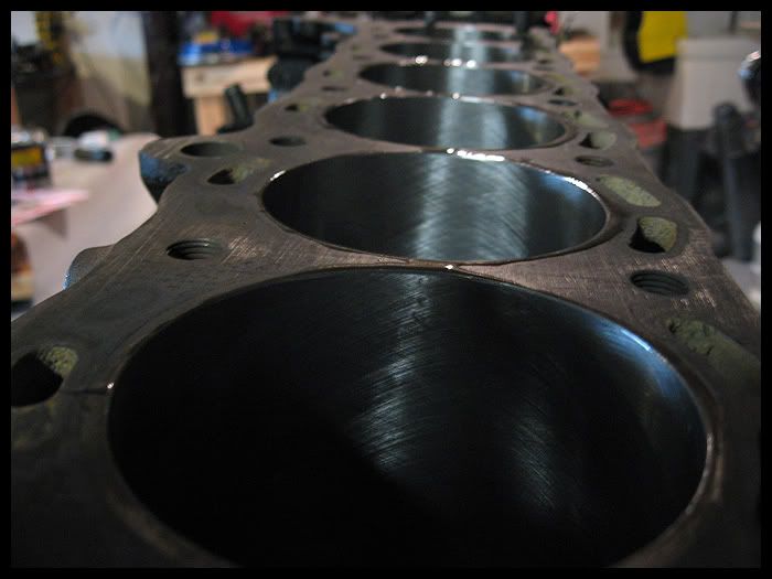

.030" over, high compression piston bling

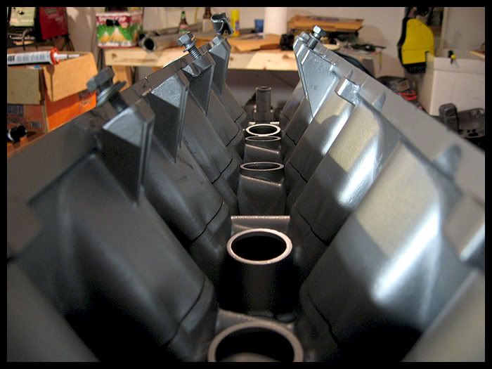

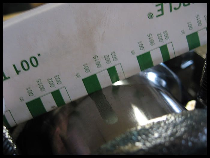

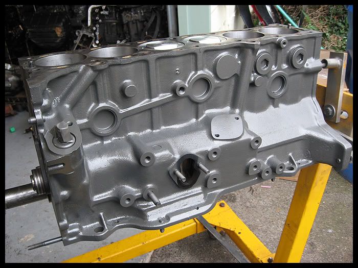

plastigaugin fun (bleh)
Black block no no, grey block easier to spot leakage

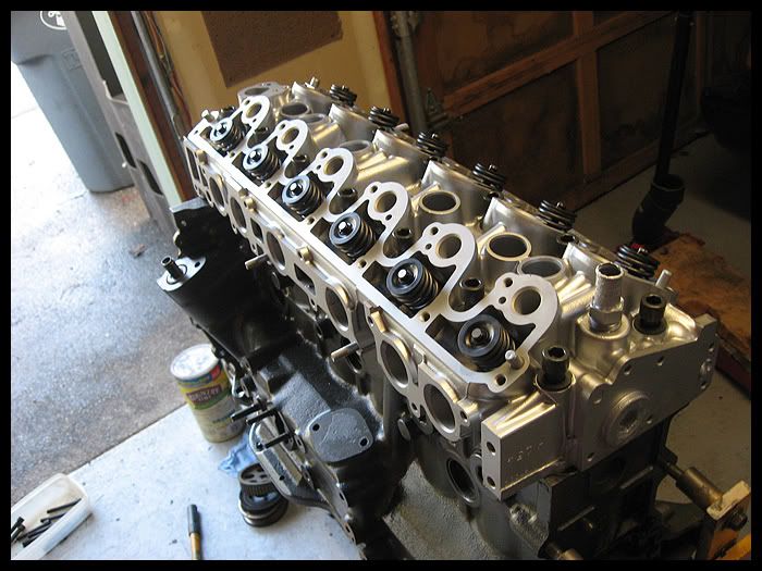

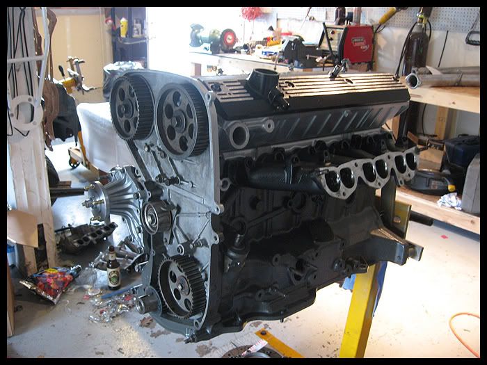

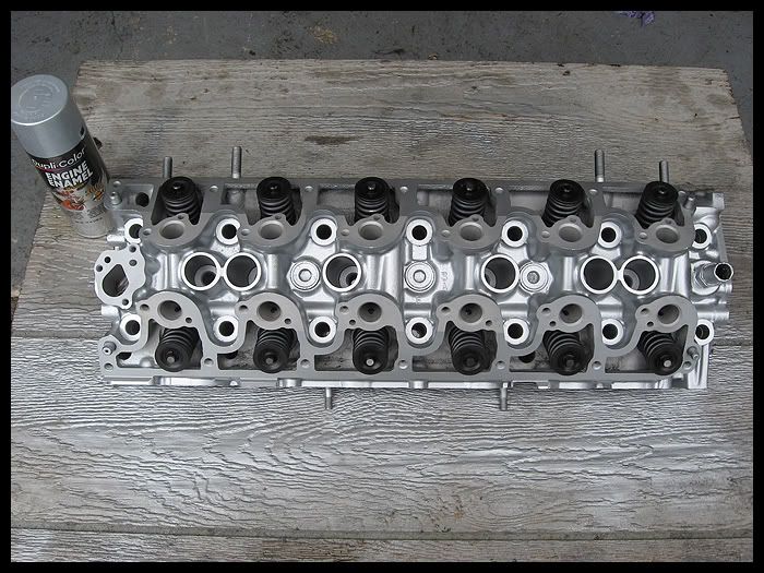

Painting the head (which got a valve job and was milled .005")

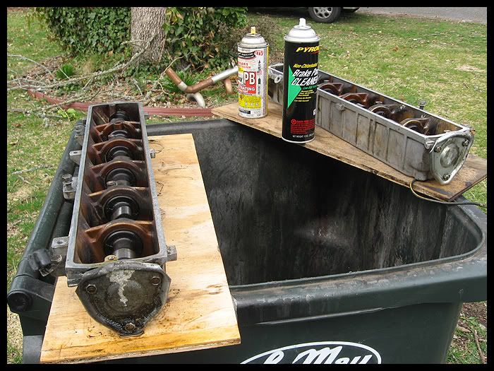

Time to clean & paint nasty cam towers

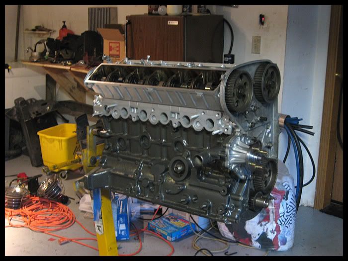

Tada!

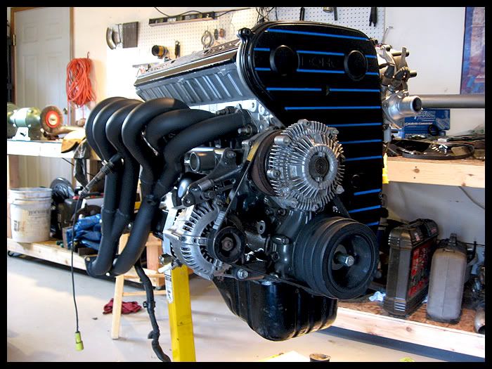

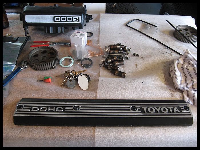

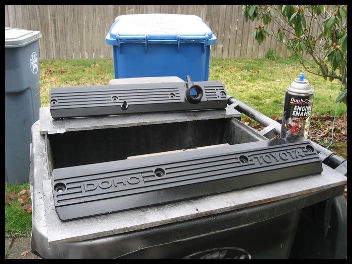

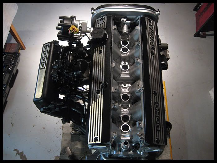

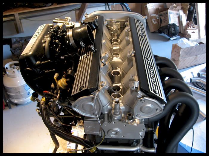

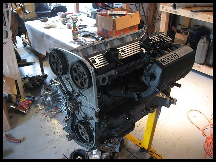

Valve cover's turn

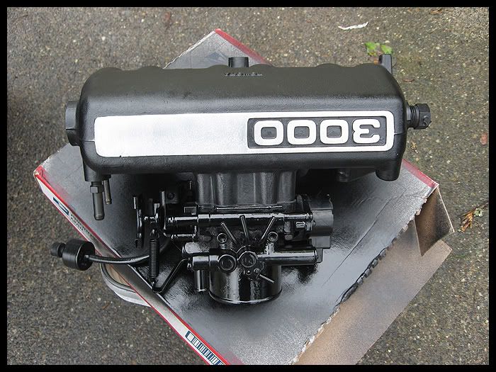

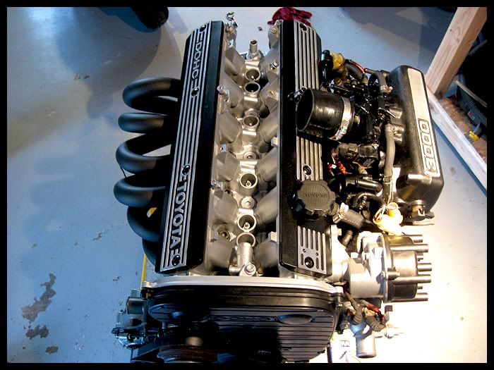

Sexy 6M intake

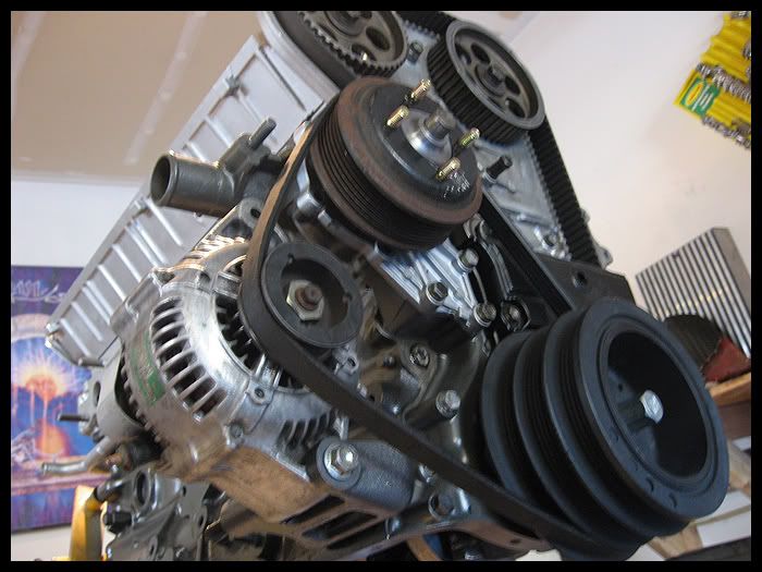

Test fitting belt to the 7MGE crank pulley, 7M alternator and 5M waterpump pulley setup

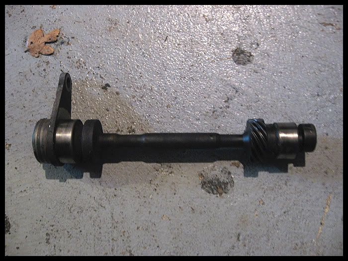

Oh, found out the hard way why you cannot use the 5M oil pump driveshaft in a 3.0 setup, DOH
6M/7M driveshaft is thinner and notched out for #1 and #2 con rods

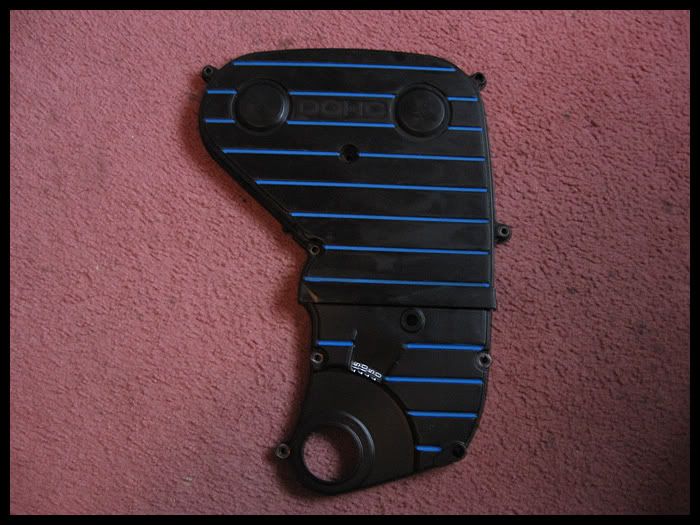

Timing belt cover fun
Sexy?

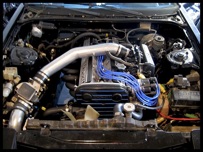

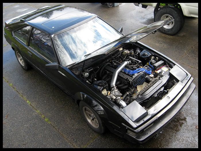

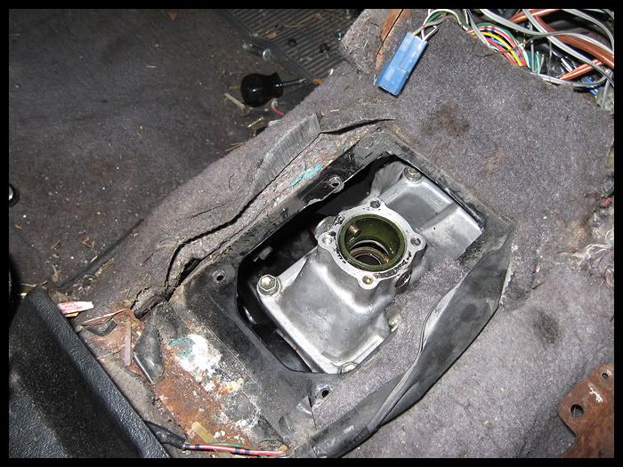

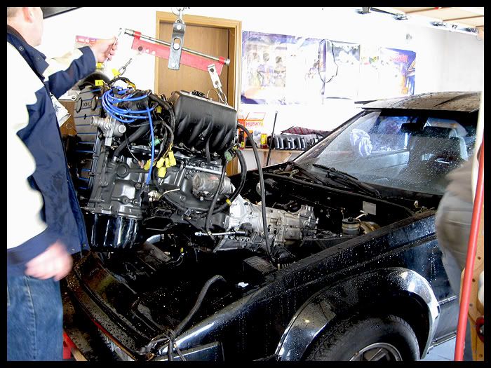

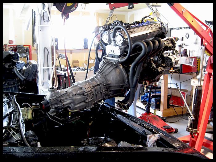

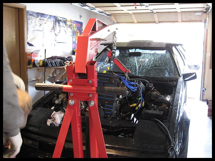

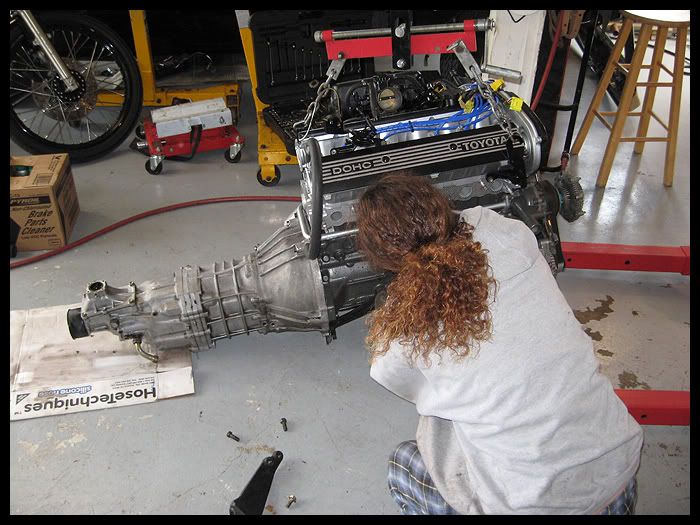

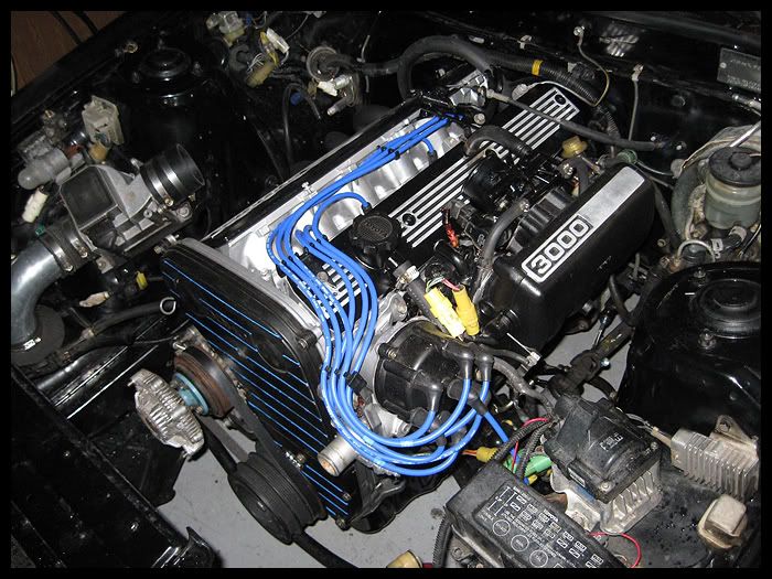

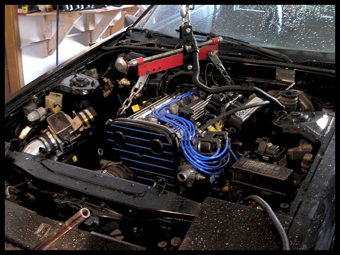

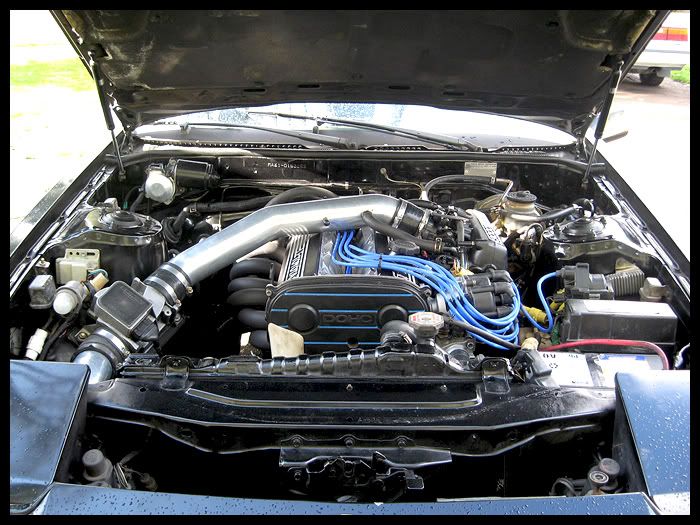

Ohh look, time to go in the car now...

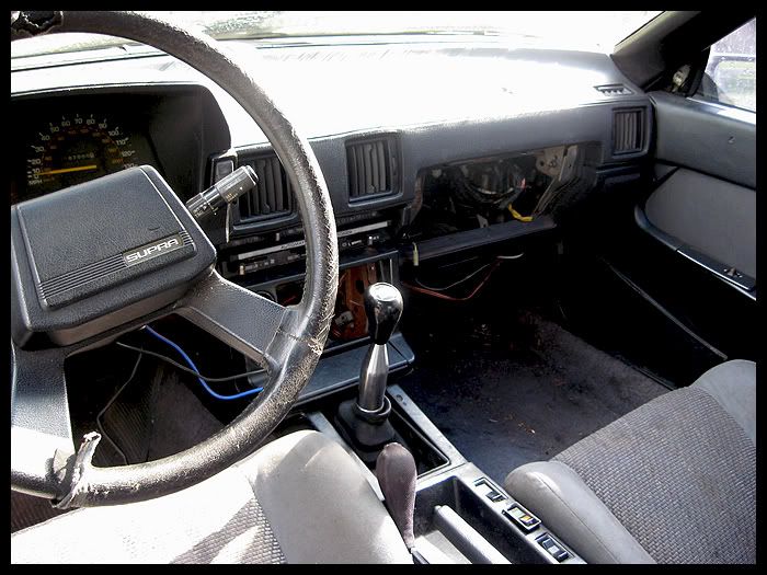

What's that? 5 speed swap you say?

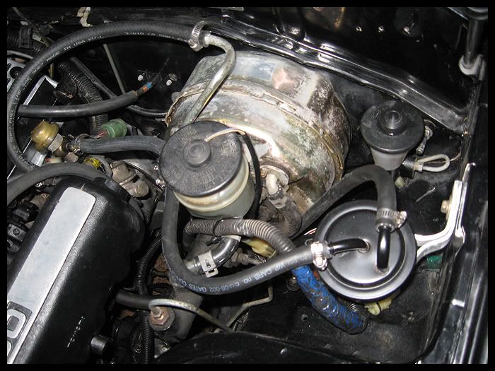

Fuel filter relocation FTW

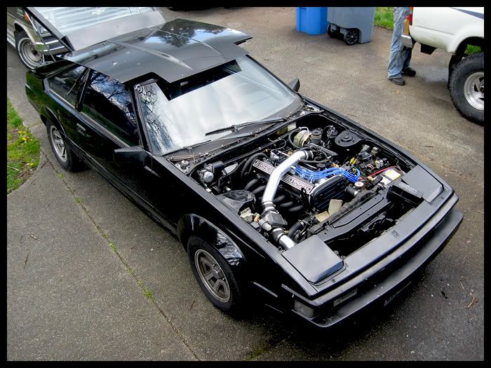

Happy Supra!
Can't wait to finish breaking it in so I can dyno her :D
So far I am into the car for UNDER $1,500. The car itself was free. :love:

Removing the heater core and the rest of the useless crap under the dash (vents).
As of right now there is no power steering, no a/c, no cruise control, no egr, no washer fluid tank. Weight savings ftw :D

Yeah she's been running since 4/20. Did the big mk2 Supra Kirkland, WA meet yesterday... put on 240 miles, so total now is around 300+ miles (speedo stopped working when we did the 5spd swap)
