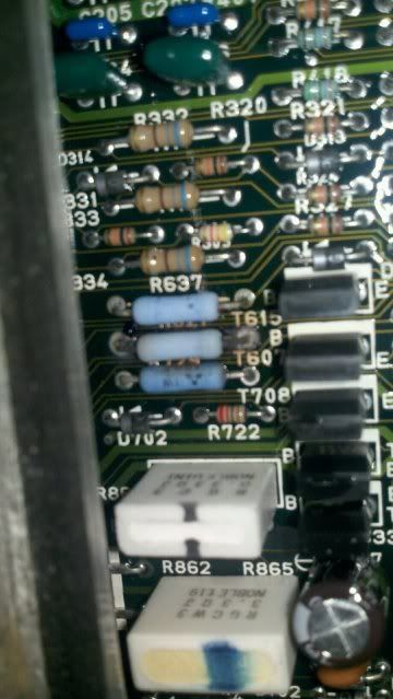

MKIIISupraGuy;1782164 said:
Solid blue is going to be another capacitor. Resistors are cream colored, with the various colored bands. The cream color is the base color as to better show the different colored bands. Post a pic of it up and I will tell you what it is. If it is what I think, you can get another capacitor and solder it in
Sent from my DROID X2 using Tapatalk
ya i thought resistors were cream with the bands, but this one looks EXACTLY like one, just one solid color and bigger. heres a pic:
Its the top 2 that are burnt.

MKIIISupraGuy
Sep 14, 2009
639
Lousy-ana
OK the 3 little blue guys you talked about are precision resistors. They exact the required voltage needed for a particular circuit. The one in the middle is completely toast, and the other 2 look marginal. I would replace all 3 and solder in new ones. I am going to trace the schematic for you and see if I can verify what part of the engine they control.
