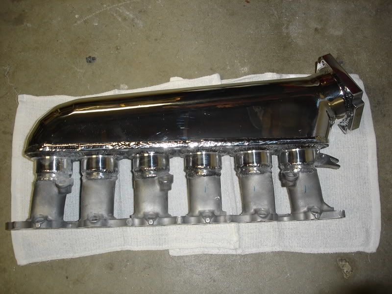

It is cheaper to go NA-T 2JZ because money saved in the initial engine cost is put towards performance parts that you would ultimately buy for the GTE. Standalone is the only way to go when building a high horsepower street car and would be needed for either engine when making big power.
I build IC pipe kits for less than half of that price and thats aluminum pipes tig welded,bead rolled with all clamps and couplers. Here is the 2JZGE manifold that I make. pricing is competitive with the other manifolds out there.
