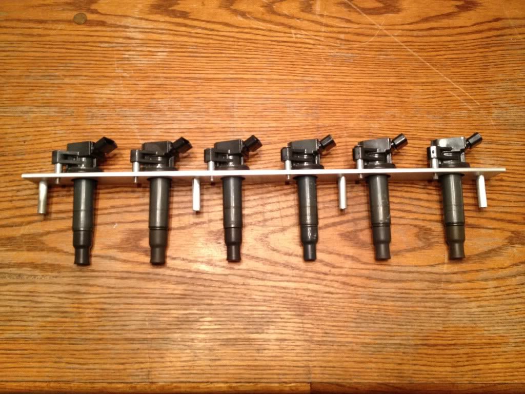

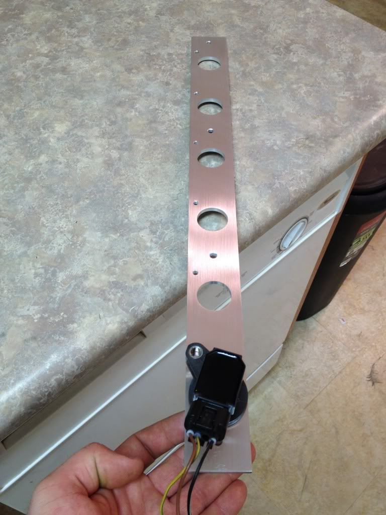

Install 1ZZ-FE coils - Check!
Throttle linkage delete - Check!

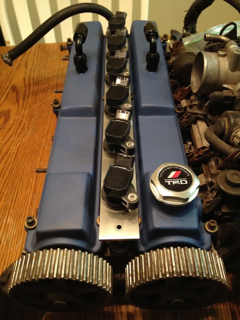

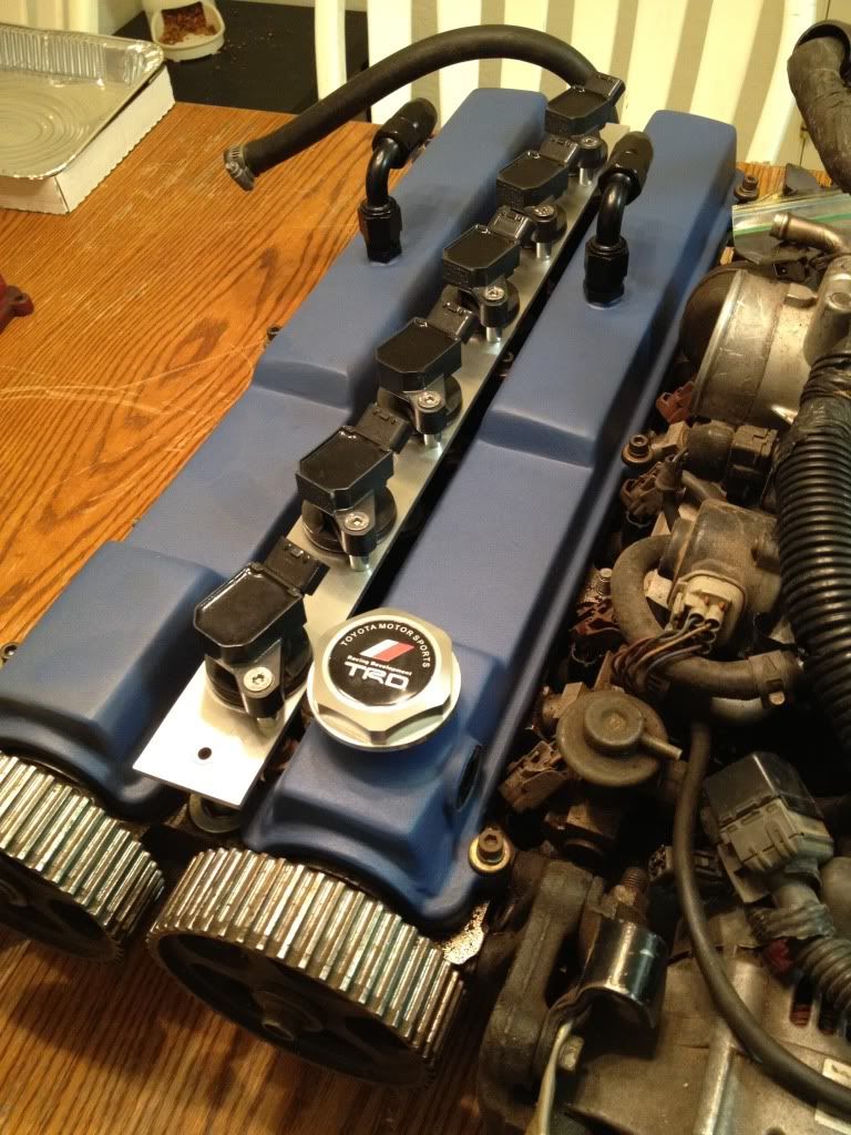

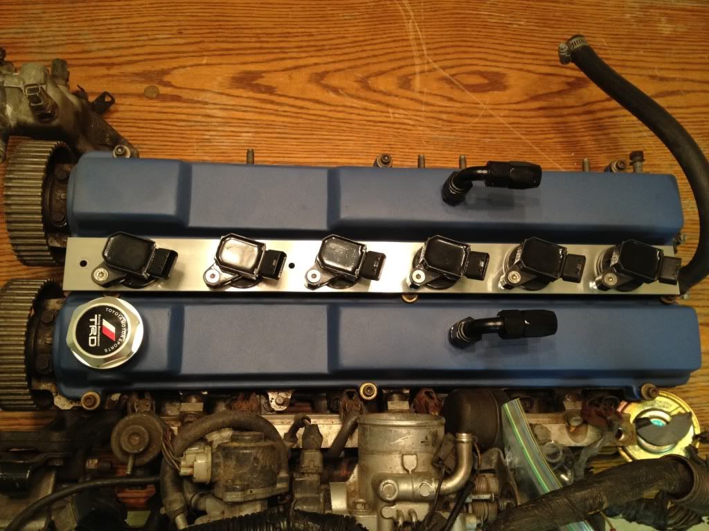

I still need to run the wires for the coils but the are in place
I was lucky with the IC-TB pipe, I have about 2-3mm clearence to the coils. I had really good luck with my IAT, it sits very nicely between a coil, IC-TB pipe and PCV outlet on the intake valve cover
