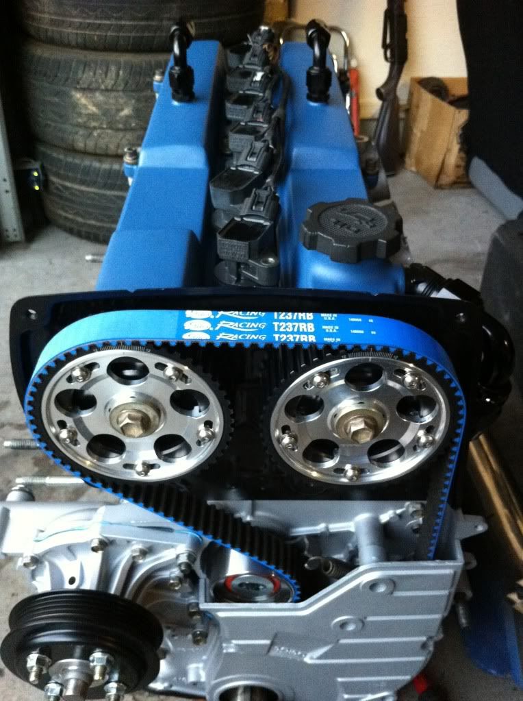

I did these on stevens Setup:

that looks good and they are not too funky looking. but i wonder if it would clear the stock throttle linkage that sits above number 5 spark plug becuase im still running the stock intake manifold. do you have any pics at an angle horizontal to the valve covers?

At the rate that build is going, the stock manifold will likely be ditched in favor of a larger plenum volume one (ffim, my guess).

Not to sure about the stock linkage. What I did on my old 7m is make a bracket that held the throttle linkage underneath the plenum, coming up from behind, flipped the throttle plate 180 degrees, and got rid of the linkage shit that goes on the valve covers..

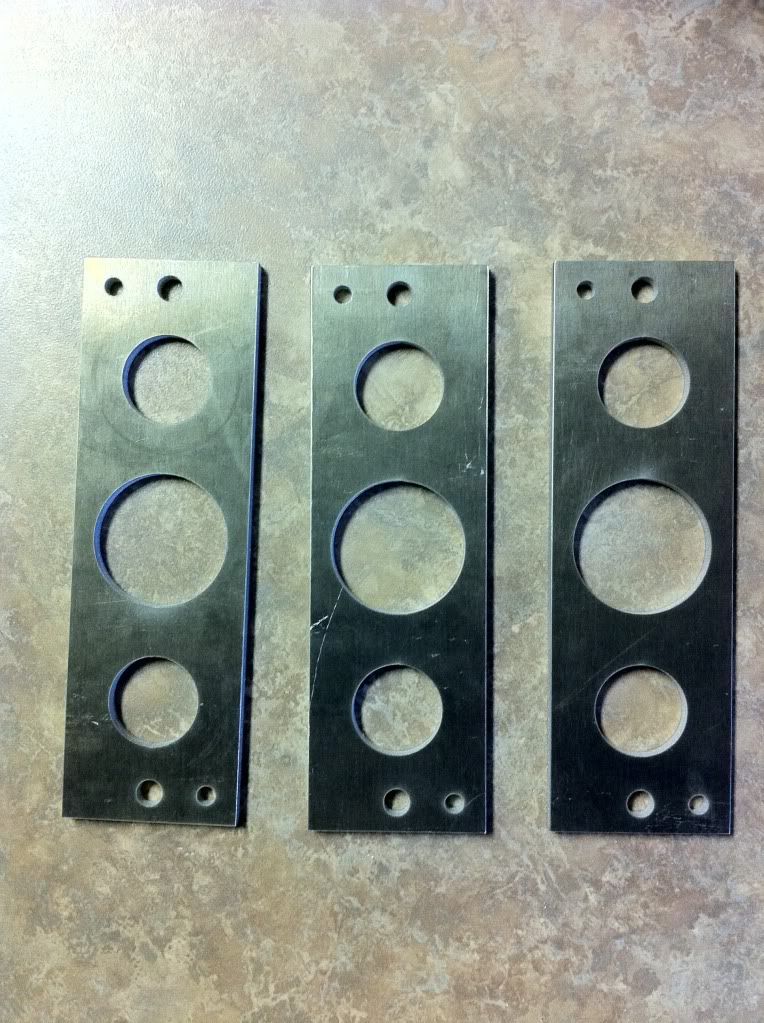

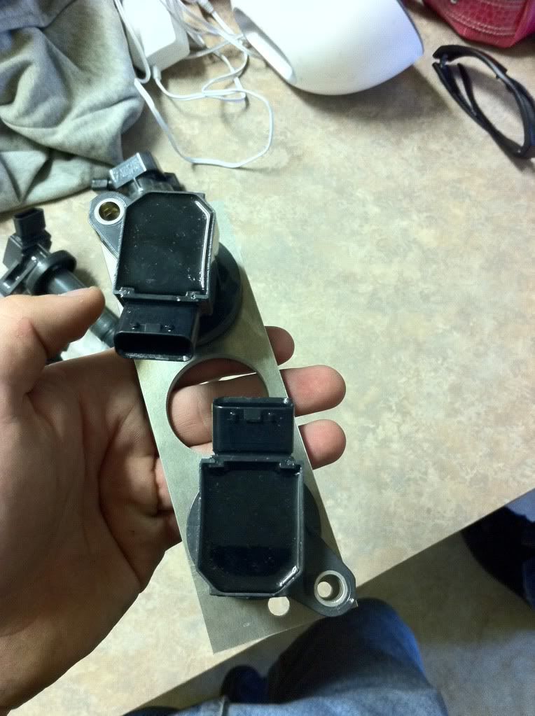

THese are the 1zz brackets I made for my car. I have like 150 brackets left over =]
---------- Post added at 07:51 AM ---------- Previous post was at 07:50 AM ----------
Gonna start on making 7mgte brackets and ill get 150 pumped out too

Those are sick! id be interested in buying one if i go with these coils. about the linkage i still use the cruise control so if it doesnt fit im going to have to find a way to retain both cruise control and pedal cables. not to hard i dont think. but i like these alot
