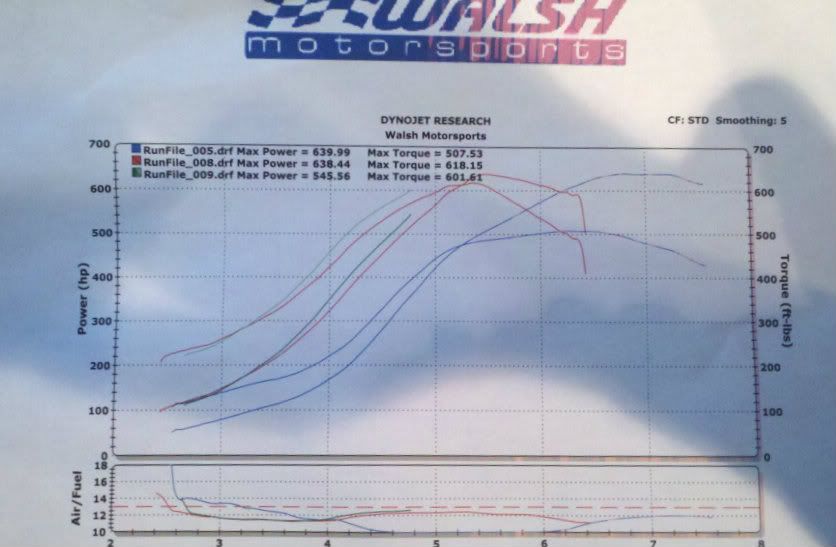

So...not completely satisfied with the numbers, but it is what it is. Final pull was at 18psi (red on the printout above). 638rwhp 618rwtq. It has a solid 800rwhp in it but anything over 18psi and it was blowing out spark. I guess for what it is the 100% stock ignition system ain't that bad afterall! lol! FYI - The blue lines are from my past 1jz setup with BC 264 cams and a T78.
A couple things I noticed...this engine is in DIRE need of upgraded cams - MUCH more so than and stock JZ cams. And the ignition system just doesn't have enough umph to get the job done above this power/boost level as plugs are already gapped way down and every component is brand new.

What's the plan for the ignition? MSD stuff or going with a smart coil setup?
Can't argue with those numbers at all and that motor, with it's internals, is probably barely breaking a sweat getting there. You tuned it yourself?

Yeah, I build and tune for a living. :evil2:
As for ignition, plans are to get a nice COP setup. Honestly I wanted to test the limits of the stock ignition system - guess I found it.
