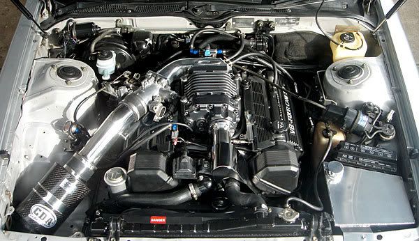

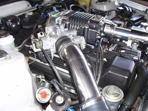

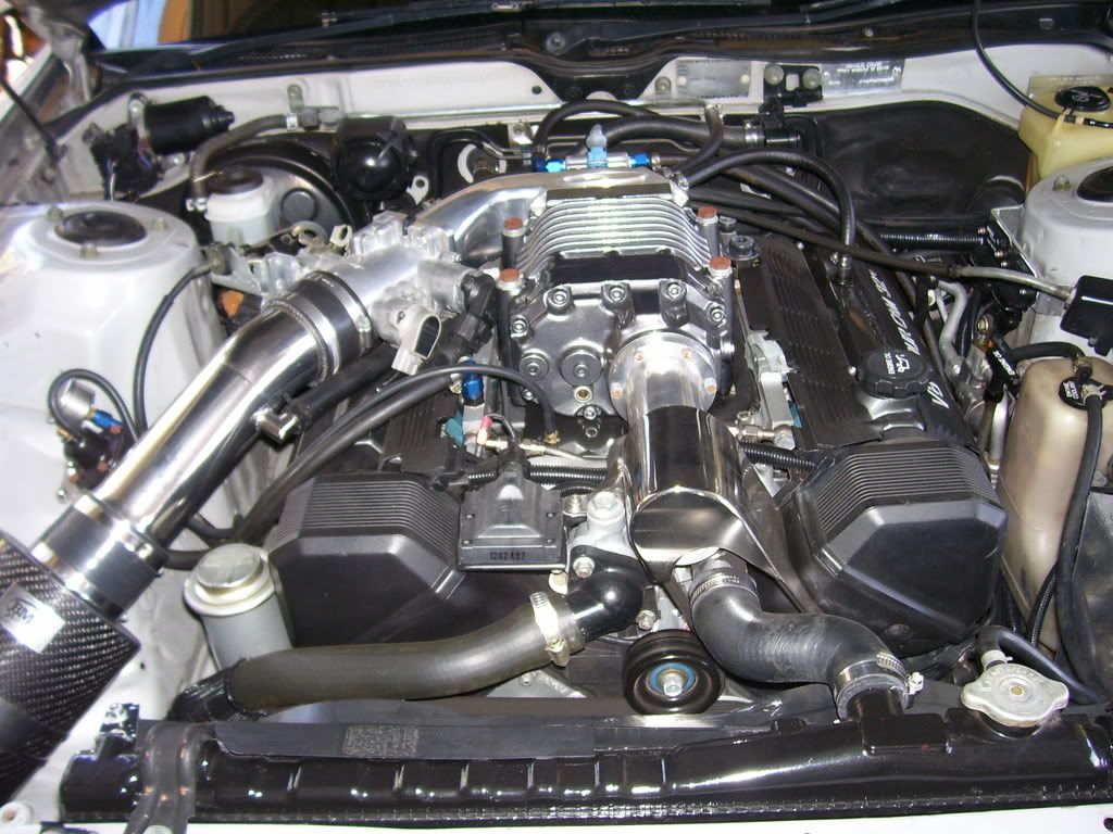

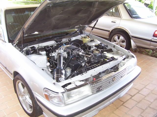

Supercharging is a good path to take with forced induction. A few photos of my supercharged 1uz - fe Toyoyta Cressida
Here it is removing some rubber from the rear Pirrelli Dragons.
Up with the bonnet and voila!!! Surprise surprise.
The top of the supercharger.
Eaton M90 Supercharger from RHS front quarter.
Motor from the front
There is absolutely no other V8 that sounds better than a 1uz...
easylift
2 Cressidas
Mar 22, 2009
15
Gold Coast
In answer to your question in the pm, the intake charge is water cooled. The tank in the position where the battery normally sit is filled with water, which is pumped to the blue fitting at the back of the supercharger and cools the intake charge.
