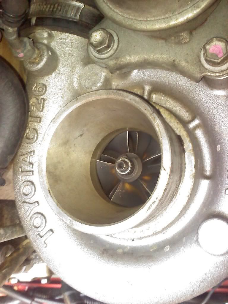

So you think the turbo is ok ?... I am worried because there is a awful lot of oil/black junk in the intake manifold. My neighbor who is a mechanic, says the seals in the turbo are most likely bad.

All of the tests I asked you to do point that the Turbo is ok and that it's just blowby gunking up the Intake.
Grab hold of the Compressor wheel and check for up/down/in/out play.
MKIIISupraGuy
Sep 14, 2009
639
Lousy-ana
The compressor wheel feels really solid, no play in or out, and no suspicious wiggling of any sort....and spins freely with no noise.
thnx Kevin, I do feel a little overwhelmed.

and your turbo sounds to be ok then. a tiny bit of side to side shaft play is normal

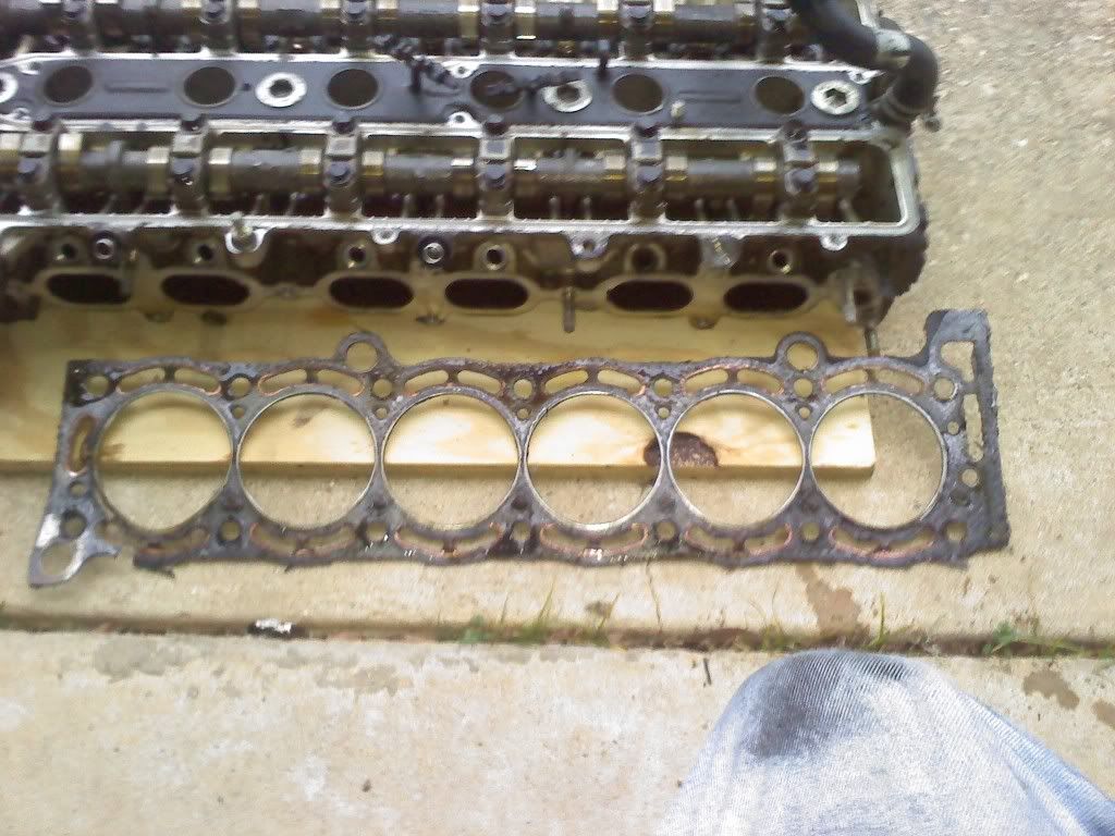

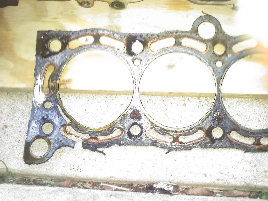

Worked all day getting the head off, to no surprise the headgasket looked horrible. Re-assembly commences tomorrow after I get some rest. Here is a couple pics :

Yup looks like a bhg! Make sure you get all the old gasket material off the block and head, check both for warpage and make sure you don't get any of the old pieces of gasket down into any of the oil holes in the block or into the cylinder bores. Its a good idea to put some rags in the bores when you do your scraping so junk doesn't get between the piston and rings.

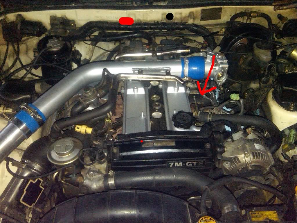

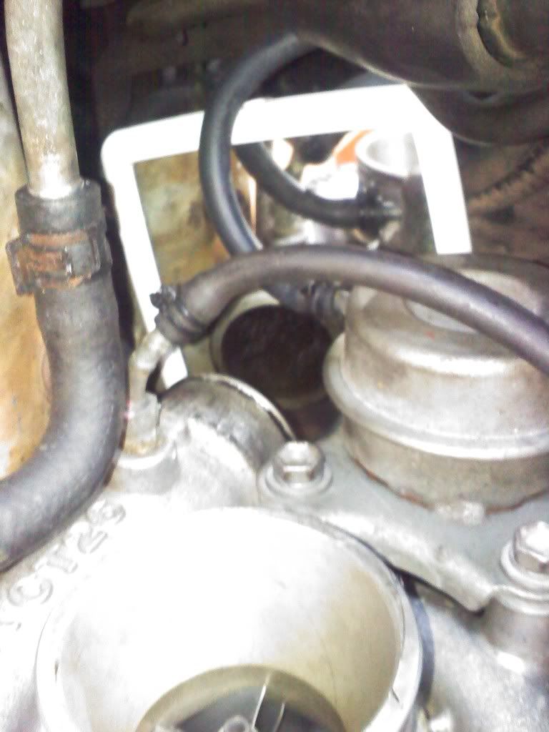

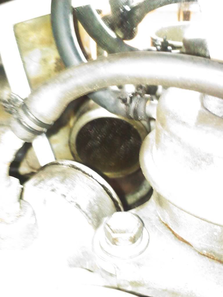

Well the engine is mostly back together, with only 2 things holding me up. I'm sure somebody knows where this fitting goes, and the where the hose ends connect up at. Also the little harness in the pic, I'm stuck on that one too.
bennza
Jul 29, 2008
Houston
I could be wrong but I'm thinking its the vacuum line for the bov. bolts to the the lower intake manifold. Good luck!

OK well I'll get the pvc hard lines put back in and connect the hoses, and then I should see that one where it needs to be connected. I still need to know where the little harness in that pic goes, the one with the red wires. I can't wait to fire her back up and see how she runs !!!
