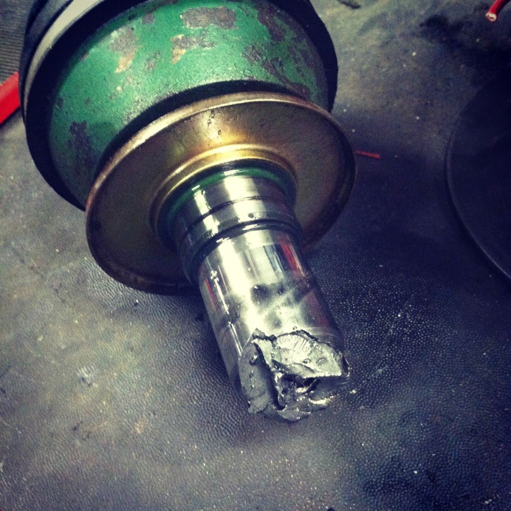

well, broke another axle, same side.. decided to swap rear ends this time and see if that helps, so far so good.. currently looking for an upgrade..

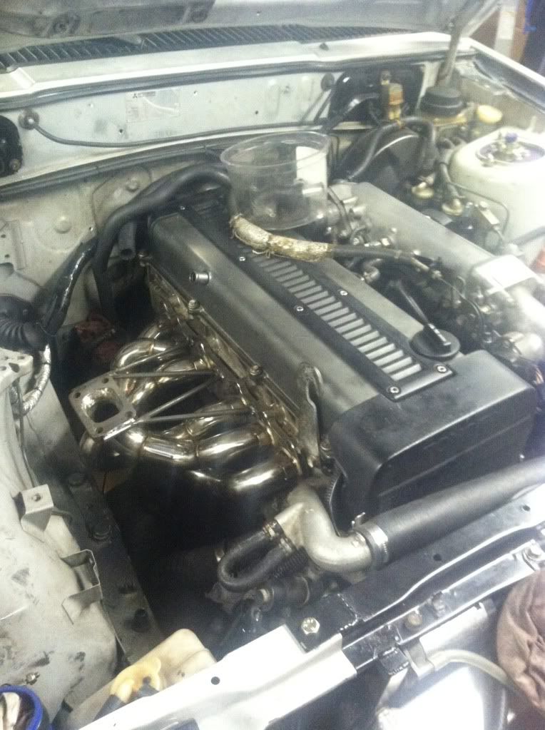

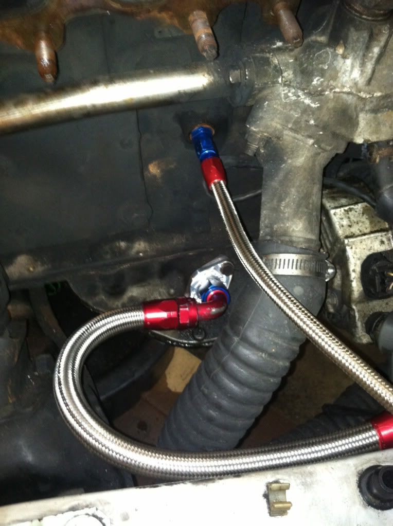

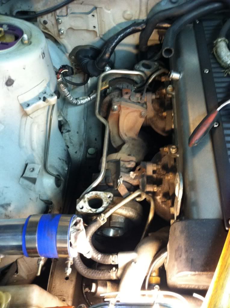

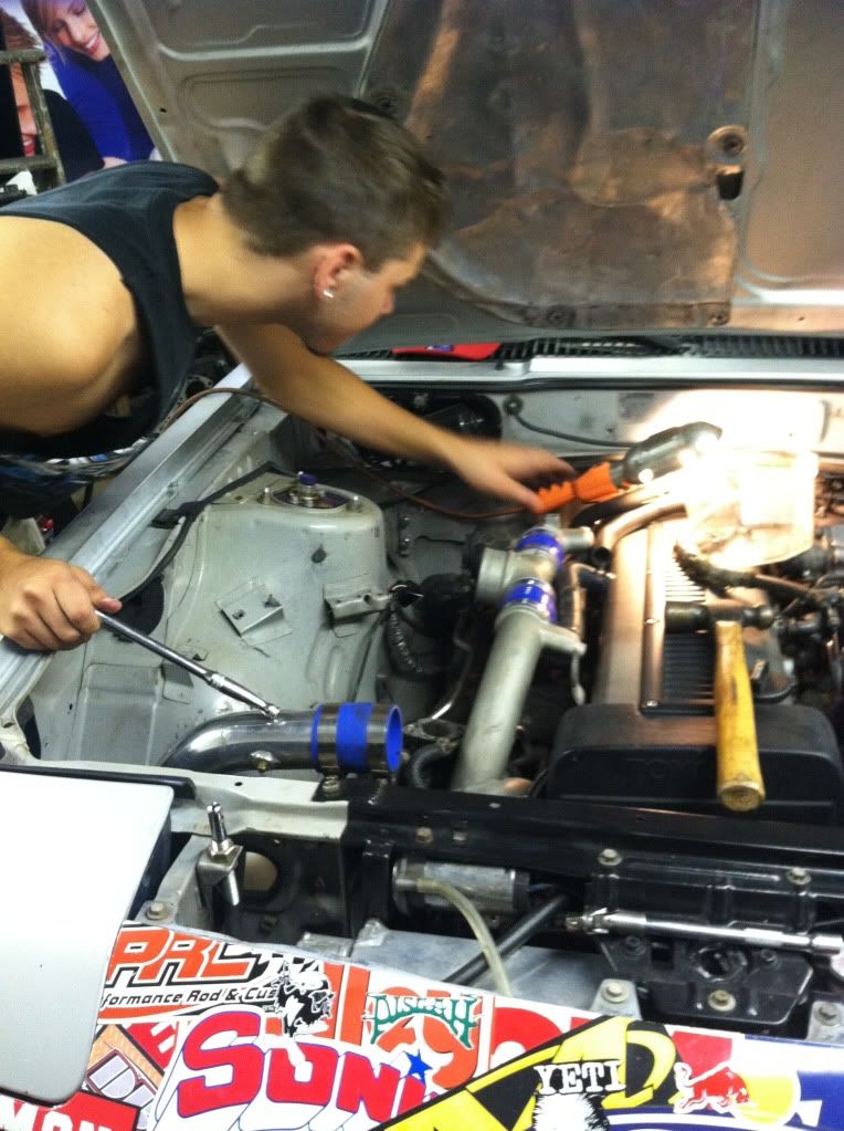

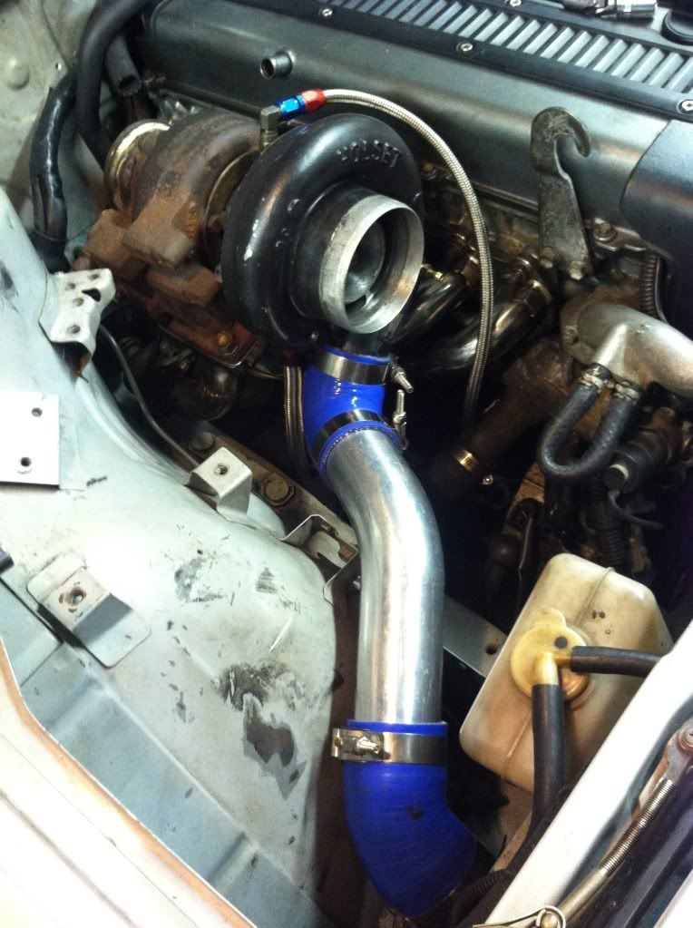

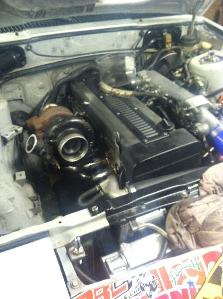

Finally got around to installing my holset.. i freakin love this car! this engine is so amazing.....
tried to teach my little brother a little bit about cars..

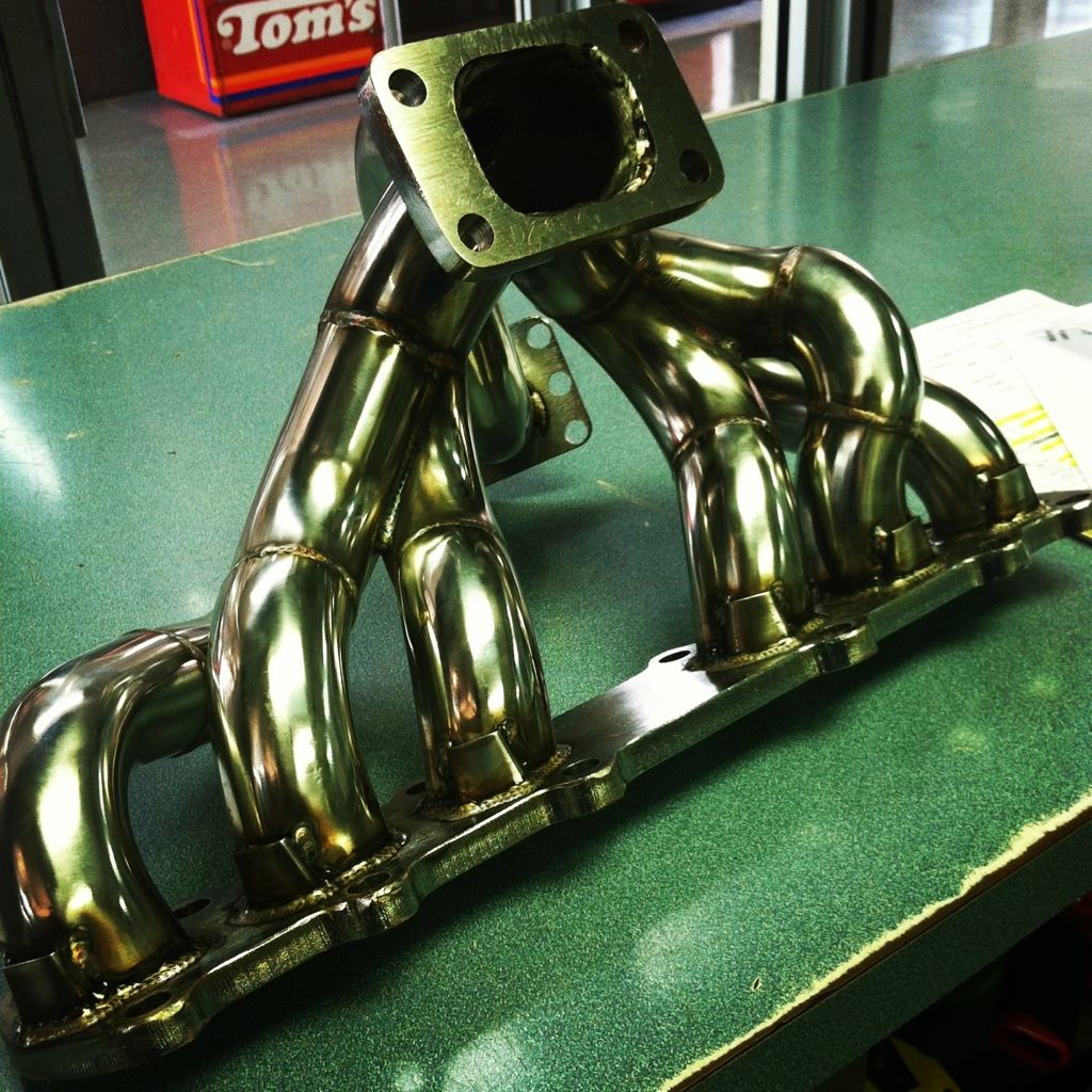

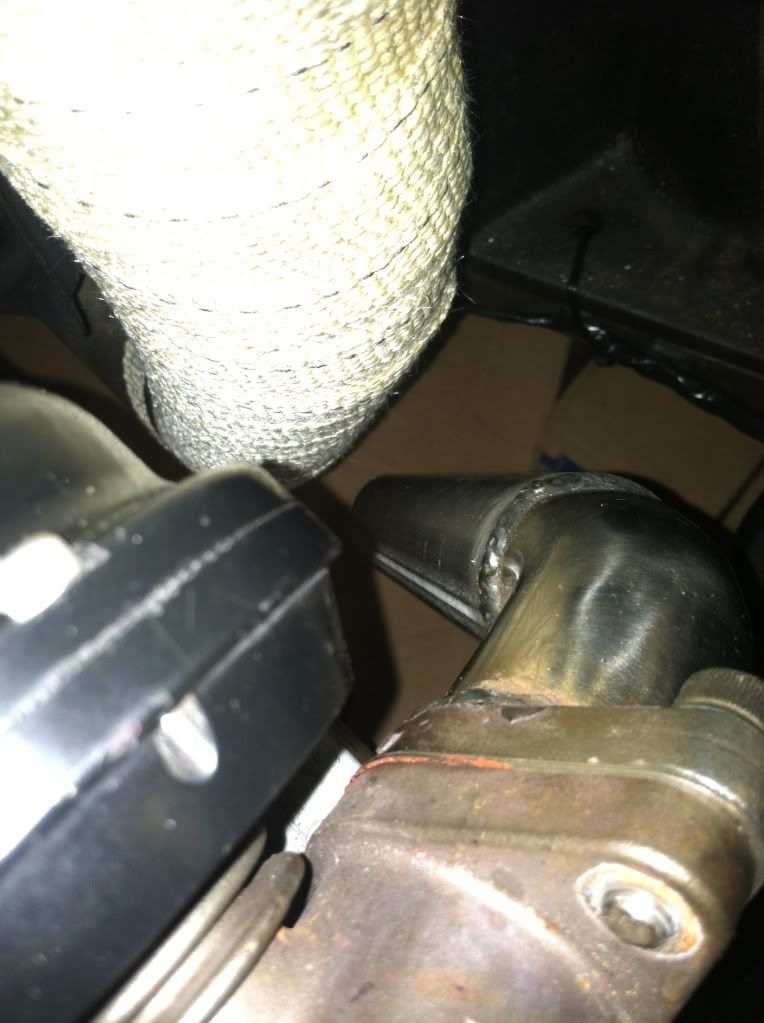

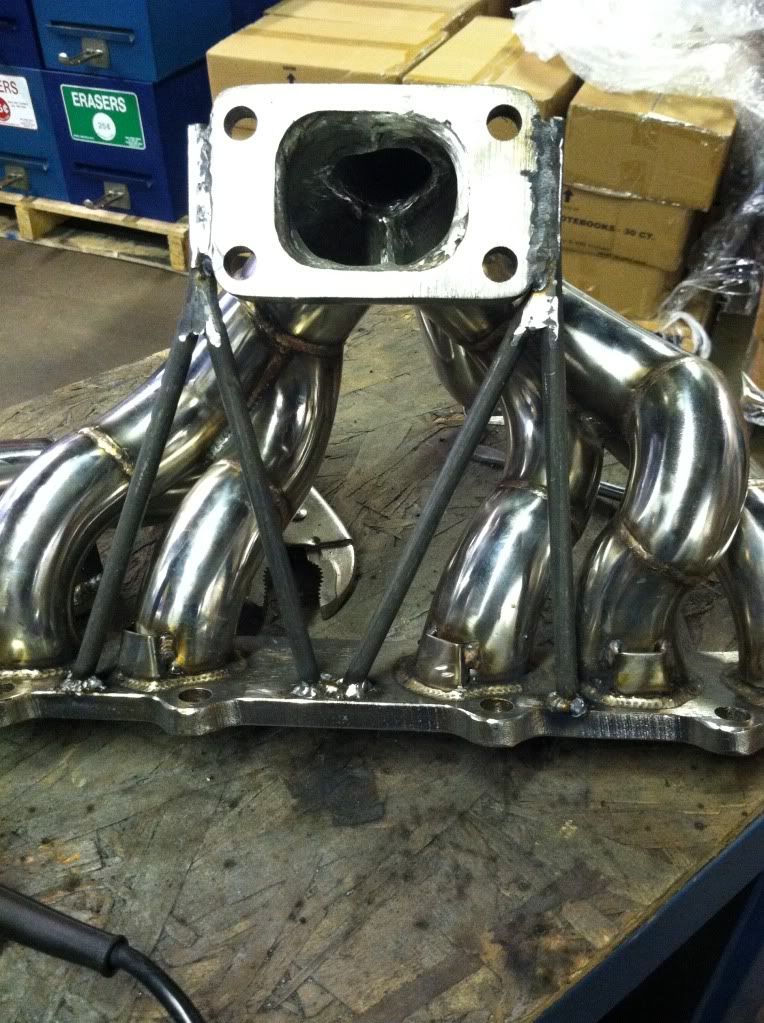

braced up the xs power manifold, i know its cheap but so far its held up great

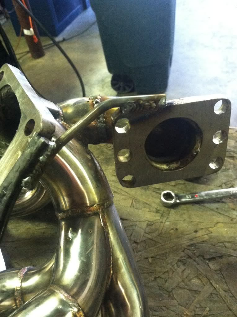

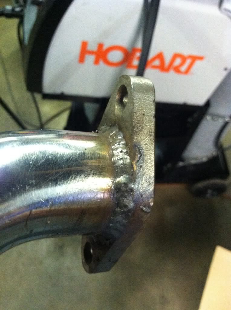

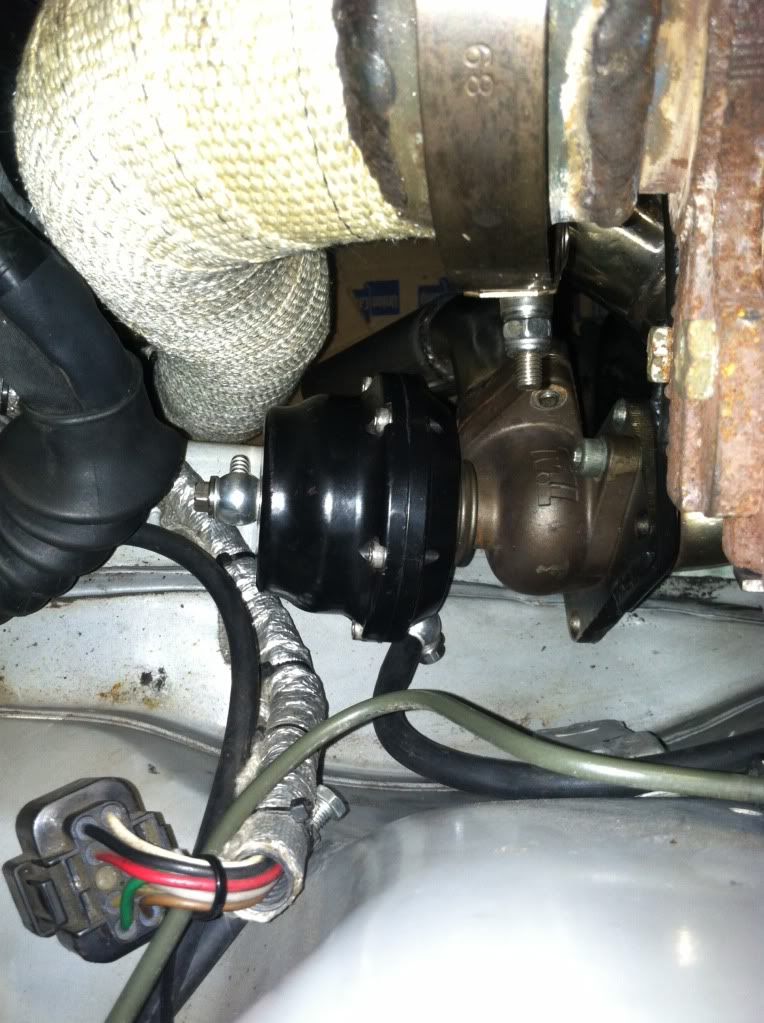

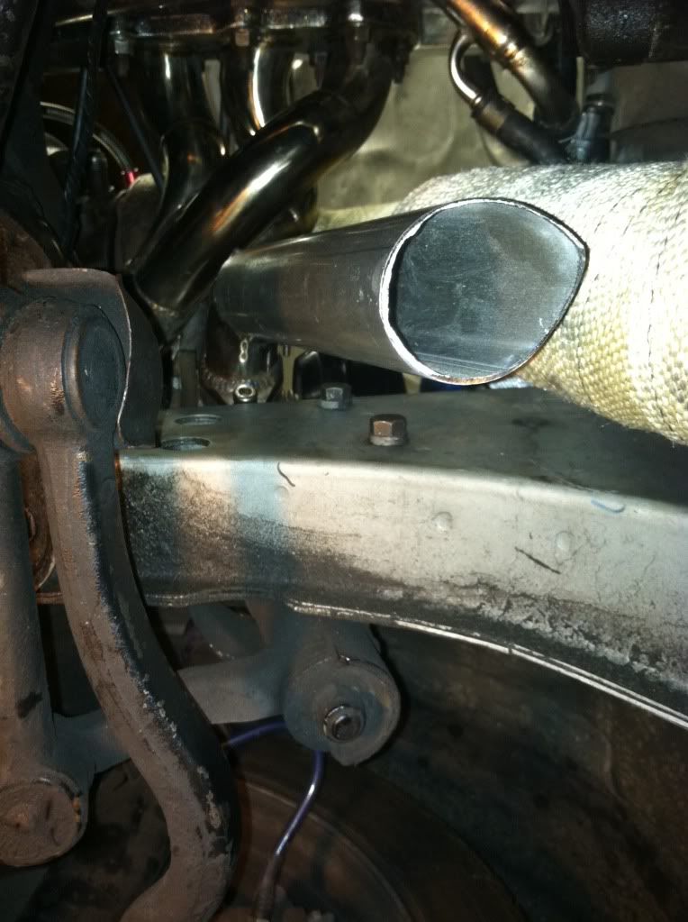

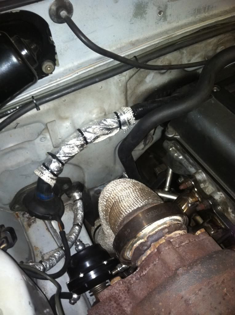

had to rework the wastegate flange, and braced it as well

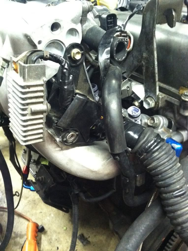

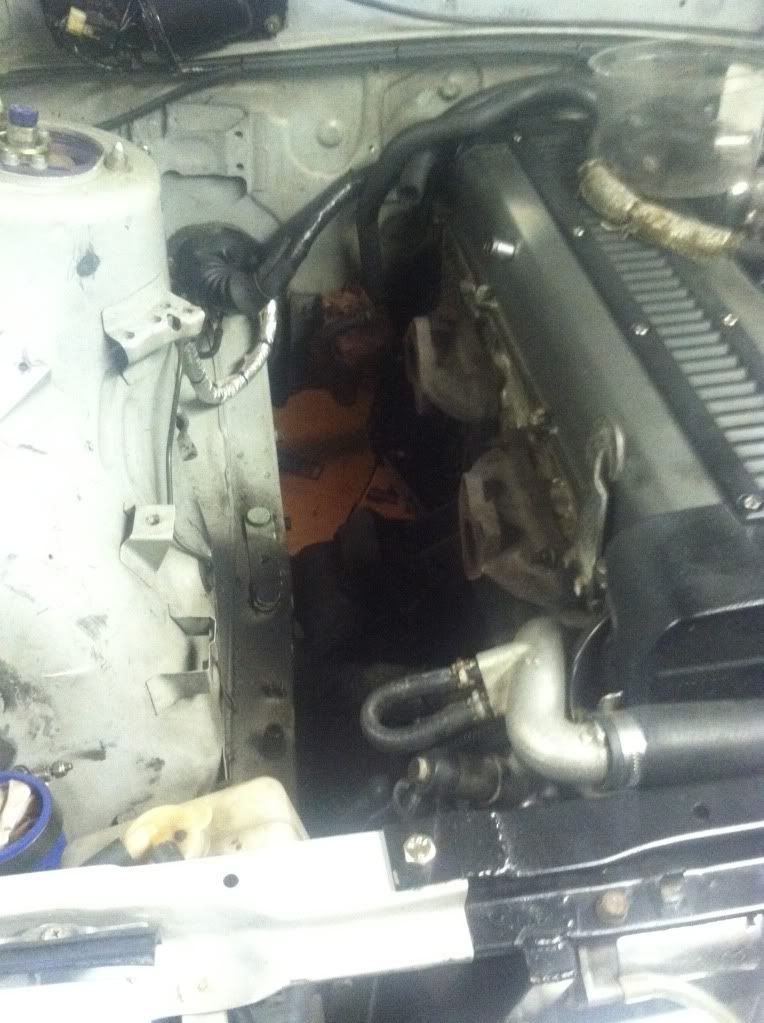

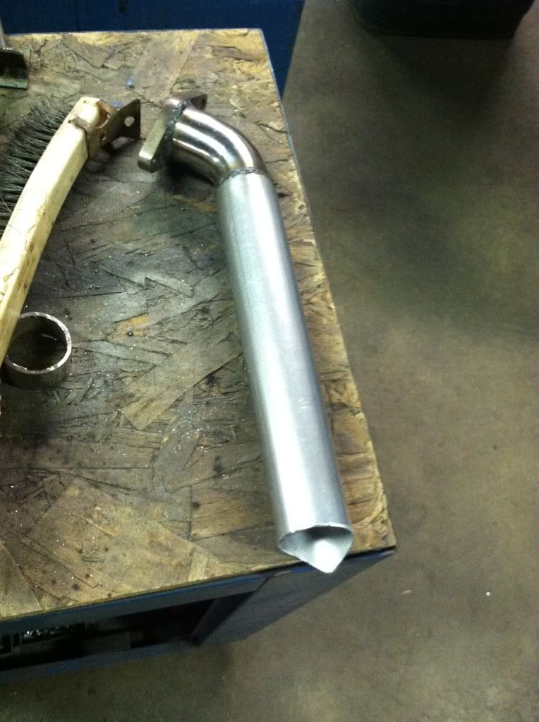

had to get a new battery, and build a dump tube..

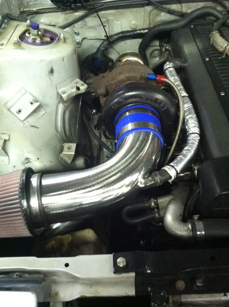

spent the day cleaning up the intake pipe for the turbo, and welded a nipple to connect the valve cover hose back.. I used a 120 grit sanding disc on the angle grinder, then cleared the piss out of it.. love the way it turned out
tried to help protect the wiring harness as well..

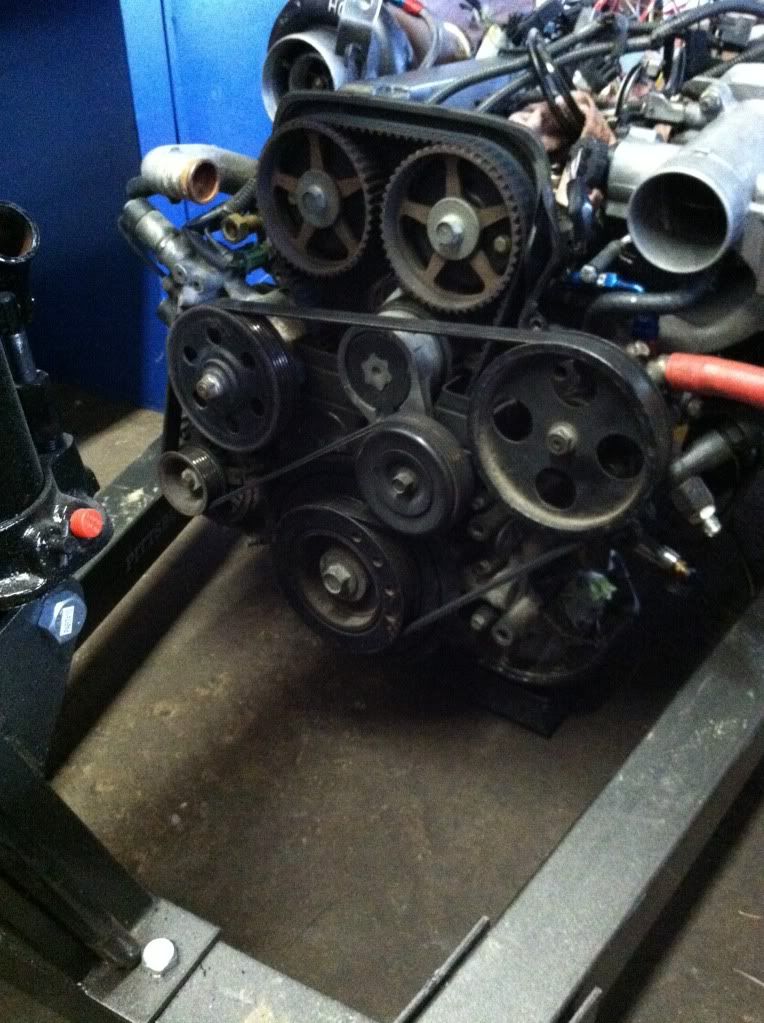

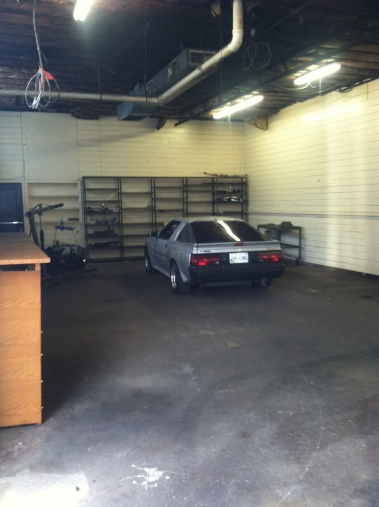

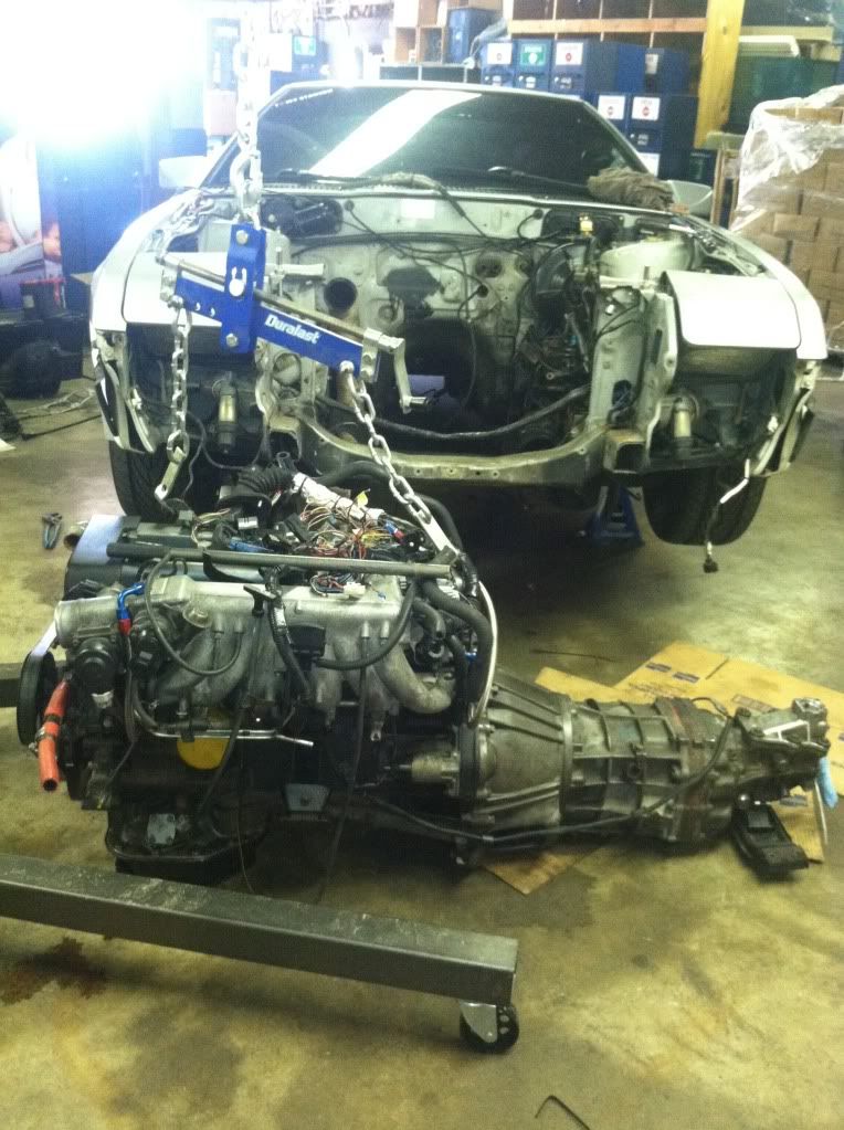

Well i had to pull my transmission and send it off the marlin crawler for a rebuild. so in the mean time i decided to clean some things up and moved the ole girl to a new home..
Engine and tranny out
Moved her over to her new home

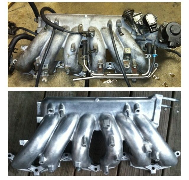

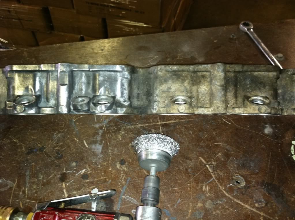

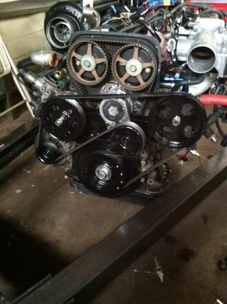

Started the cleaning process. Hours and hours cleaning the upper and lower intake.

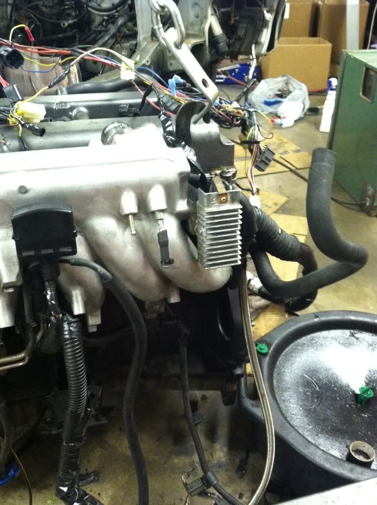

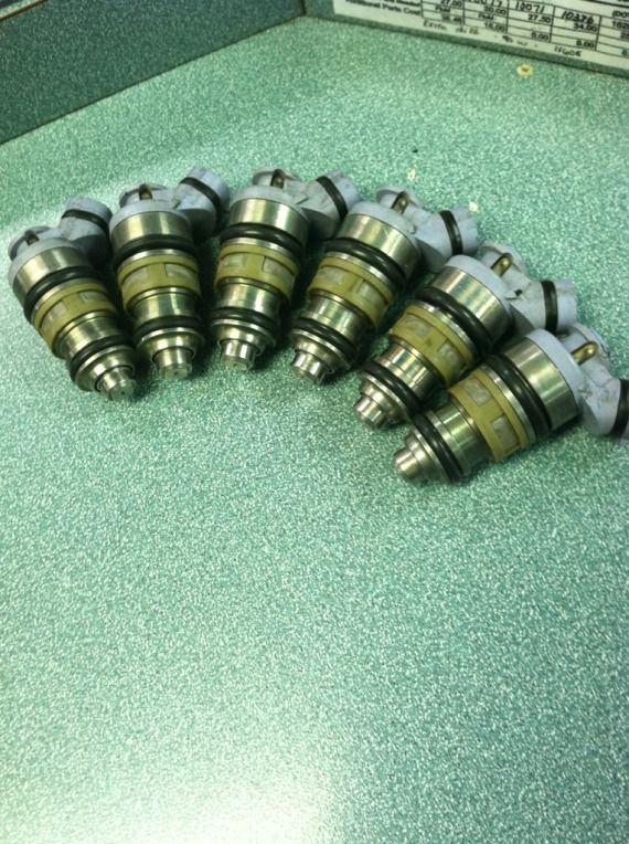

Installed my 550cc injectors, got the wired up, and installed my resistor from a 7m

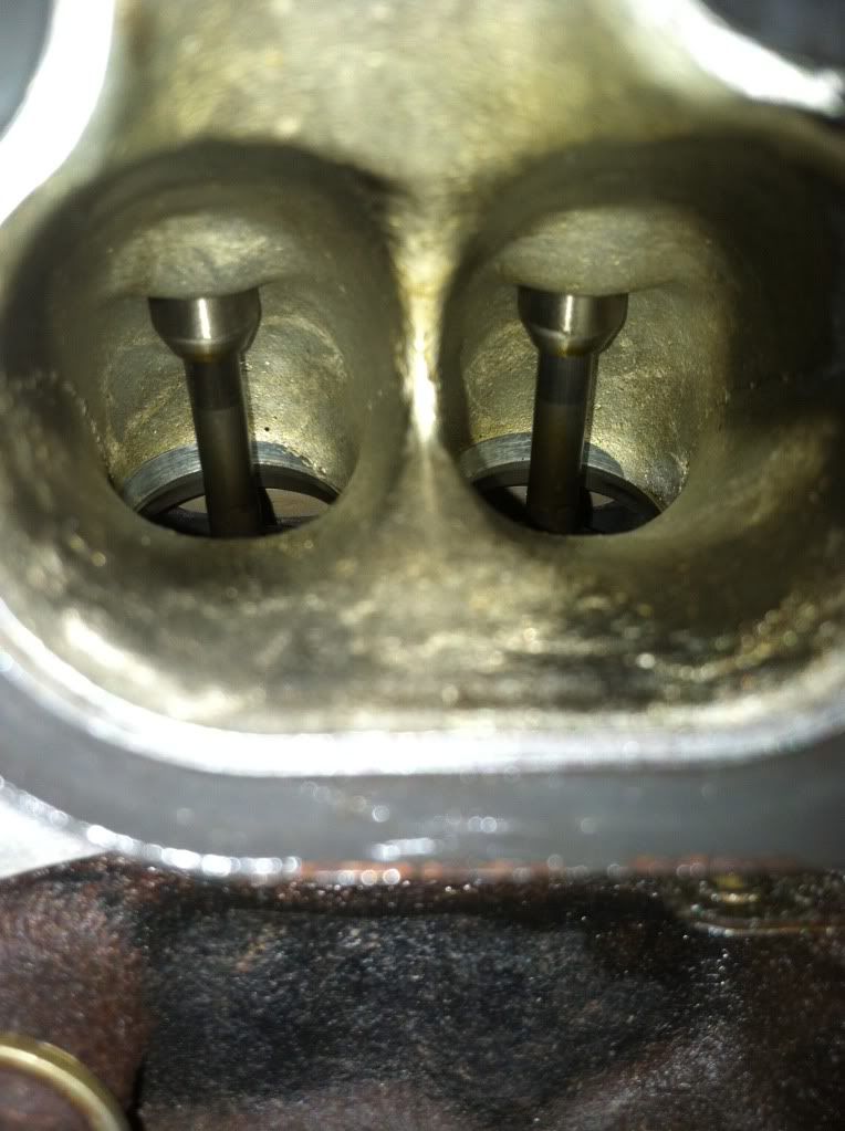

I was pleased to see how clean things looked inside the engine
Then i moved around to the front of the engine and began working
