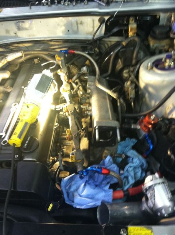

my fuel rail leaked at the ends, had to fix that.. holy shit, i thought i was going to break the fittings before they stopped leaking..

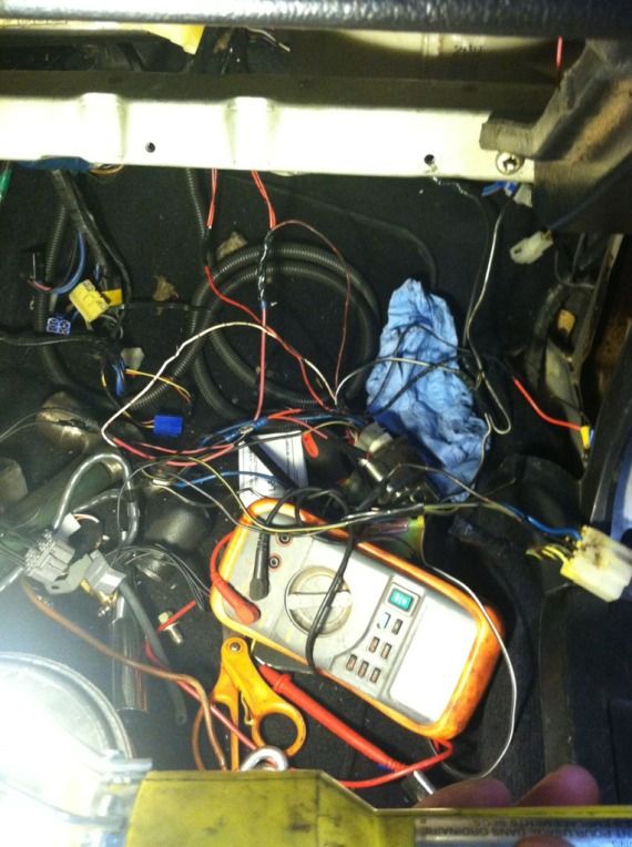

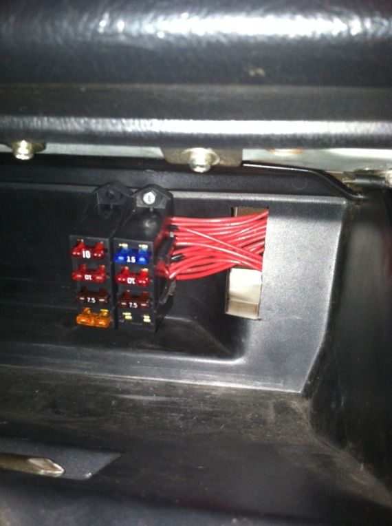

had fun with this little wiring mess, but it all works like a charm now!

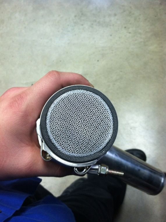

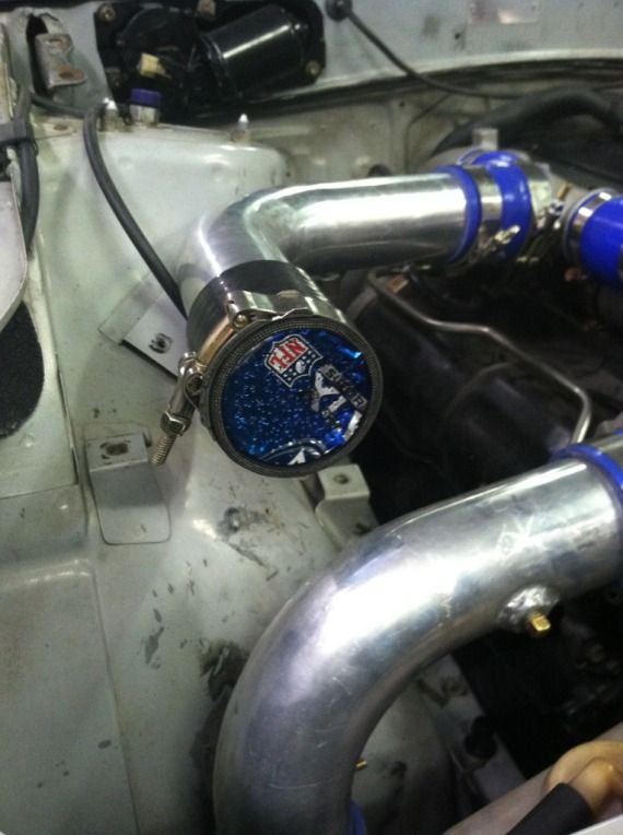

Late night start up, needed a test drive and had no air filter, make shift beer can filter! haha

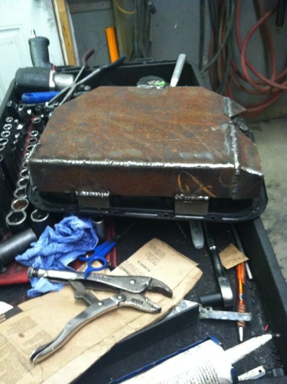

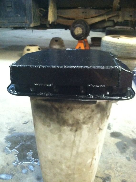

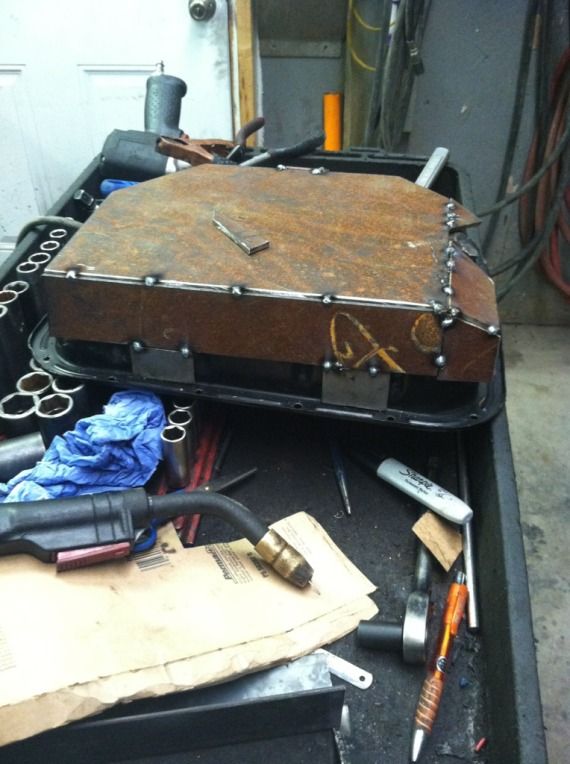

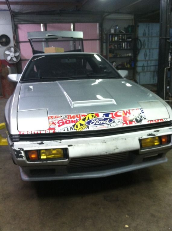

The car is low, i raised it up a little, but was still worried about my oil pan, i went mad max on that bitch! it should be good to go now! haha

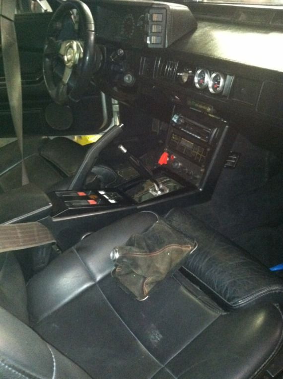

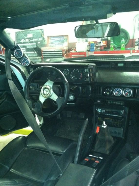

random shot of the interior, coming together finally

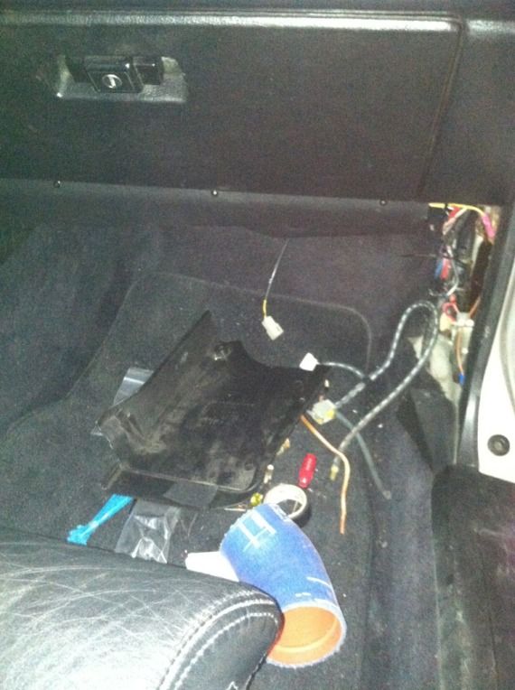

No videos yet, well i do have one of it driving, but we forgot to hook up the back cam sensor, so it wouldnt build boost..
runs great though.. we parked it for the night and the next day i drove it home, its acting the same way again, wont build boost you can hear it trying, and the boost gauge wont go past zero, feels like the computer has it in "safe mode" im going to check resistance on my cam sensors today and make sure they are good.. one of them is leaking oil into the plug, the back one. so i dont know..

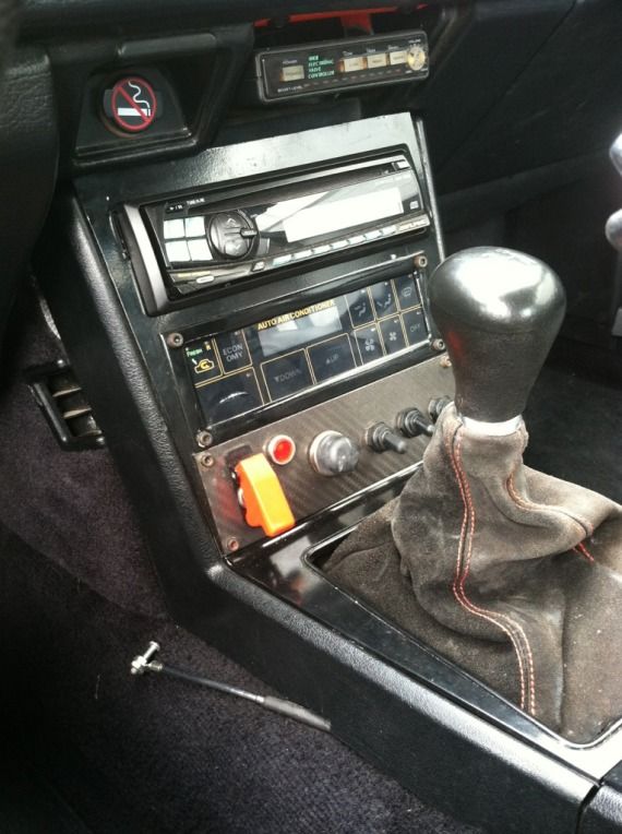

The top half of the R154 shifter was just way to tall, i made a shorter one.. turned out well
also fixed the running issue! runs like a damn champ!
