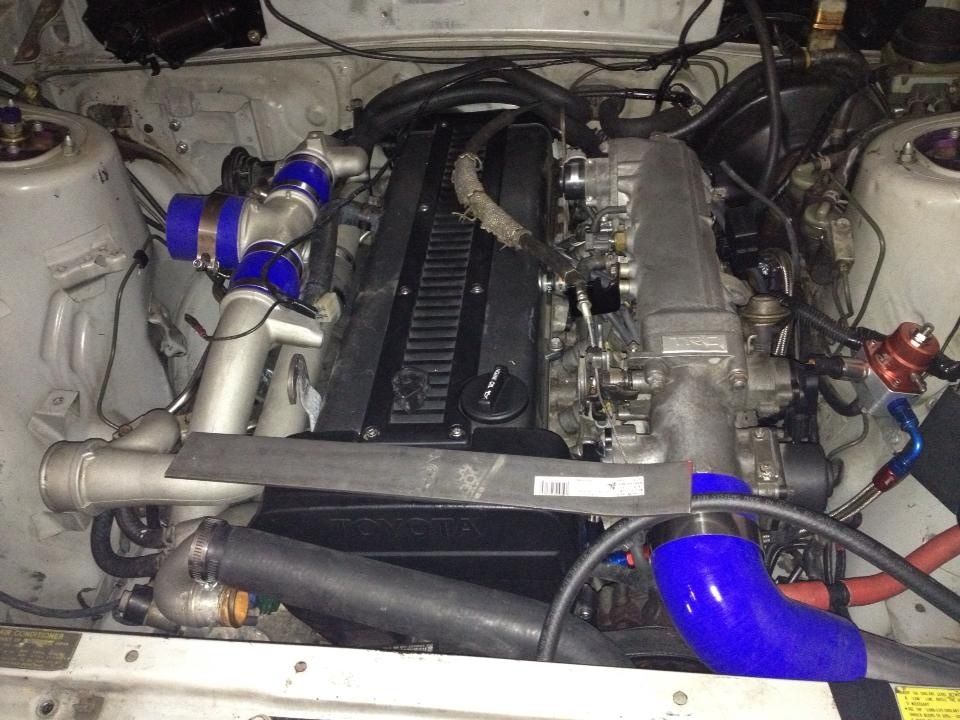

We got the engine set in

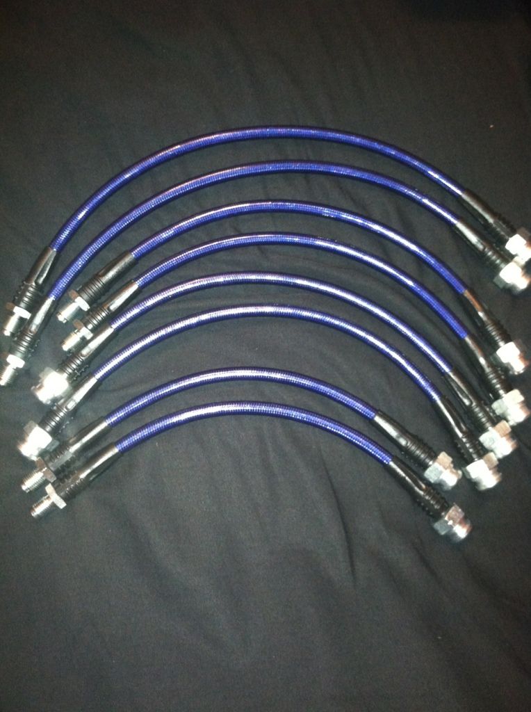

I figured it would be best to put some new parts in there while i was at it

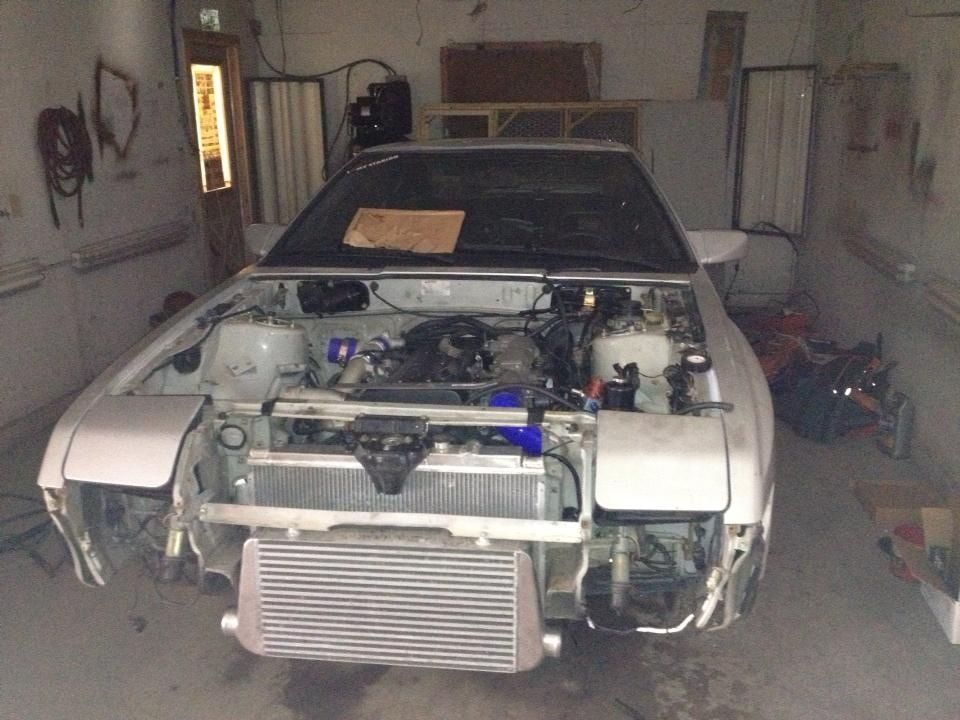

here is how the car is currently sitting.

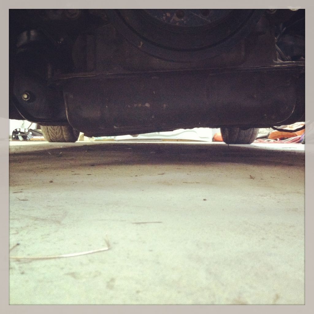

Ole girl is sitting low lol

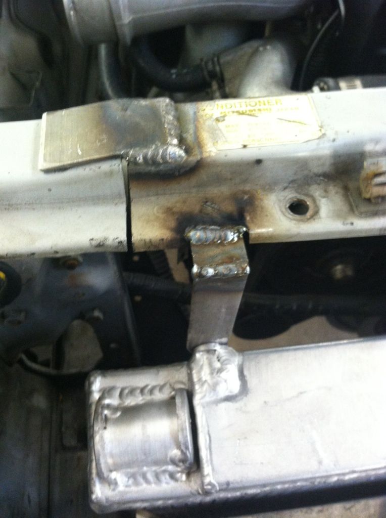

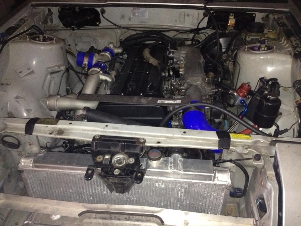

i had to cut the radiator support out to get everything it, i have it half way back together now. still needs a bit and finished my upper radiator mounts..
