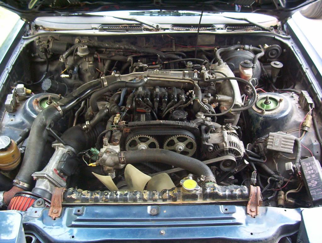

wiseco7mgt;1564453 said:
Wow the engine bay sure needs some work, spend some time on it and you'll get running sweet I'm sure. Just from the pic's the radiator actually looks just like a ma61 radiator i have in the shed, i could be wrong but it looks to fit funny in the brackets. Also your fan shroud is missing so that won't help your cooling issues either, after fitting a new shroud if the temps persist check for Bhg.
Clamp between the accordion inlet hose and the Afm looks to be missing also, Any stray air leaks tend to make a large difference overall, so do these little (cheap) things first and it will make life much easier for you when you start tuning down the track.
wow you caught these little things with this cheap as camera pics. i will do these little things as im going along. but update i almost have the engine out of the 1987 supra and my 1990 supra is ready to have the engine dropped in. i should have pics later on today. also found out today that my intercooler has a little leak and the previous owner has been running a w58 transmission with a 7mgte. quick questions thought. running a w58 transmission on a 7mgte shouldnt hurt anything should it? and the pre 89 engine mounts should be able to fit on the post 90 sub-frame without any problems? i know for sure that the post 90 engine mounts cant fit the pre 89 sub-frame.

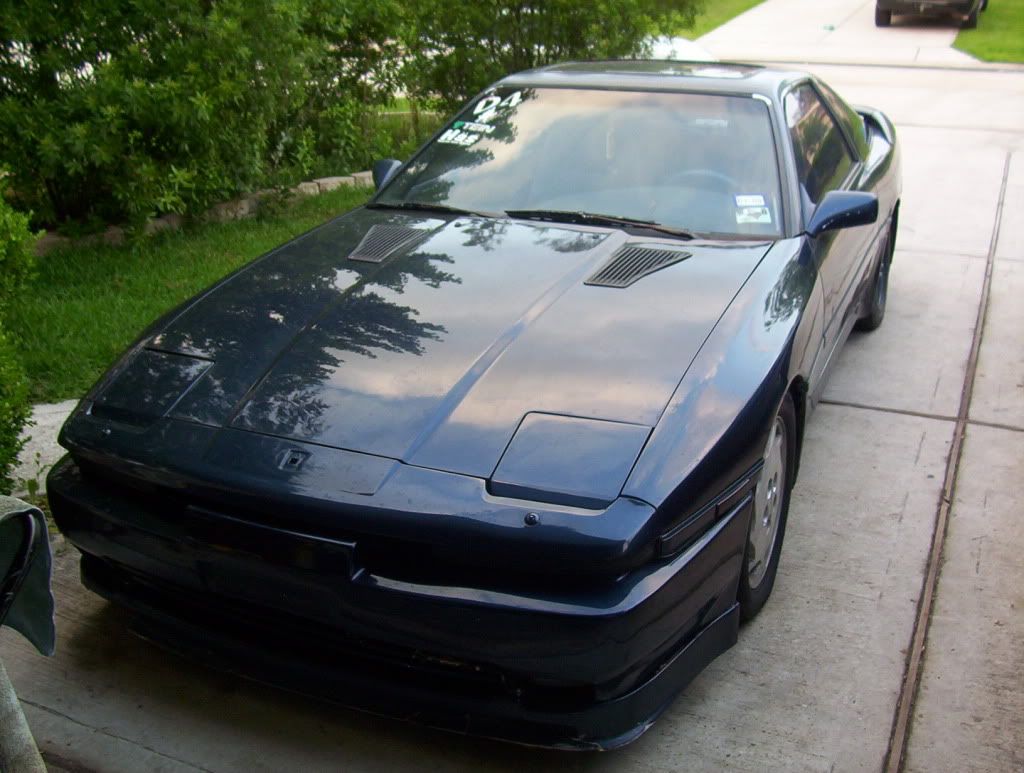

true that on the 100+ weather. houston is worst then san antonio i think. got the engine swap in today and dumb ass me forgot to take pics of before and after. still have to plug in the wiring. ic and pipings, radiator and so on. but heres a couple pics of both supras but not from today. hopefully i should have more pics soon. thats if my dumbass self doesnt forget to take some. lol
and heres the 1990 targa i swap the engine into. but this is the before pics as you can see on the dates.
dont you just love that minivan in the pic above. lol its a real pos.
paint is still off but will have it painted soon enough. most likely white.
