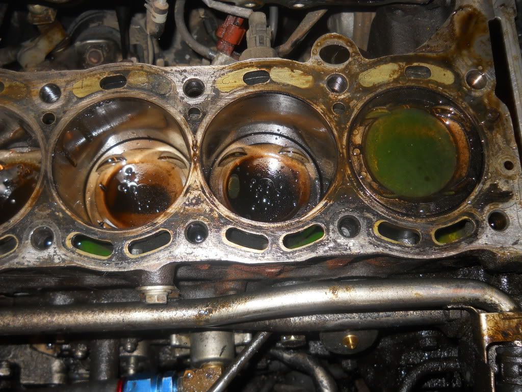

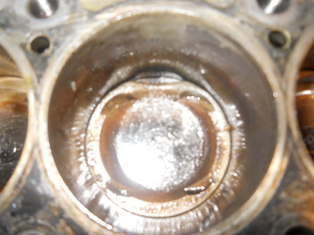

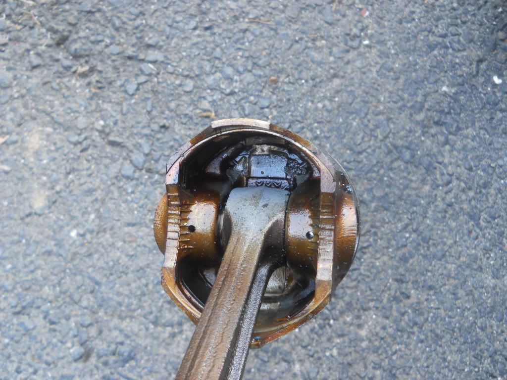

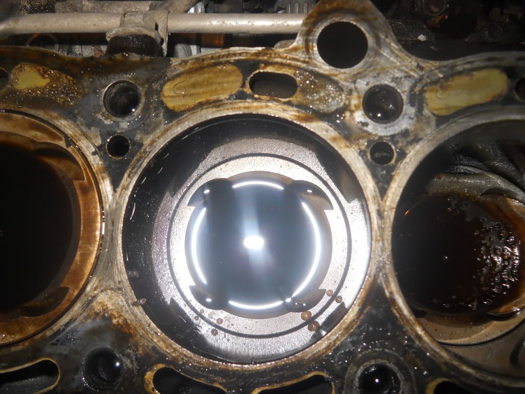

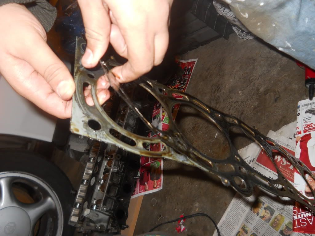

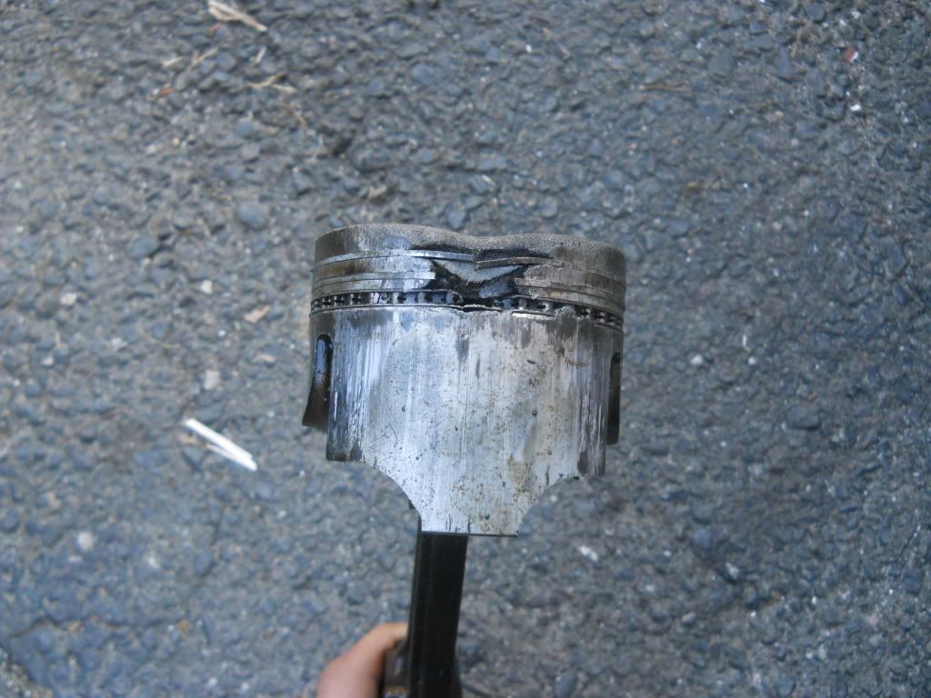

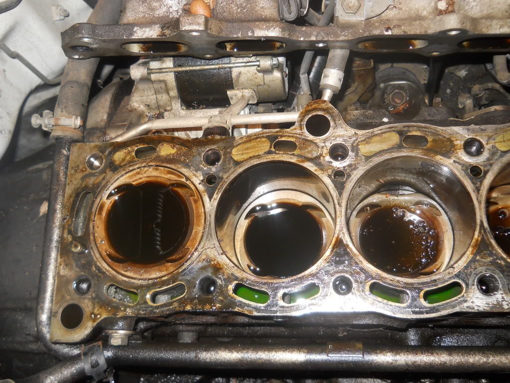

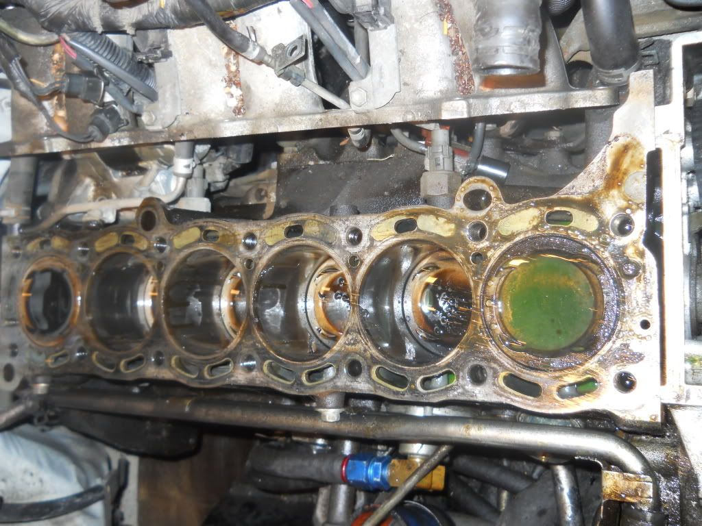

Well #4 piston is cracked! WTF! Here are some pics of the damage....

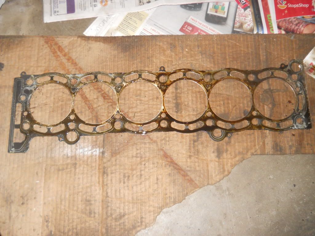

MHG was splitting at #1
other than that looks good
1st 3
last 3
close up
You could see the crack better in this one - #5

Since I'm low on cash right now, I can't afford a bottom end rebuild. So I'm thinking of replacing that piston and the MHG (if needed).
If you guys feel I should go another route let me know! Don't hesitate
Thanks, Mike

Anything else special about that engine? Might be worth looking at a whole motor. But your method will work to get it on the road, isn't the best but it works!

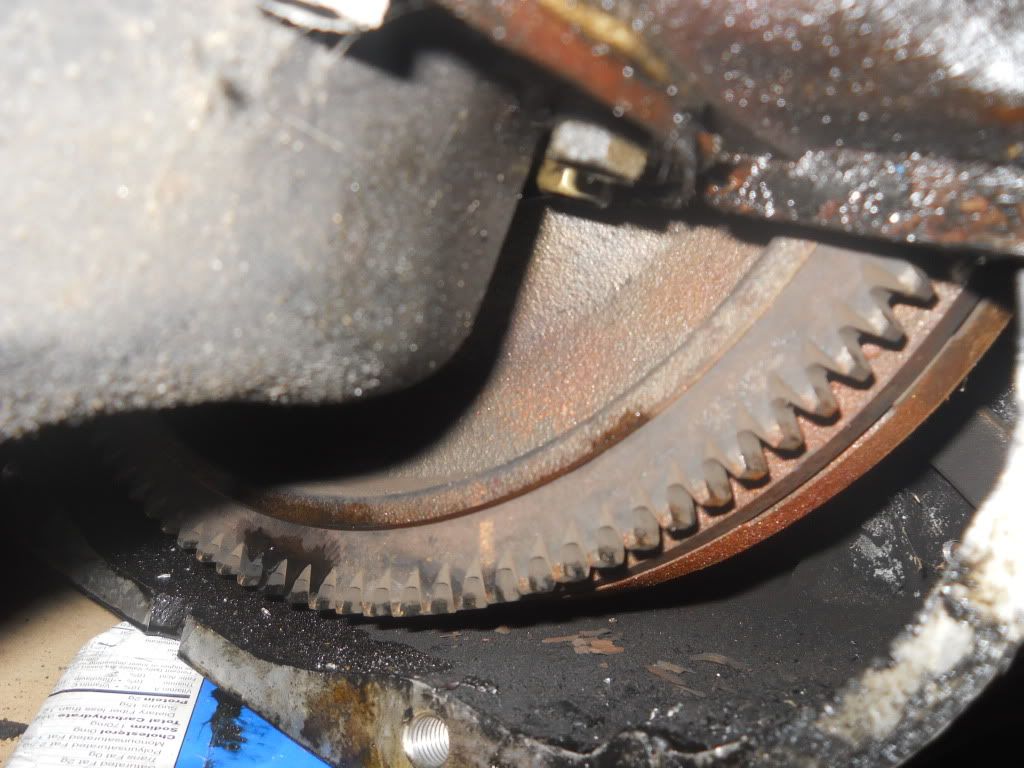

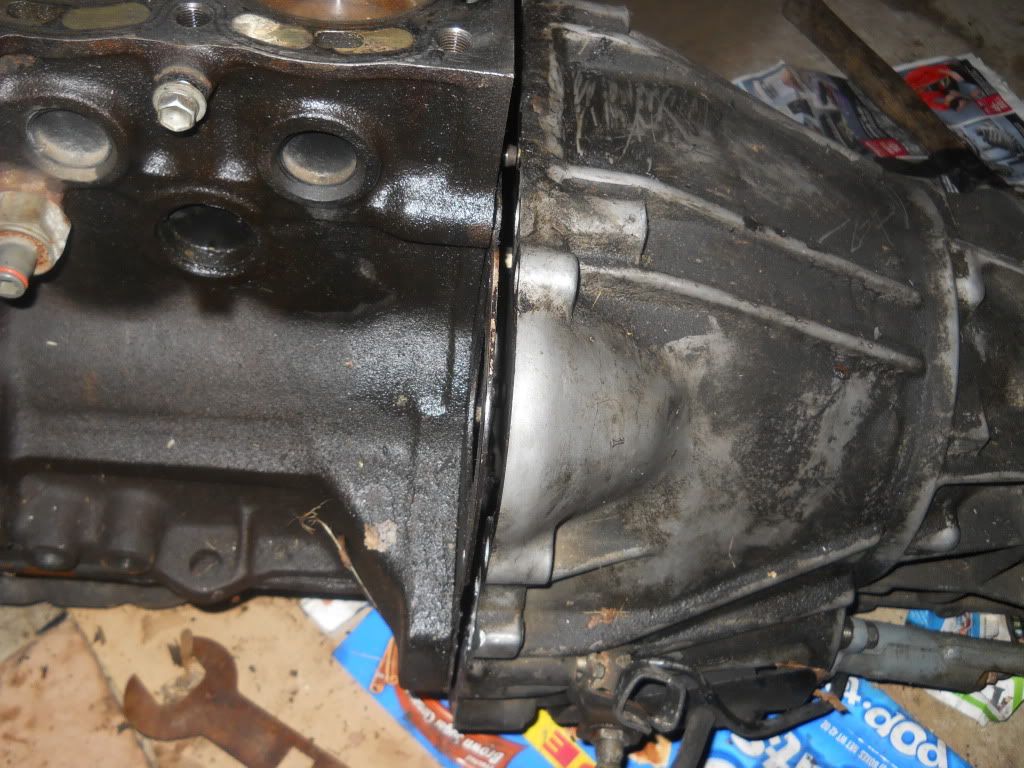

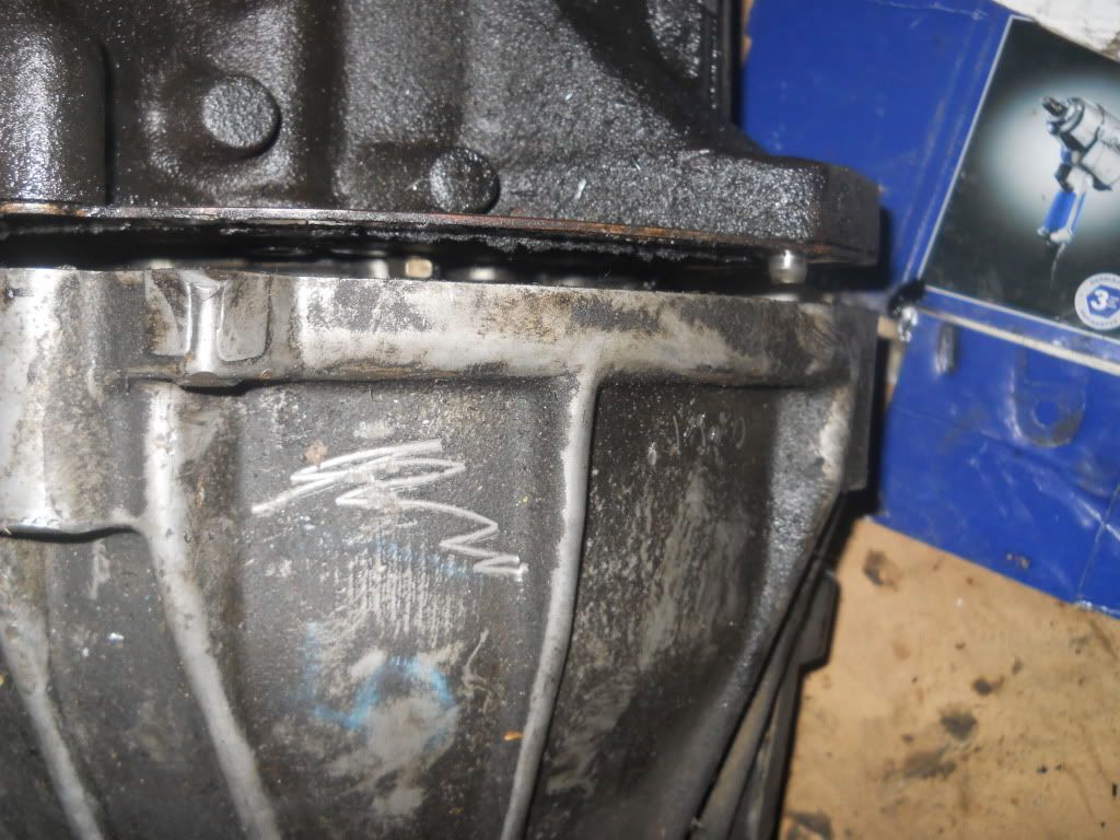

Yeahh I just saw the differences in the blocks. Decided to not go that route. Motors been out for some time, I've been busy with school though. So my progress is very sluggish lol. Now that the motor and tranny are out, they don't want to separate! Always something...
Any suggestions on how to get then separated?? Do I have to take the flywheel off???
