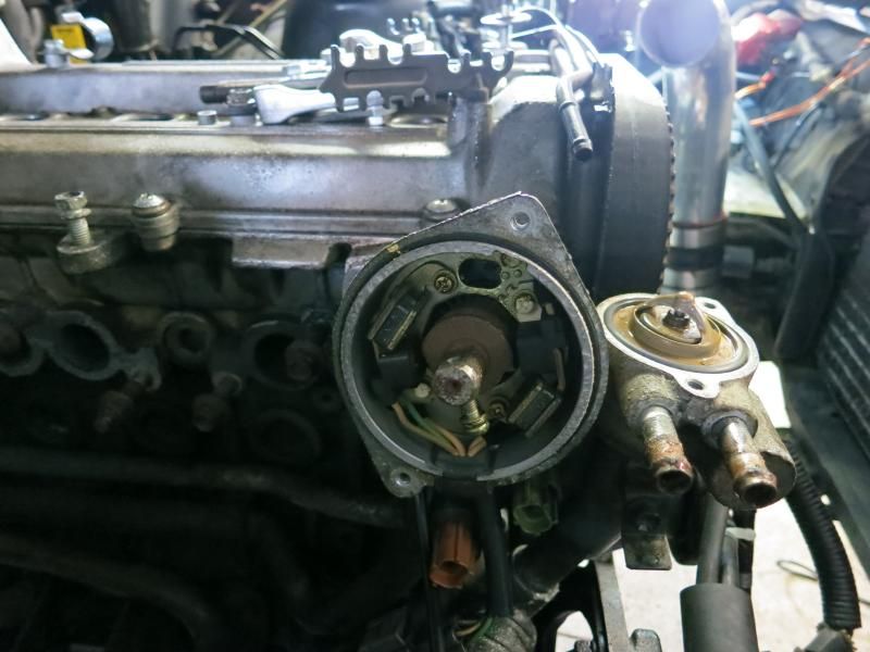

Fast forward to today and this Soarer gives me the same vibes as the Accord did with the strange engine. In Australia in Japan parts might be very easy to find but here the 1G-GTE has absolutely ZERO aftermarket backing since it was never offered. The car came with the basics on it but it was very slow and kind of laggy ( which is weird since the turbos are so small) but drove well and was mechanically sound, however it started to develop a smoking habit on warm start and loaded decel. Previous owner had changed the valve stems seals so I figured it was either the turbos going or the valve stems themselves where bad. SO now comes to the point in getting the stocks twins off which looked like and awful plan.

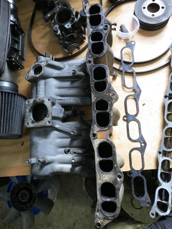

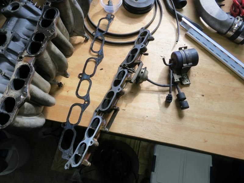

I got the intake off last weekend and that was almost as painful as the turbos, mostly because the vac canister for the secondary butterflies is right in the way of the last intake bolt. The scondary butterflies dont seem to have been functioing for quite some time so that could also cause the lag issue but I believe the main reason is due to the rear turbo being completely shot. The wheel has so much slop in and out that I lucky it didnt come apart. Tere was some oil in the downpipe when I removed it as well, which was not shocking.

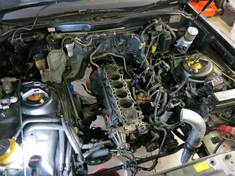

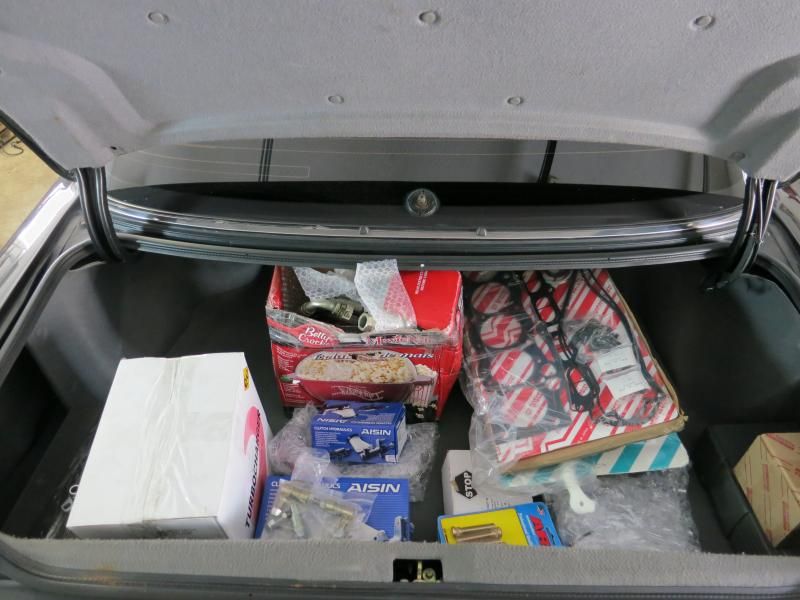

I did some work this weekend after crossfit, nothing like working out after you work out. I found that hiding all your new shiny parts in the trunk of the car you are working on is a great way to hide them from your wife.
I started taking the intake apart to be clean and test the secondary butterflies to see if they work, which they dont. There was some oil in the intake runners and the IAC was nasty.

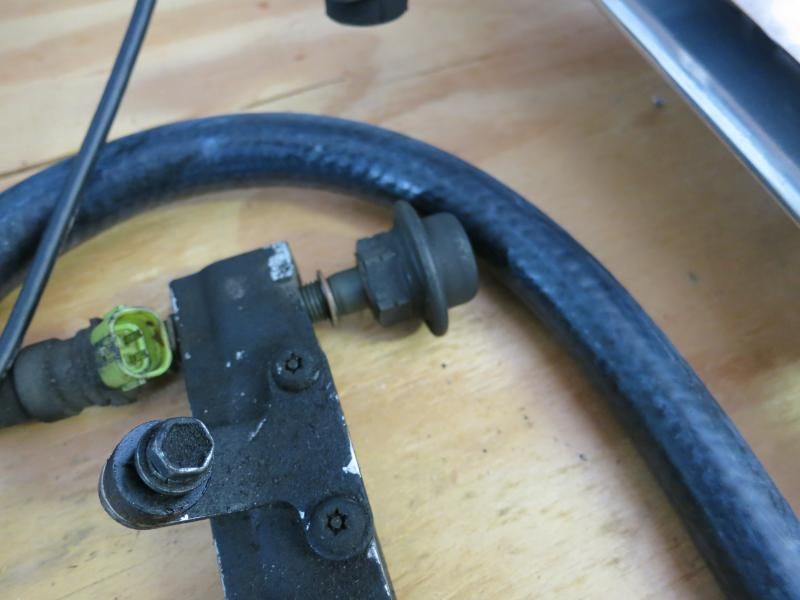

I also stumbled upon a piece that just doesnt make sense to me, this fuel damper on the feed side. 80s Fords just plumb the lines from the tank to the rail without anything fancy just like a caveman would. No J tubes or damper or anything crazy fancy :)
This however, I am used to.

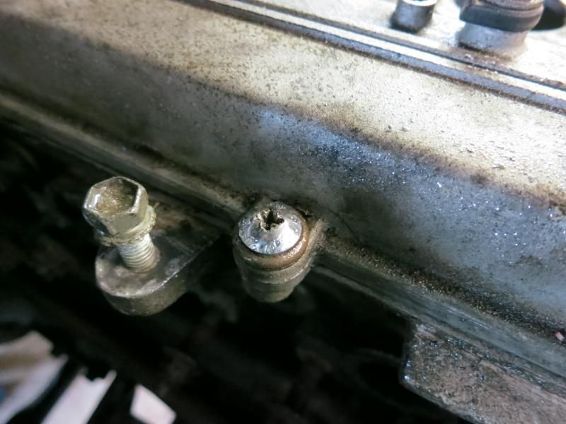

And this, like the fuel damper, is foreign to me. Why in Allahs name would you use phillips head screws in your valve covers... WHY?

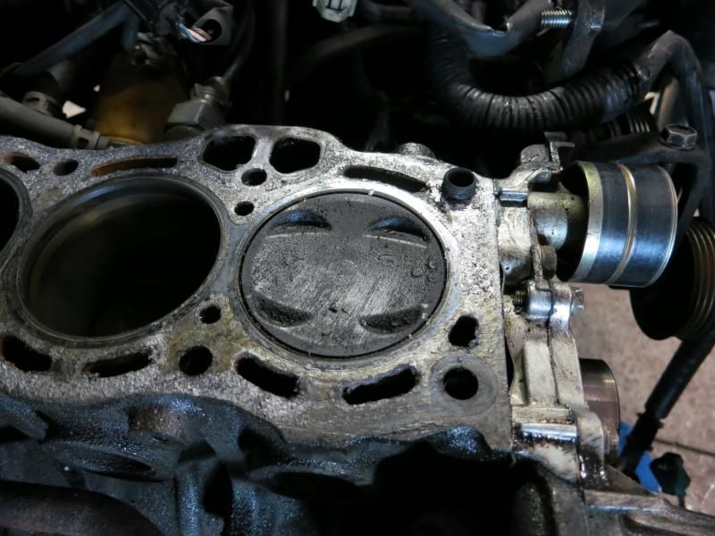

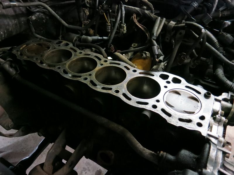

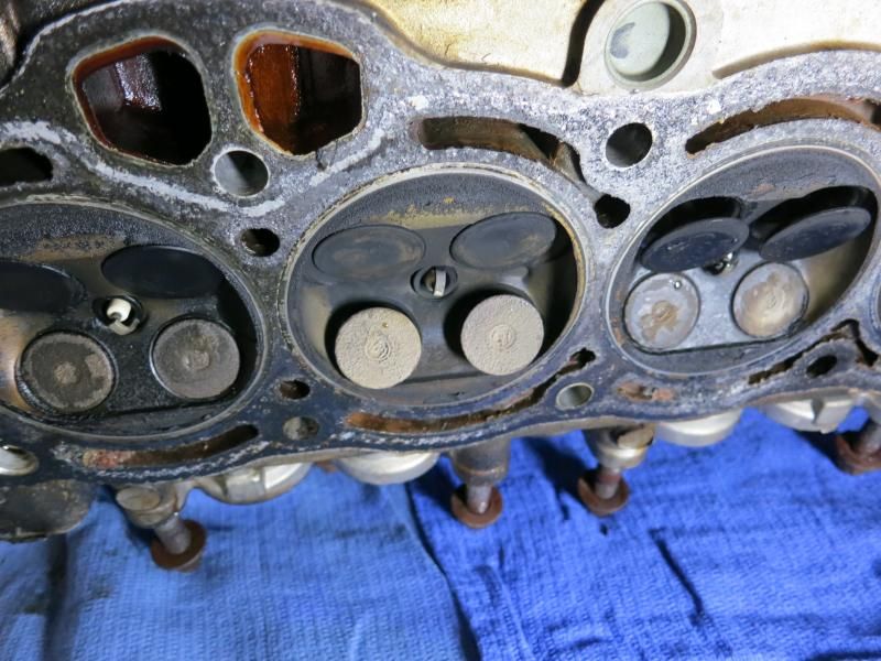

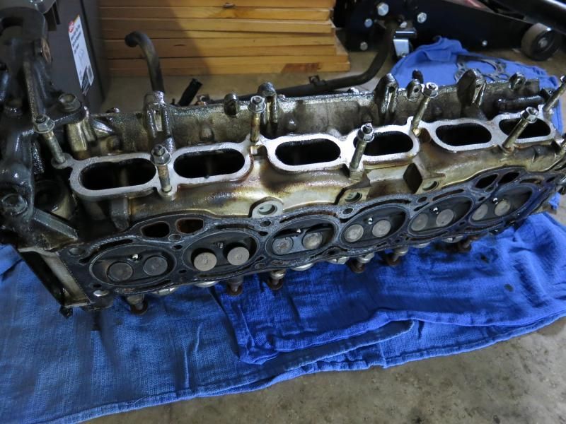

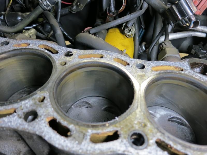

After a few hours of keeping track of thing in tupper ware and eating a snack ( fat guys gotta eat) I finally got the head off. Valvetrain looked pretty good other than the baked on oil.

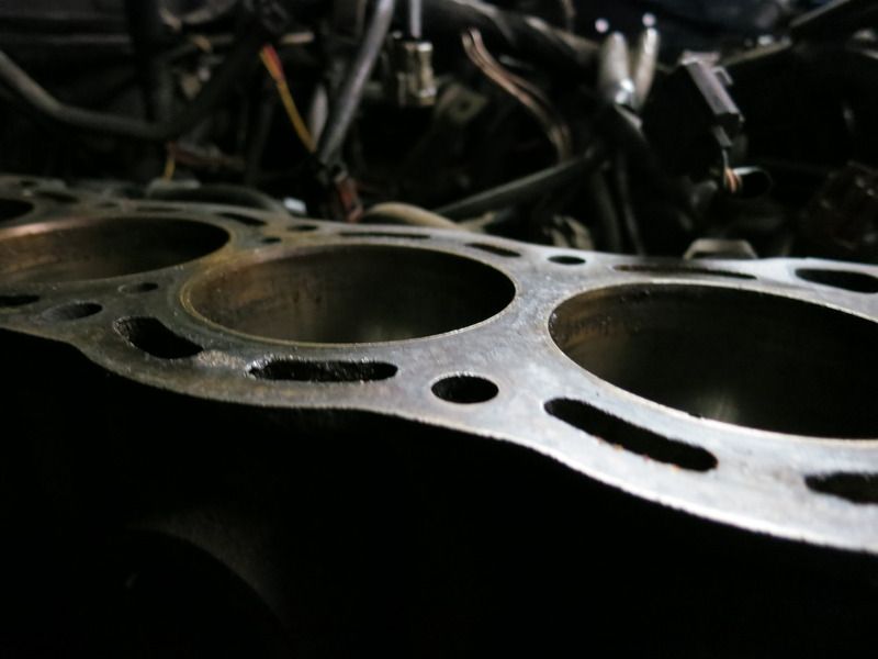

The pistons have some crud on them and are wet so oil was in there for sure. Headgasket looked great other than the coolant jackets in the block having some gunk on them.
Cylinder walls look pretty darn good for 112K miles.
These valves are so tiny but unlike my other cars there are 4 per cylinder and not 2. Some carbon build up to take care of but the color of everything looks good.
Taking the head off to the machine shop for an overhaul and maybe some slight work if there is any casting flash or something really obvious that needs ported. These heads are pretty efficient from the factory so thankfully it doesn't need a full port job. I am also sending off my stock used head gasket to Cometic to have them cop and make a nice MLS gasket for me. Should be better than the factory carbon one. While I wait I will clean things up and start on my brake upgrades.

Are you going to at least lap the block prior to installing a MLS?

Yes I am, push comes to shove I will have Cometic do a copper gasket with a wire ring in it already instead of o-ringing the block.

Phillips head screws to prevent over torqued of the valve covers. I used 10mm hex screws on my 7M, and of course I tried not to tighten them too much too. I would assume thread pitch on the 1G head is probably the same as the 7M so you can definitely do that.

I have tried a few US Toyota dealers and they say there is 1 left here in the states but it doesnt actually exist. I have also tried a Japanese distributor and it is the same story, the cap I have just not the rotor.
That makes sense, not a bad idea until you round half of them haha. I was going to use some torx screws instead. I am lucky in some respects that some part transfer from the 7M but then other things I have to make work.

I really appreciate it! I found one for a GE motor but it was different in appearance. I had asked Curt Agner from SF and he pointed me to Nigel-JDM Parts who found the cap for me.
I should probably just go with coil on plug haha

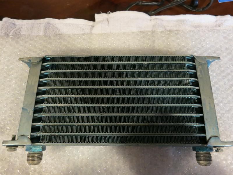

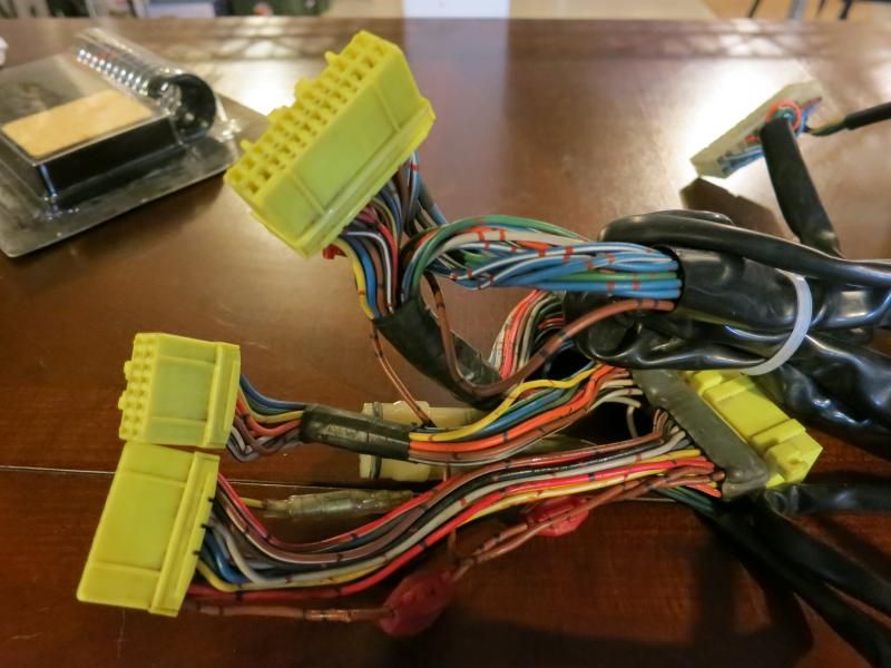

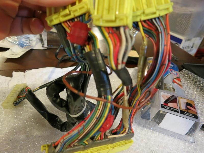

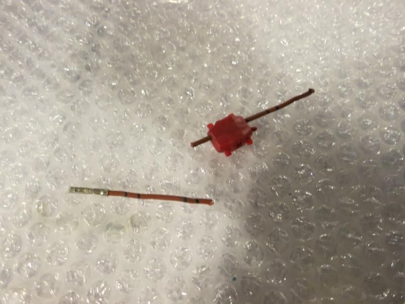

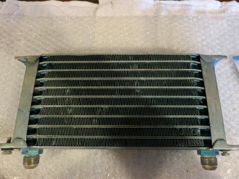

Since I will be waiting for the head to get finished I figured I would work on the "free" stuff. Fixed some of the fins on my oil cooler and I also start to remove the vampire clamps from my F-CON harness. I will be placing another order with Driftmotion here soon for some fueling parts.
Start with this:
Use these:
Make look betta:
I hate people that use these vampire clamps
Going to try and locate a donor harness for the wires and plugs. If anyone has one they don't want a 89+ grey plug would work best.

Lol the HKS Field Harnesses came that way.
schmuckingham
Dec 12, 2014
56
OHIOWN
They Did? The have wires that have been cut coming out of them and it would be a huge issue if they grounded

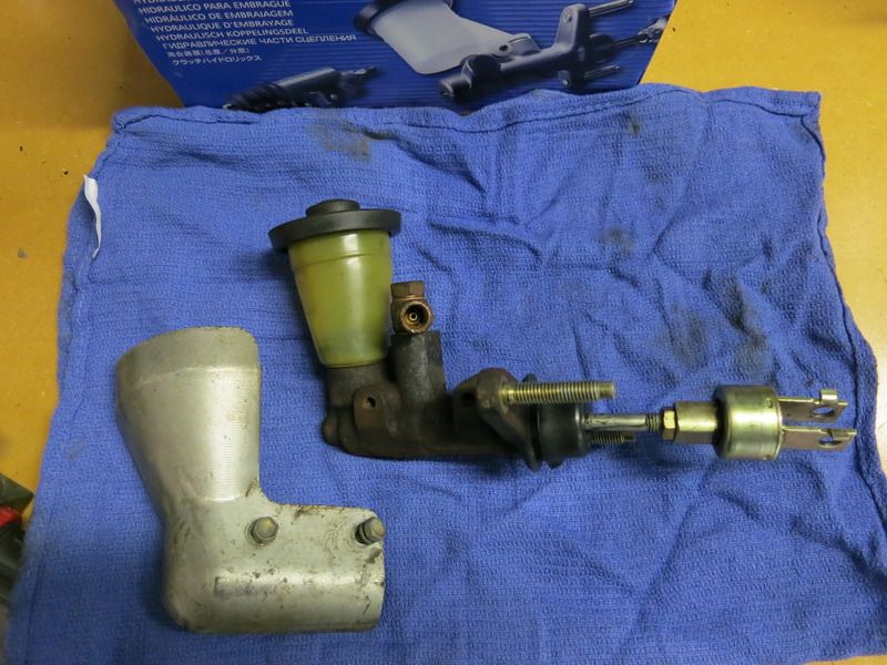

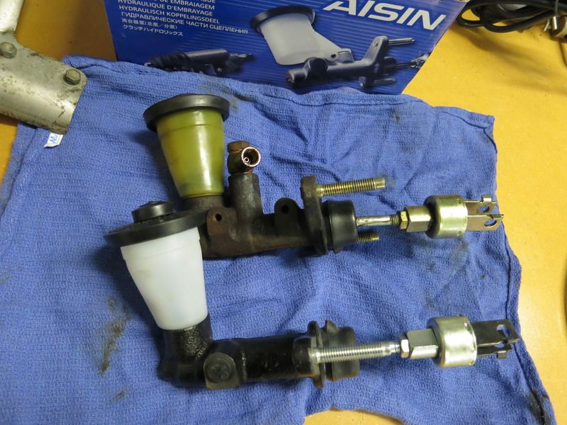

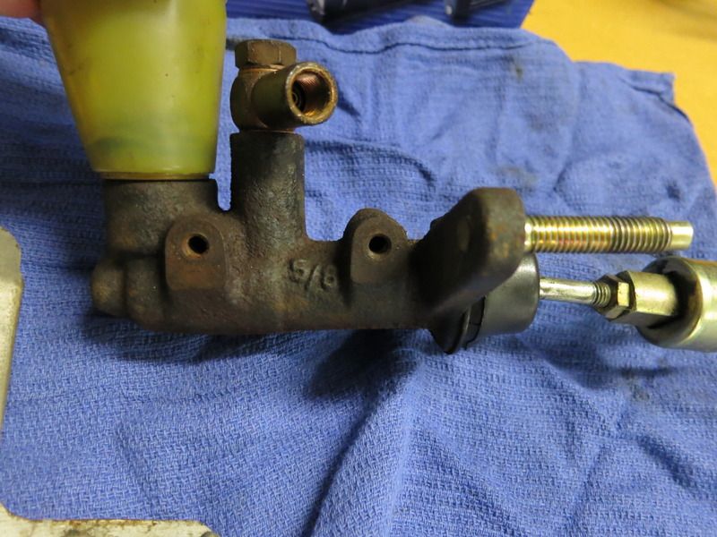

Got a chance to work on the car last night since the weather is nice. I had ordered a MKIII clutch master cylinder in hopes it would work since the Soarer one is no longer available. The MKIII one fit perfectly to the firewal and the clutch pedal, it shares all the dimensions from the firewall to the pedal but it is shorter on the end of the reservoir. Fits tight against the firewall however there are some differences. Since mine is RHD the master cylinder sits right on top of the turbo setup and has a factory heat shield and the port for the clutch line is on top making the line go on top of the heat shield.
Super RARE JDM Vs USDM
The master cylinder was leaking very slightly inside the car when I pulled it. What prompted this was a weird clutch engagement when I would drive it, however when I bled the system this is all I got out of it... might have been an issue:
After looking at everything I would really like to re use the Soarer master cylinder since I can use the heat shield, thinking about taking it apart to see if I can swap parts. Push comes to shove I will build a new heat shield. I also removed the super tight JDM y0 boost controller that didnt work.
I also spent about 2 hours with a can of brake cleaner and a razor cleaning the block for the new headgasket. For elbow and forearms ache today but it came out nicely. I also had a excessive amount of burnt oil built up on top of the pistons thanks to the blown turbo.

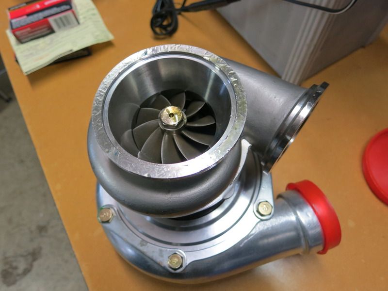

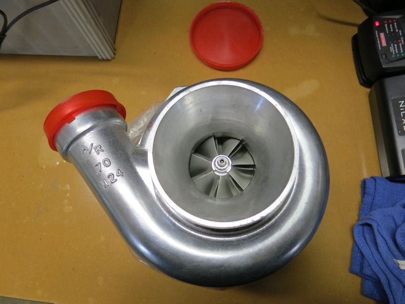

Put the Vband housing on the 30R, tiny little guy.
