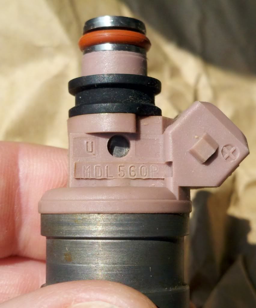

hvyman;1734279 said:
If there high imp you dont need the resistor pack. If there low imp like stock then the resistor pack is on the drivers shock tower.
So since the Low Imp. just wire them in and leave the Resistor pack right?
Driving to phoenix today to buy another set of four from a guy and come home and install these tonight if autozone has some pigtails.

supraguy@aol;1734384 said:
I just picked up a set of 6 Evo 8 injectors today.
You need Bosch EV-1 type connectors. I just got 6 on Ebay for $35 shipped.
hey i have the exact same injectors, i had no idea what brand they were. I pulled them off my buddys integra cause he said he doesnt want them. free for me, just gotta find 2 more evo 8 injectors

Well i go all the other 2 injectors last night i still need to order some pigtails but i think im gonna go with what your guys are talking about in CyFi6's link..
One question be for i install this i know i need to upgrade the fuel pump soon but should i wait and just do it all at the sametime? is it dangerous not to upgrade the fuel pump be for i do the injetors.
Im not upping the boost at all until i do the Fuel pump and get a AFPR installed.
The reason i decided to go this route was for reliabilty because more car has been running super rich and hitting fuel cut at 10.4psi So i bought the injectors and AFM to get away from that and try and get away from 2 of the codes im throwing (24-34) i bought the Aem Uego and S-AFC to help tune.
Anything else i should look at picking up to get my car running correctly be for i decide to turn up the boost? (13psi is all im looking for out of the stock turbo)
