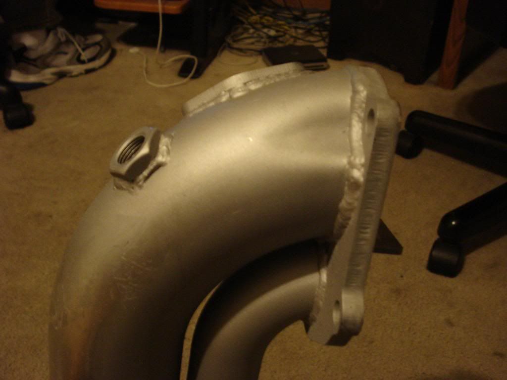

I bought a BIC DDP with the flex section rerouted and second 02 bung options, got it yesterday, and the first thing I noticed was the location of the second bung:
After reading this thread I understand that this is way too close for a wideband sensor. This is what it says on the website:
"Second Screw-in style O2 sensor bung. 18 x 1.5 threads will fit wideband O2 sensors or the cheaper screw-in style O2 sensors."
So why is it so close and what do I do about installing a wideband sensor on this pipe?
"Second Screw-in style O2 sensor bung. 18 x 1.5 threads will fit wideband O2 sensors or the cheaper screw-in style O2 sensors."So why is it so close and what do I do about installing a wideband sensor on this pipe?
I had my sensor in this location for a while with no problems on an upgraded CT26. But the sensor quickly died when I ran a larger turbo.
It's a bit expensive, but I've been running the heatsink I mentioned above http://www.diyautotune.com/catalog/i...nder-p-73.html and my new sensor seems to be doing fine, even after a huge local heat wave and running 26psi on race fuel. I think the design of this heatsink is very good and effective, and is good insurance for the life of your sensor.
