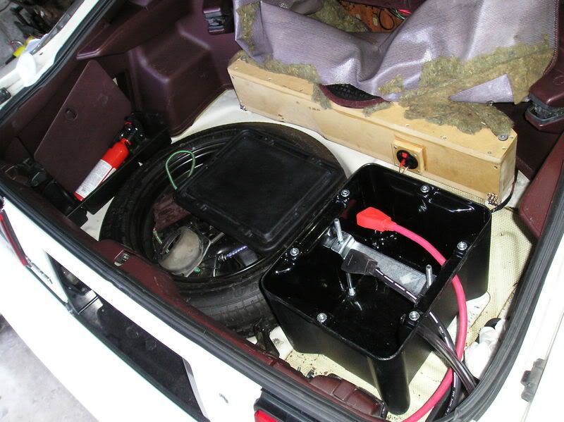

It can be done. Summit racing battery box kits fit under the targa, and still allow enough room to keep the spare, though it sits closer to the spare than the corner to clear under the roof. Conveniently, it will fit a full size battery as well. You have to cut the plywood floor a little, but no issues. Oh, though you do need to drop the tank to bolt the hold downs to the floor.
