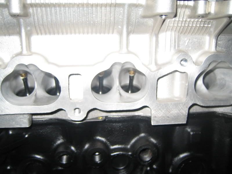

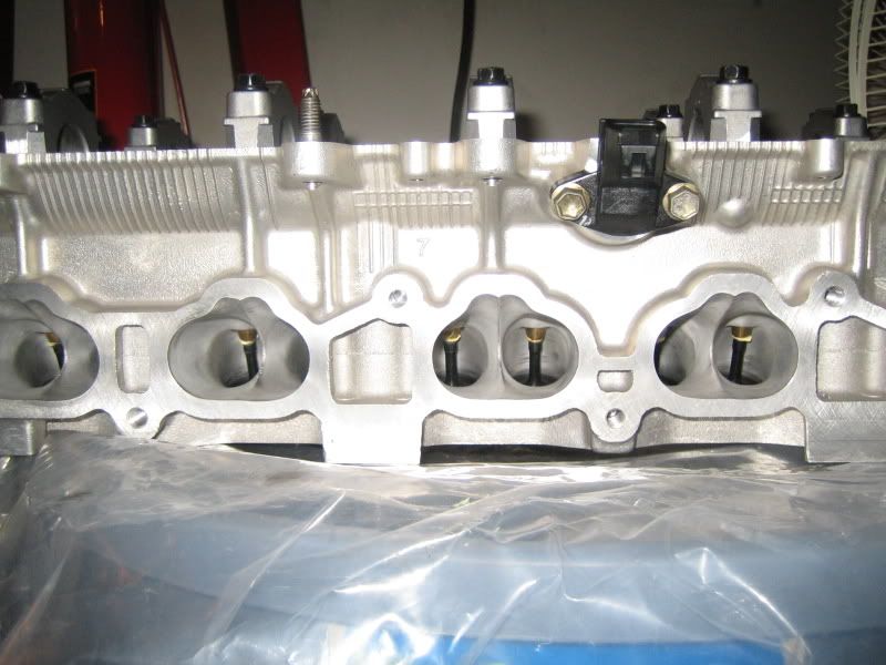

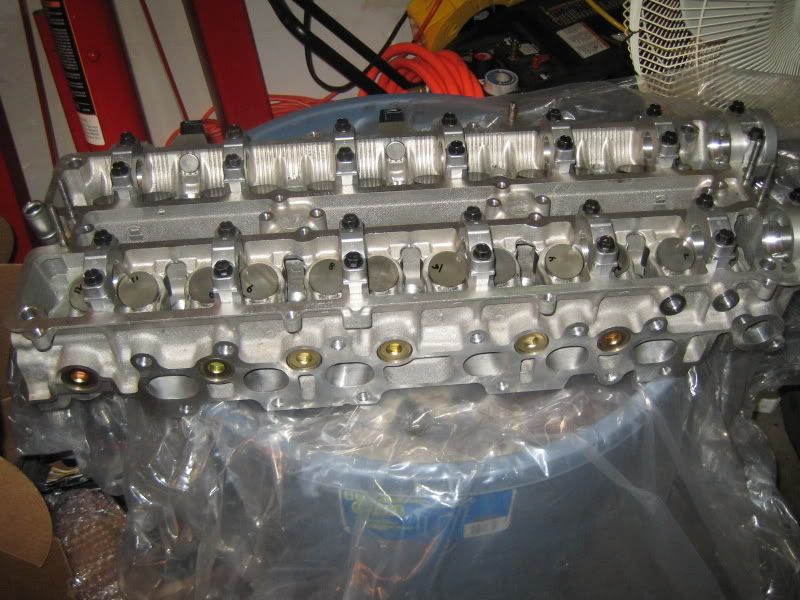

heres some pics of a 2j head that we did.
