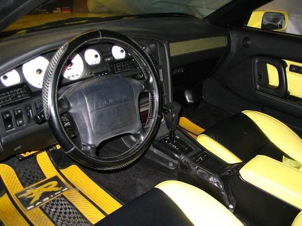

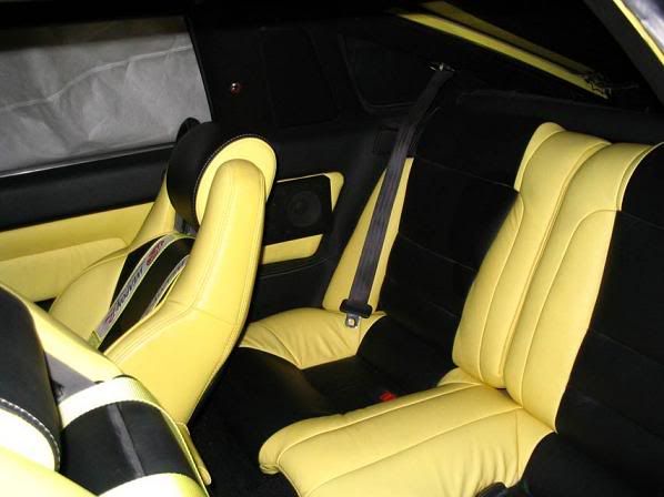

sheesh you guys did it the easy way... i sanded down every bodypanel that was grey and rewrapped it with black vinyl and yellow stitching... these are the parts that were rewrapped:
entire dash, both door panels, headliner, 2 targa liners (i have two targa's), rear side panels, rear roofliner, replaced carpeting with black carpet, and all the seats rewrapped in yellow/black leather...
but i suppose if you are going for best look vs. price... painting the existing vinyl is the best way to go. heh... this job ended up costing ~$3k ... mostly because the dash had to be done 3 seperate times because the previous owner must have soaked it with armor-all at some point and the glue wouldn't hold...
