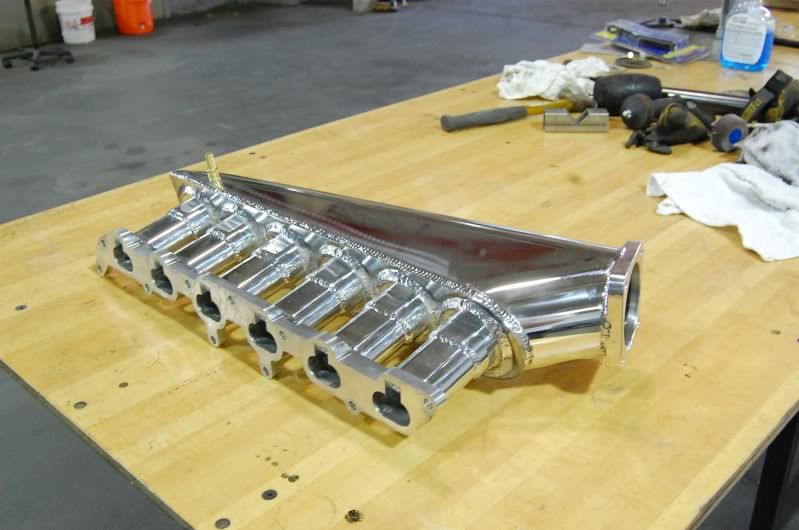

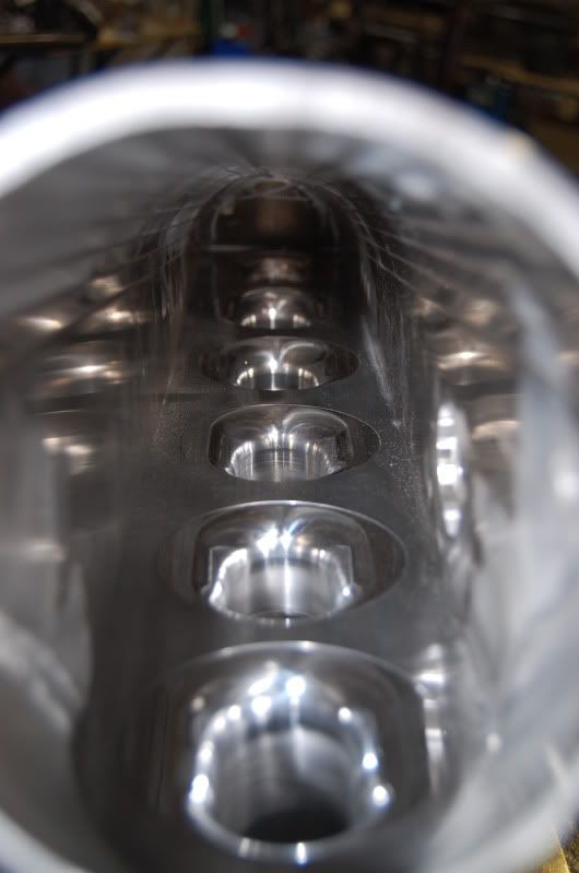

EDIT: Keep in mind everything that's polished is super dirty and needs an intense cleaning/buffing. Here's some pics:
Also, forgot to mention. I'll be ditching this FFIM and going with a custom sethron manifold. He says it takes about 2 months. So don't expect to see it anytime soon! ;)

Cool build.
That intake manifold is hot, I was wondering if someone made that type of manifold for the 7M, The stock manifold routing just kills the way the engine bay looks (In my opinion)
How much did it cost you? ( If you don't mind saying)

Thanks. Intake was around $600 IIRC. As you can see on the previous page, I'll be replacing with a Sethron intake.

Haha, yeah I over-looked the that first one you have installed, Was wondering how much the Sethron would run you.
I'm most likely getting an N/A supra, so I'm not sure if this would be worth it for the N/A 7M but maybe in the future if I were to turbo it then I'd be interested.
