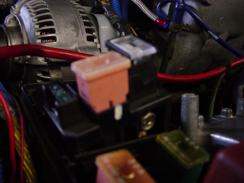

Ahh. The legs on that fuse are bolted in. You have to take the fuse box apart a little to change it. It's not hard. If I remember right, that block will pop up so that you can change that fuse. Make sure you disconnect the batt. first...

heres a pic:
see the bolt? theres one on each side

i assume you're talking about the fusible link. no, there's no core, i seriously hope that you guys are kidding. grab a new one from the dealership. i got mine for less than $4.
