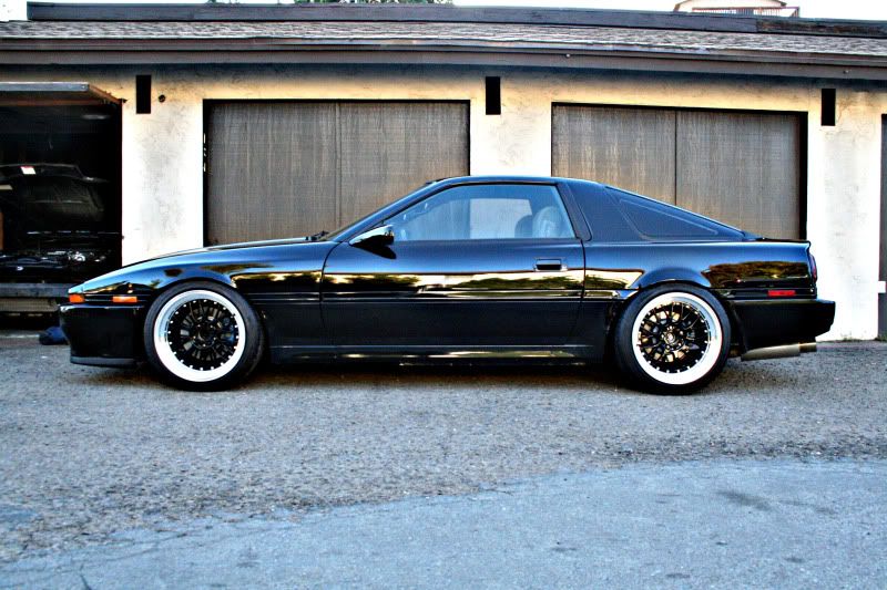

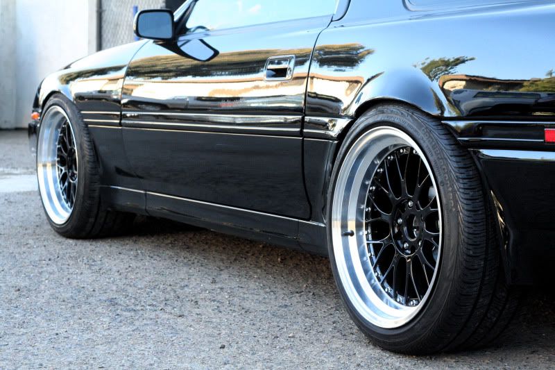

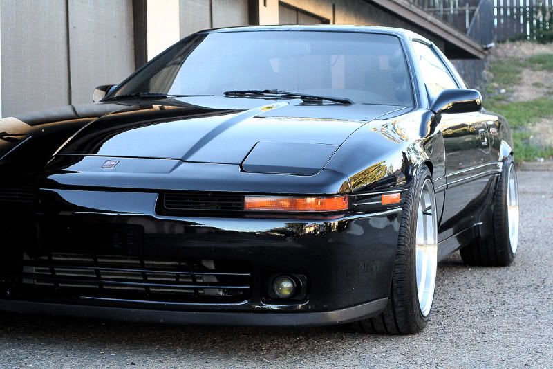

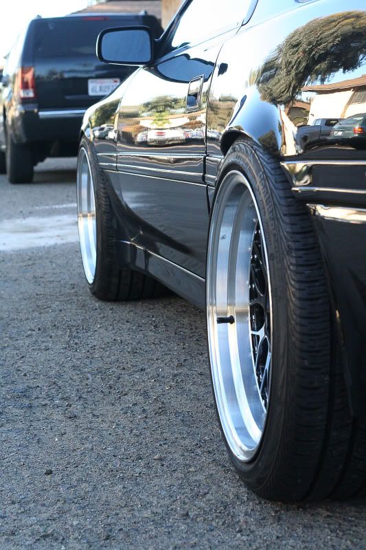

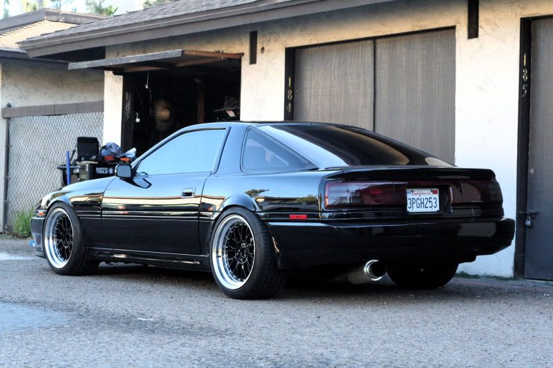

Here is amar from sd. This is the most pull ive ever seen.
exactly what I want!! What do I do to get this look?

tyler i would say try to run those fr500 17x10.5 wheels. there is a member on here with those wheels on his silver mk3 and he is running a nice set of beefy tires on it with coilovers lowered. I would stick with a 275/40/17 tire in the back you might be able to put out a little bigger but you will need to do more fender work...that should be plenty and trust me that car looks pretty meaty with those 275's

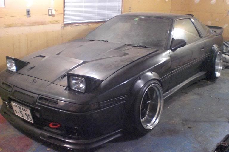

I FOUND IT!!!!! Z FLARE PICS
owner garagefujimoto
^i think...
specks of the seks!!!
F: 18 X 12J -18, 15mm spacer, 275/35R18 FK451
R: 18 X 12J -28, 15mm spacer, 275/35R18 FK451
Don't try this at home.
Front fenderwells are fully gutted to make room.
Negative camber upper control arms.
Arches were rolled and pulled before, now they have been cut off.
Flares are for a JDM Datsun 240ZG.
Tires to be replaced with stickier tread once these get burnt.

That needs shaved moldings to look right... bolt on fender flares over moldings is weird.
