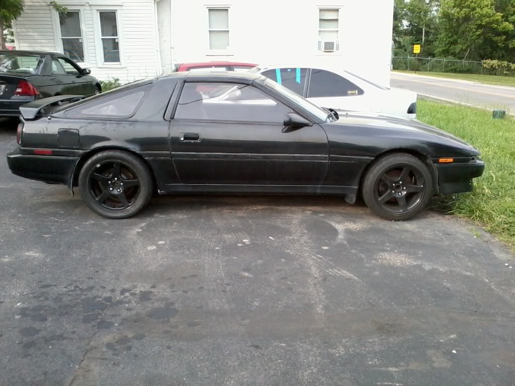

so im running 315/35/17's in the rear, getting the tires mounted this week on 03 cobra svt rims Back Spacing: 6.02" (153mm) Offset: +26mm (1.02").
rims had 275's when i got them, looked mean but i wanted more rubber back there. just eyeballing everything im gonna need to run a spacer to move the rubber away from the shocks. that pushes the wheel out past the stock fender, so there are a few options...

my cars paint is horrible to begin with, original silver, with a gloss black maaco paint job... im not worried about messing it up with an agressive roll... i will atleast attempt a roll and pull first, if its not enough i'll go from there.
smaller tire? smaller rim? might as well get a smaller turbo, or even better a 1j swap. haha

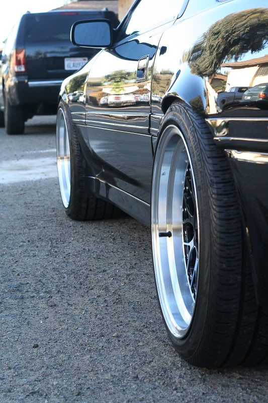

Doesnt really seem negative. a smaller tire that grips more will do a better job than a wider shit tire. Up to you tho.
Might be able to fit it if you add some spacer.

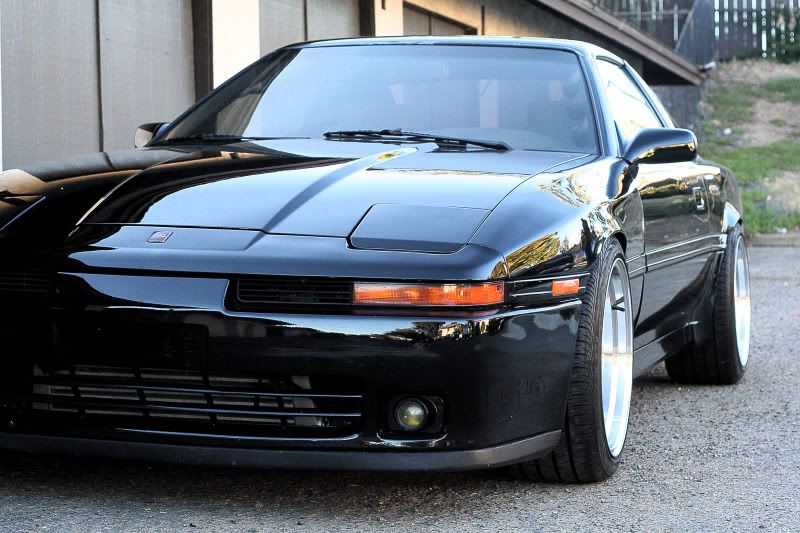

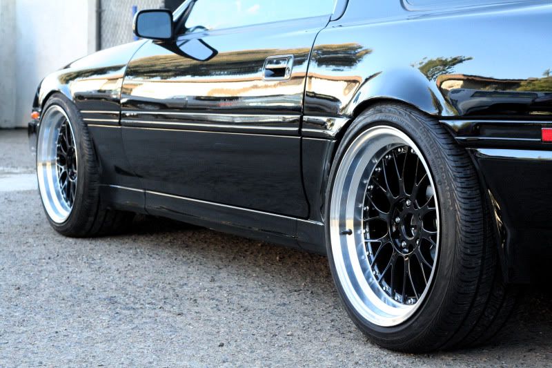

Here is amar from sd. This is the most pull ive ever seen.
Edit: He says hes going to fit some 13in wheels with the s2 wide body. IDk about the tires tho.

hvyman 's suggestions weren't negative, they were realistic and helpful, and the way to get close to that look for less money. If you don't want to appreciate free advice then don't bug us.

hvyman, I wasn't tring to be an ass. my apology to you sir. im too sarcastic sometimes.
anyway, back on topic ...nice roll!!! any idea what offset those wheels are?

Those are just xxr 521 18x10 +25 all around with i believe a 20mm spacer in the rear and prolly a 10 or 15 in the front.
TIres are prolly 265 or 255.

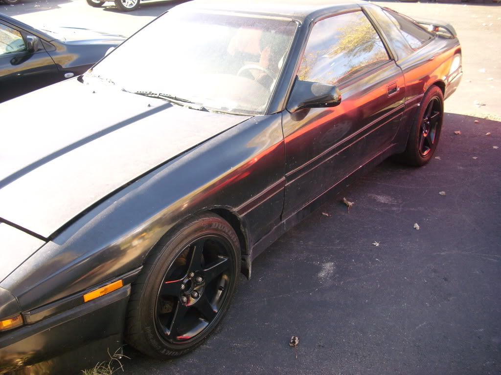

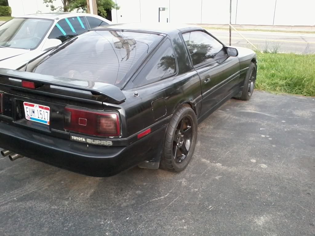

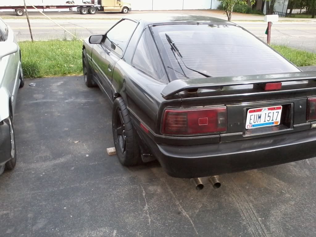

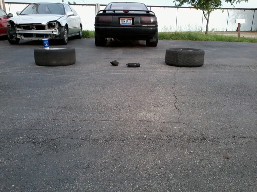

those were 265's o_0 wow
275's were still sunken on the wheel ever so slightly in this pic
and i think i have a 26 offset

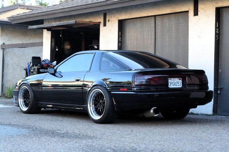

im hopeing to get the 315's to look a lil like the 245's did on sawblades... my own anti hella flush style.

On the rear? 285 or 295 would have fixed that. 315 is a massive tire. Also the tire brand and model sometimes look different,
Some 265 35 conti in my garage look bigger than some junk 285 also in my garage.

is there a picture floating around of a mk3 with the 280 z bolt on flares?
I believe i'll be able to tuck the wheels with a good healthy pull and roll on the fenders.

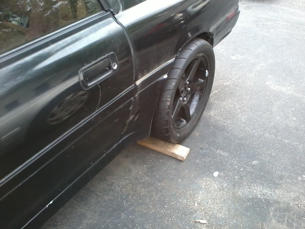

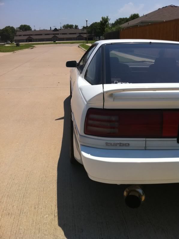

GrimJack;1718255 said:
315 with a smaller fender pull than what's posted above has been done. It does require absolutely perfect offsets, mind you.
315/35/17 Nitto Drag Radials on 17x11 inch wheels, fenders just rolled flat:

Now that I see the 315s on the car, ya there a bit oversized. Next time around I'll get 275-305's or step up and get some nice aftermarket rims.
zack, props to you... posting usefull info and even pics, definatly not being a troll on this thread
