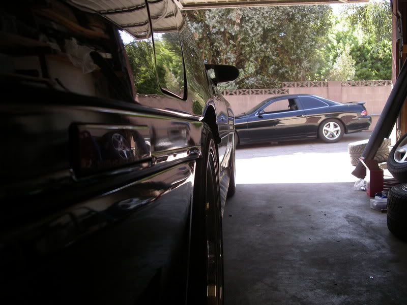

Sawbladz said:
17x8 Front +25, 225/45/17
17x9 Rear +39, 255/40/17
I personally feel these wheels fit perfect. They are FLUSH in the front. With the 225 I have had them rub only once. I beleive with a slight roll I could fit 235's for sure, possibly 245's but I will do some measurements before confirming. The rear's are almost as flush and allow plenty of fender clearance to fit any size tire. I will be looking at inner clearance but see no problems running 275's. I woud also like to stress that my tires have no stretch. They are very square shouldered and the 255 BFG's tend to run wider than the same size in other brands.
http://i74.photobucket.com/albums/i271/Sawbladz/PICT0737.jpg
http://i74.photobucket.com/albums/i271/Sawbladz/PICT0711.jpg
http://i74.photobucket.com/albums/i271/Sawbladz/PICT0027.jpg
http://i74.photobucket.com/albums/i271/Sawbladz/PICT0029.jpg
http://i74.photobucket.com/albums/i271/Sawbladz/PICT0023.jpg
I do love your wheels what kind are they??
