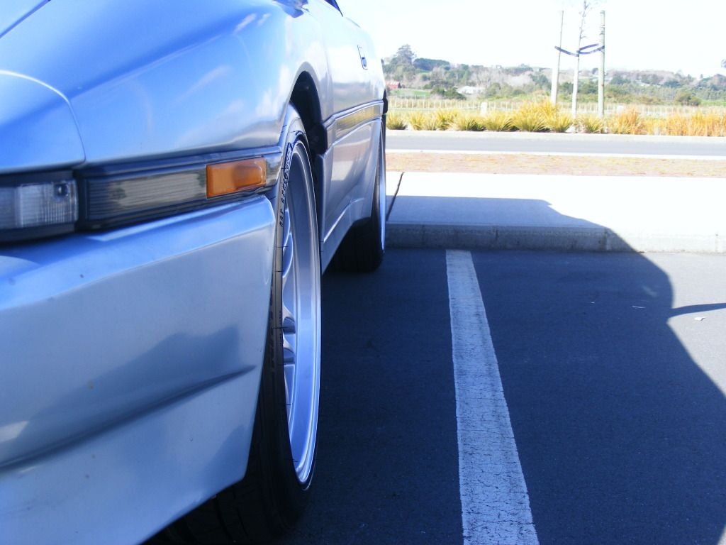

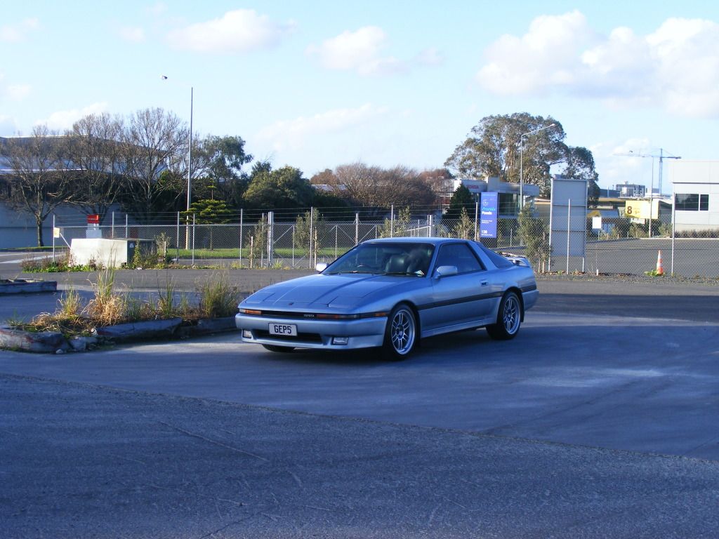

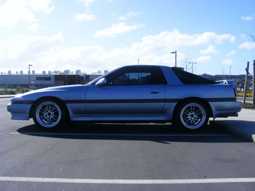

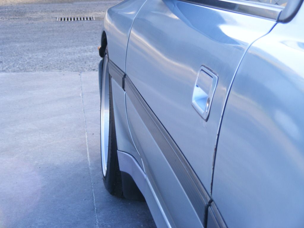

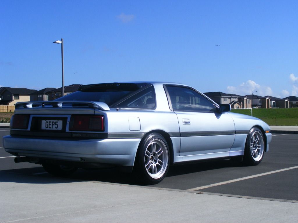

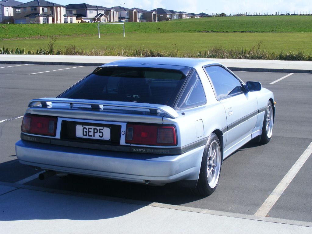

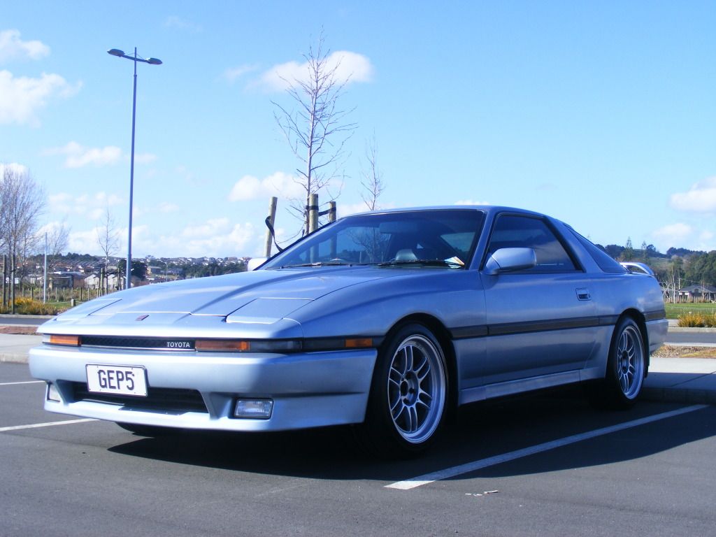

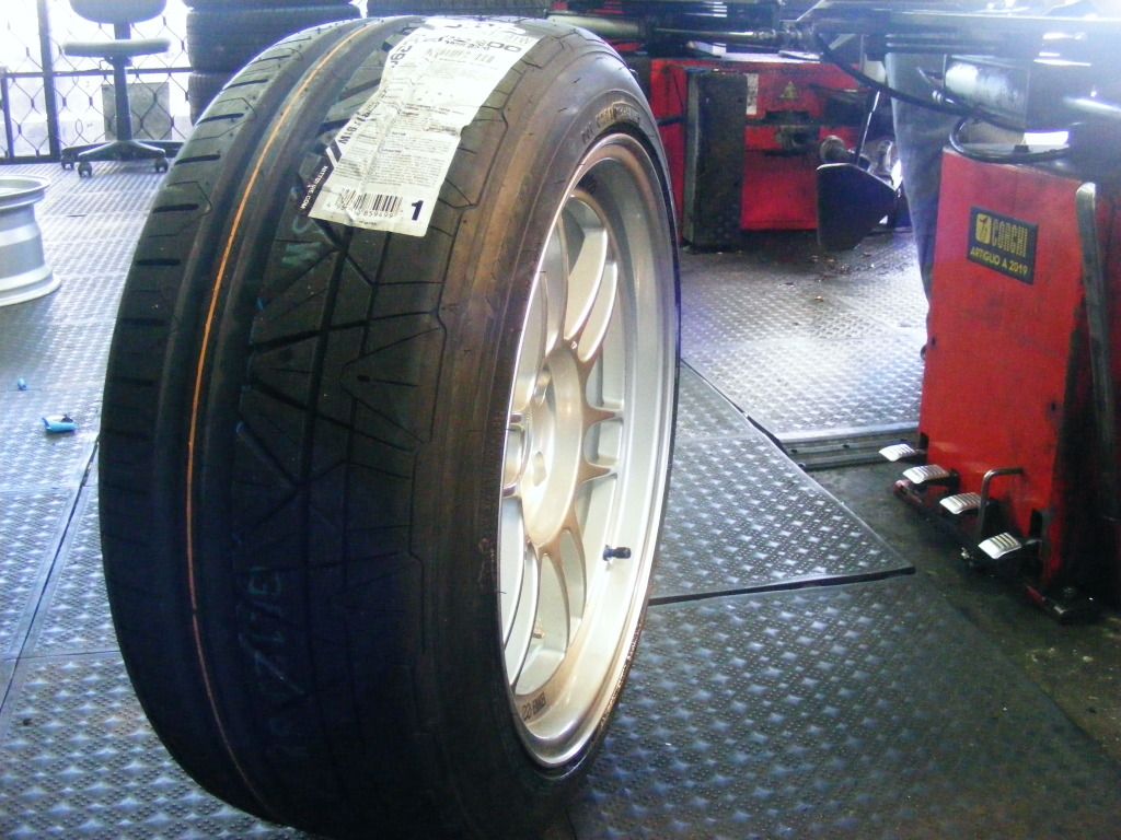

ryansmith
Mar 25, 2012
541
New Zealand
Suspension - Bilstein shocks, White Line sway bars, Cobra springs (60-70mm drop from factory as a guide)
Wheels - Enkei RPF1 17x9 +35 offset all round
Tyres - Nitto Invo 225/45/17
No rubbing at all, front rims sit perfectly flush, rear rims - looking down on the wheel when parked the lowest part of the rim is flush, top sinks in due to natural camber which I think is a bonus anti rub wise.
Would recommend this wheel size and tyre combo for people who don't want to roll fenders nor have any issues with rubbing.
Grandavi
Sep 25, 2008
2,664
Calgary, Alberta, Canada
Those wheels are excellent and probably the closest to stock wheel size (total height) so the speedo would also remain correct (if I did my calculations properly). Excellent fitment, but if your ever thinking BBK, remember.. 17's generally dont work. Otherwise, love that look!
ryansmith
Mar 25, 2012
541
New Zealand
Yeah forgot to mention about the speedo, I was -8/9kms out before anyway from factory so if I was going 70kms it read 60-62kms on the "your speed" signs.
It worked out that with this wheel and tyre set up the speedo will read + .3kms out which is nothing, well to me it isn't I may be wrong about the .3 but that's what I can remember.
About the bbk that would be true, I will not be doing that in my case I have just bought new rotors and pads as I only use the car for daily road use and find the braking fine IMO
