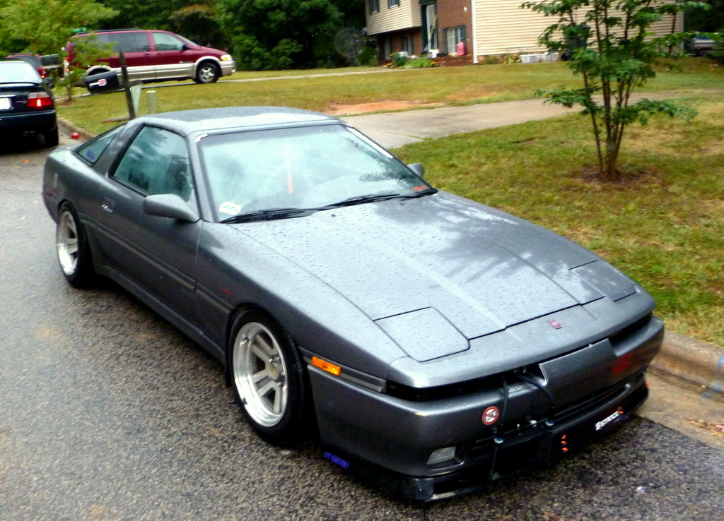

SupraRZTT, that would look SO AMAZING with a little more low and a little more poke.
Updated pictures with new random tires (burning these off at the USDrift event at VIR then mounting new tires on)
16x9 +0 225/50/r16
16x8 -10 205/55/r16
No spacers, very flat roll front and rear, tiny pull on front.
-3.5 deg camber rear, -2.2 deg camber front. Realllyyyyyy want to fix the rear and get it to -1.5 and -3.2 front but all my camber adjustment bushings are seized :(
