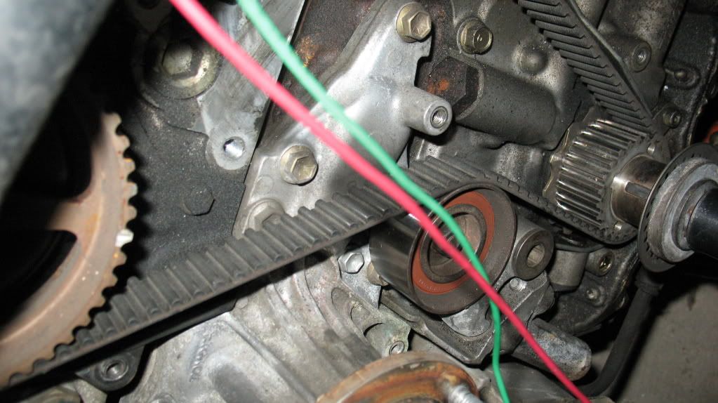

gdc5ind;1360396 said:
I thought the car sounded weird, and i noticed the timing was of so I did a compression test and leakage test. It passed the compression test 152 all the way down, the leakdown test was a different story. It failed on two cylinders, the exhaust valves were leaking.
How is the timing off?
gdc5ind
Sep 6, 2008
29
van nuys cali
Its off by one tooth on each cam gear. In this position the cam gear should be straight down and its not. The car sounded like shit, and that what mad me check the timing. Do you think ths valves DONE?
tissimo
Stock is boring :(
4,238
Melbourne, FL
With stock cams the engine is non-interference. Just fix the timing and itll be fine.
