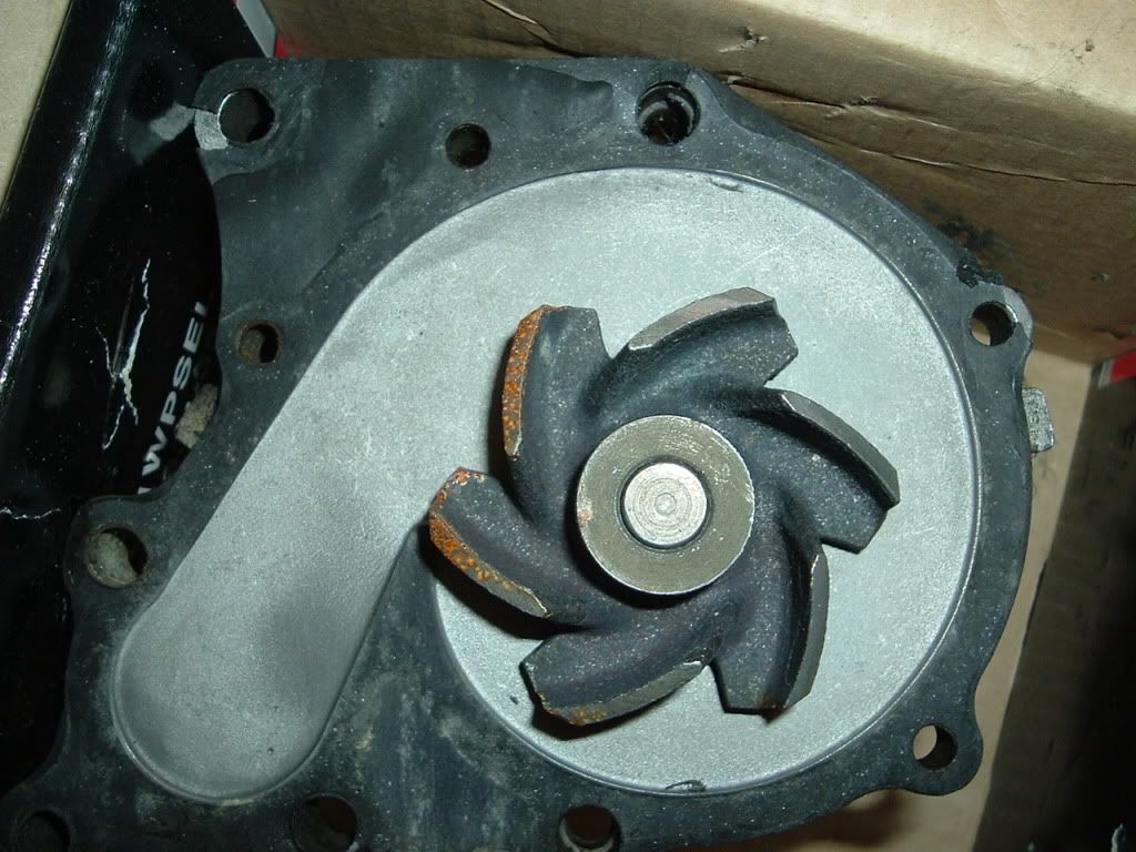

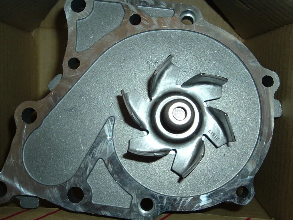

i bought a toyota one for my rebuild
this is a old one that was taken off the car
toyota water pump

Ive used all of those Go toyota its worth the few extra dollars. You'll thank yourself when your not doing the same job over again in 12 months.
5
Stock is a stamped impeller (as seen in the pic ^^). Most of the aftermarket ones are cast impellers and I've seen several impeller failures in my time on the forums... I bought one from the dealer for that reason.
