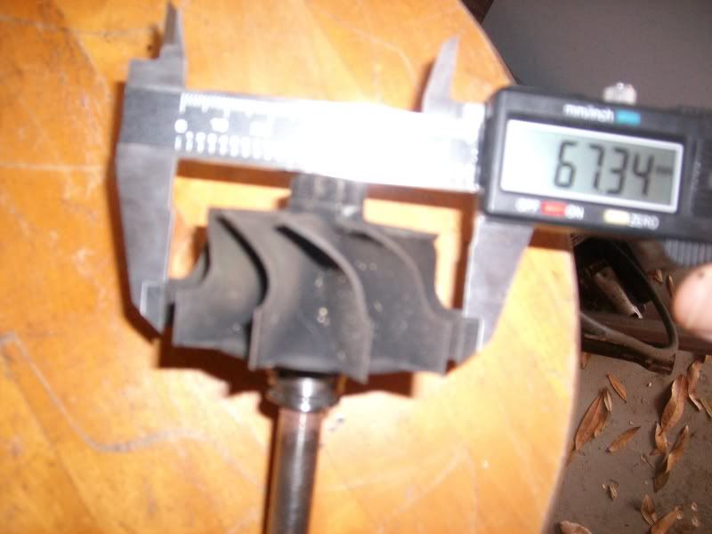

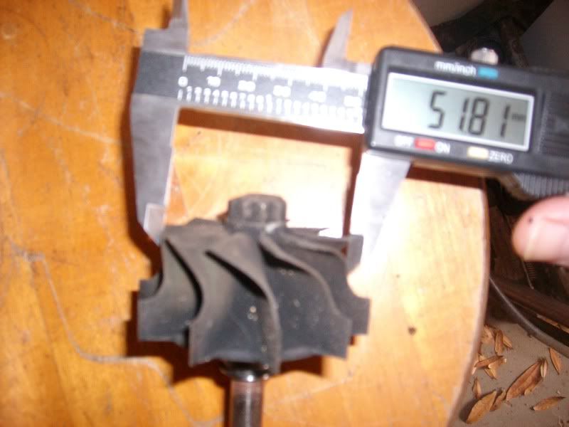

Not sure if this is even stock, or if I'm even measuring this right, but I'm gonna post these for others who may happen on this thread in the future for any reason.

much appreciated , kind sir - dont think il be going ahead with my idea however its nice to know
