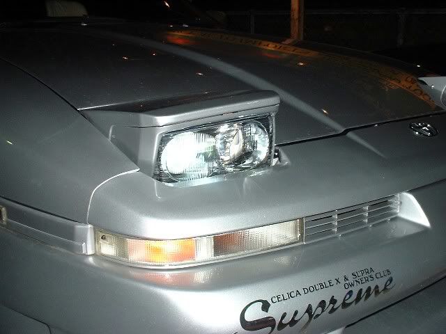

i'm doing the NSX headlight conversion:)
no, this isn't my car. my car is black, and this will hopefully be done before summer, as i already have the lights:)
