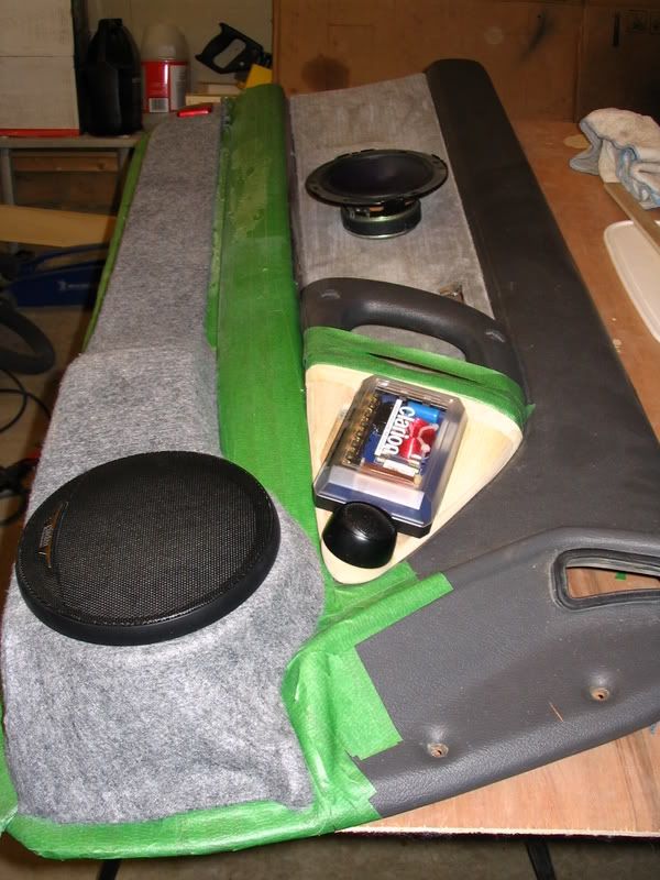

I have to also agree with GrimJack and Anthony. The best solution is using an amp to power the front speakers. I am pushing over 200W RMS into a 6.5 component set in custom speaker pods that replace the, IMO, useless map pockets at the bottom of the door. The pods are sealed and allowed me to move the 6.5 driver further front allowing me to reduce the difference in distance between the driver and passenger side. The tweeters are mounted just front of where the stock speakers used to be.

If you are going to put larger speakers in the front doors and not use a pod, make sure you insolate the front of the speaker from any openings close to it as you don't want any sound produced by the rear of the speaker to cancel the sound produced by the front. Make a wooden or plastic (solid) trim plate that would fill in the hole left by the original speaker pod.
