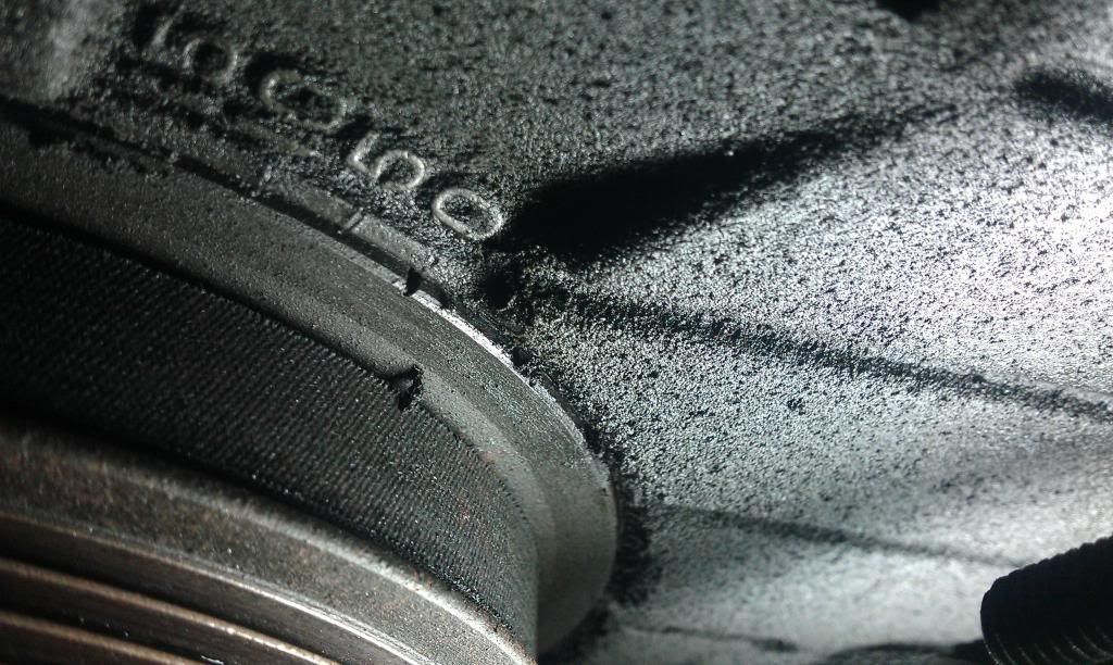

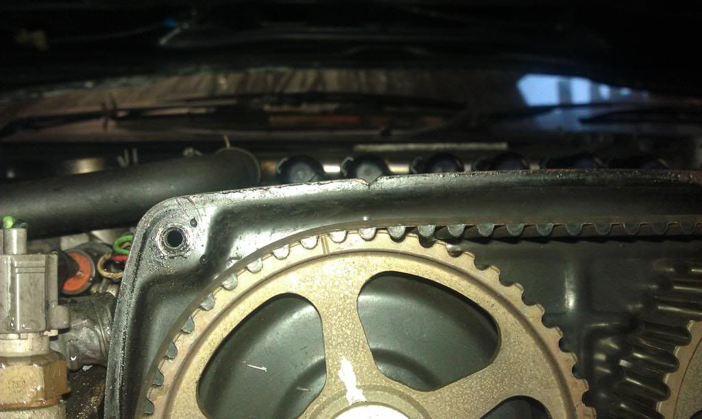

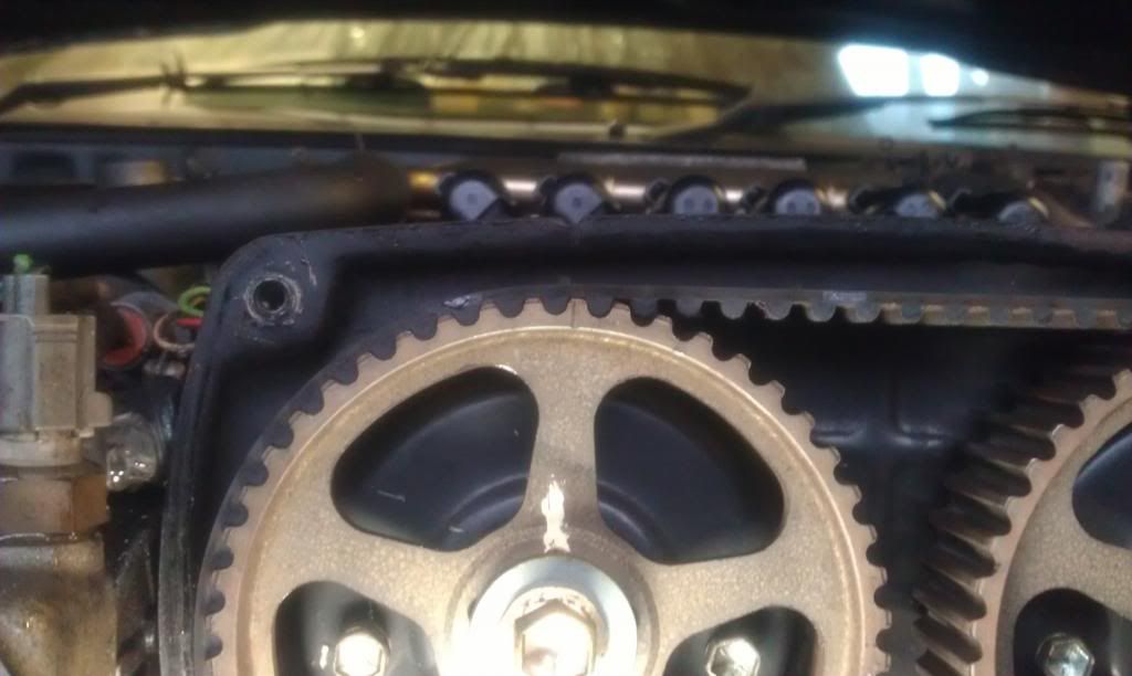

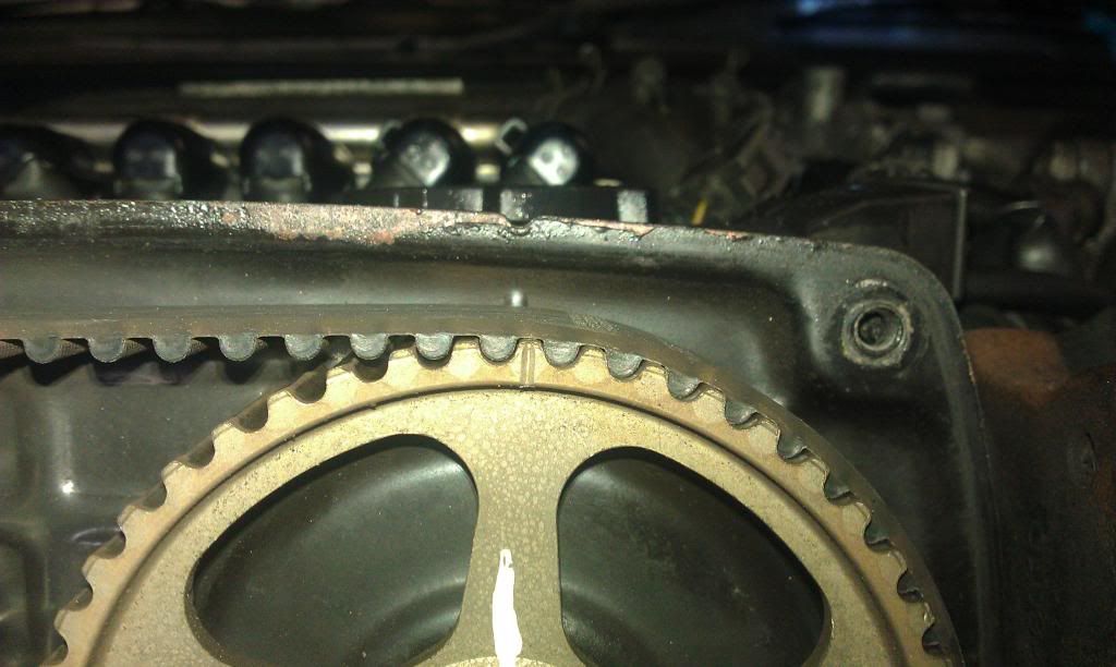

Today i was board and set out on finding what was causing the supra's lack of power. so i looked into the timing. Took all what needed to come off, off. and well instantly saw my issue.
Look at TBC (Bottom crack pulley lined to 0.
Inlet cam
Exhaust Cam
No problem i undone the belt (was real loose) turned the exhaust cam two teeth and placed belty back on
I noticed when turning the engine over before i adjusted the timing, it was easy to spin over by ratchet. Now ive done the timeing its harder. which is good.

Can't make out the knock you speak of because the video is a constant massive rev.
However, if the knock wasn't present before the timing adjustment, then it's something you touched.
I suggest you check the cam gear bolts and tensioner bolt to verify they are indeed tight.
