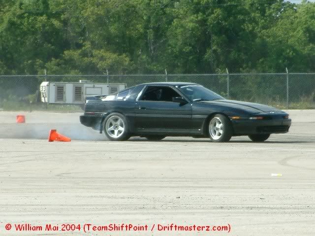

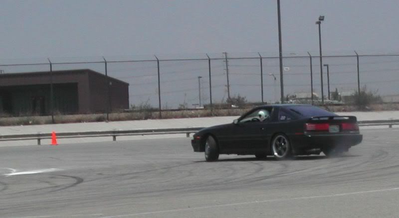

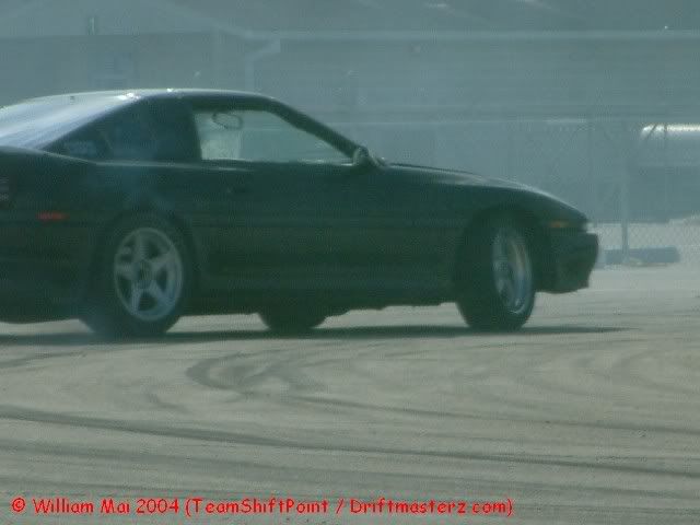

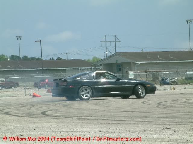

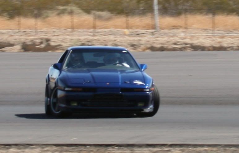

I think you are Mike!
How was the AutoX? Sorry I didn't call you back, you know how busy I am.
BTW... Everyone you should Listen to (c2m)Mike. Take your note pads out and start writing!
Here is some pics of his resume:
Enjoy!
