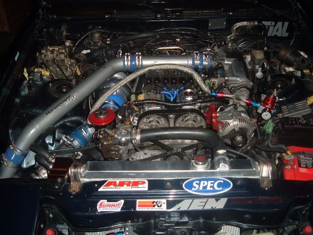

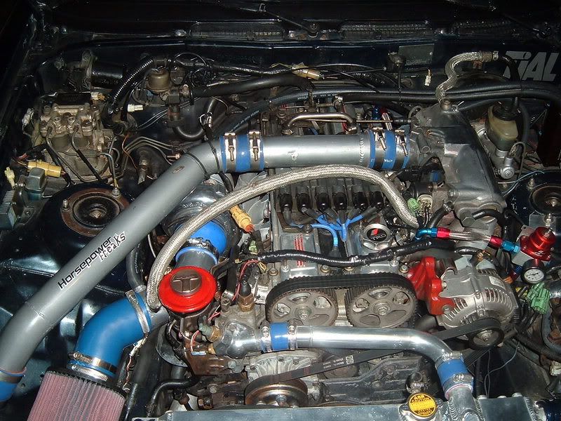

The problem I had when my pipes ran straight across the motor was that it rubbed on the skeletal frame of the hood and it also rubbed on the oil line going into my turbo... *I didnt have a stock turbo, so it might not be a problem with the stocker* It ended up rubbing a hole int he pipe where it touched the oil line... I had a hole the diameter of a pencil and about 2 inches long...
This is the mess when I first bought the car... *ahhhh the memories* But you can see where it was rubbing big time in this pic...

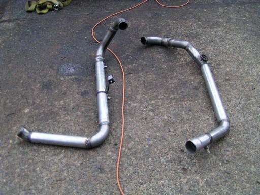

Does anybody remember Trent's old set-up?
It was similar to the number 2 picture of hardpipes but there was one less bend on the upper route.
It looked like two 90 degree bends up top.
This would be the shortest route.

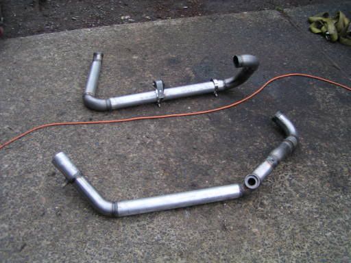

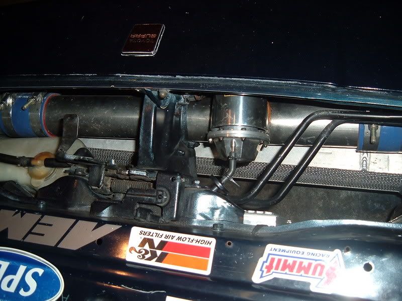

number 3 is the closest to my set up, i had mine put together by an exhaust shop, stinkin custom work.. im running a fmic aswell. & maft pro
this is what they look like on the ground, * bov flange on top pipe*
