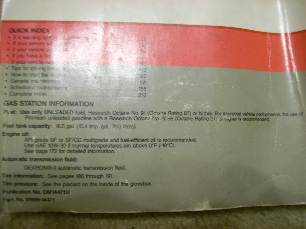

Uh, not entirely... 87 octane fuel burns more efficiently than higher octanes, but also burns at a higher temperature which can lead to detonation/ping. That's why its use isn't recommended on higher compression and forced induction engines. Less knock protection, higher EGT's
giterboosted;1518177 said:
well the manual for our cars doesnt specify if im not mistaken, but as earlier stated, if you can afford premium whatever it may be in your area,, 91, 93, 101, use it, otherwise use the best you can afford, if your car is stock then it shouldnt hurt to run reg, but when you start building it higher octane is better, to prevent pinging and knock
It doesn't?
http://en.wikipedia.org/wiki/Octane
http://en.wikipedia.org/wiki/Engine_knocking
