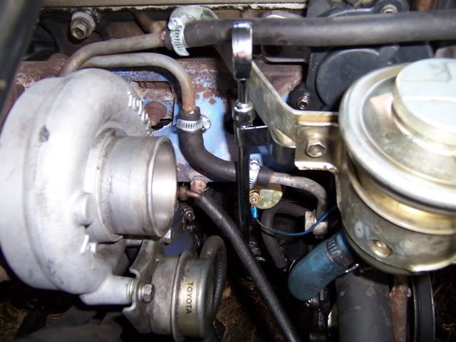

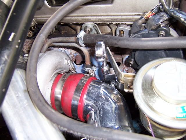

I did it by hand and it was pretty easy...maybe im just really strong LOL Just kidding....i didnt have to bend it too much its pretty much in the stock location right next to the turbo but i have a precision turbo and tubular manifold that sit a lil higher and further from the engine than stock.....ill see if i cant get a pic up here soon

i used a torch to bend it then just repaint it when you are done if you dont have a torch use a propane one to get the job done, also replace the seal at the end at the same time. Use a new stock one so the rubber don't end up in the pan
