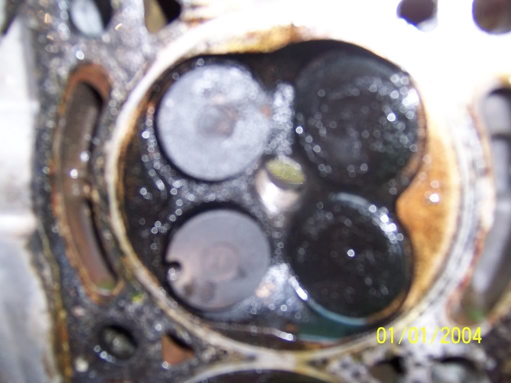

My fault. I wasn't being very clear. I wasn't quoting either my mechanic or the machinist. I also didn't mean to imply that that was the root cause of my burnt valve. The deterioration of the valve seat and improper sealing of the valve due to excessive heat, ethanol-blended fuel, tired valve spring, etc is most likely what caused it. However my injectors were in fact leaking quite badly and that's why I think I found quite a bit of carbon build up when I pulled off the head.

I very quickly check the block deck with the straight edge for warping and it looked fine. In addition to that, since the machinist had told me there was no cracking or warping on the head (and aluminum being so much more prone to warp than the iron block) AND my low miles, AND never having serious overheating problems, I thought nothing of it. Perhaps this was my Supra Noobishness getting the best of me.
I have heard of people insisting that without going back in and at the very least checking the head bolt torque after the engine goes through a few heat cycles, the HG will let go. I hadn't done it since I figured the 75 ft lbs would more than compensate me for any head bolt stretching that might occur.
It was a complete head gasket kit, from either Rock Auto or Arrow, I don't remember. The machinist had got it from his supplier. That way he'd have all the replacement seals for putting the head back together. I remember comparing the new hg to the old one (original Toyota) and it did LOOK identical... FYI my 7M had just passed 70,000 miles when the burnt valve occured. and certainly appeared to have never been opened up before. I did the work at my mechanic's shop (he's a family friend) and he did help me at times. But I essentially did the work, and I was constantly checking the tsrm throughout the tear down and assembly, so I can't really blame him. He's a certified Honda master tech, but he's been working on more or less everything for 40 years plus and is familiar with the Toyota M-engines, so I took his advice when he gave it. Oh, and he never referenced the tsrm as being for rookies :) .
