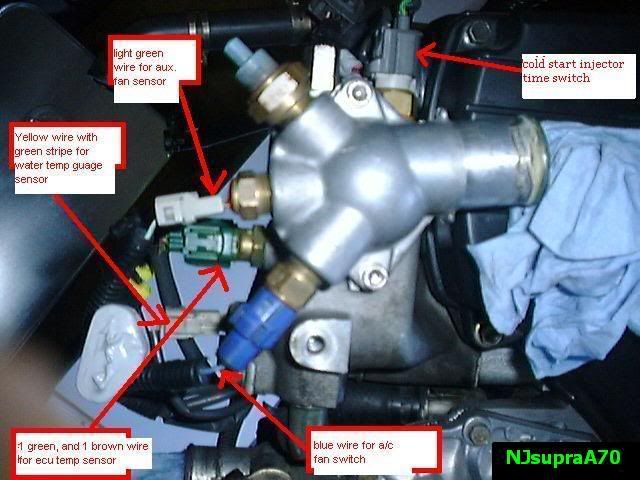

Clip said:Can I uncork this plug to install a second temperature sensor for an aftermarket gauge, or do I have to install it in the stock location?
jdub said:You don't have an aux or A/C fan do ya?
bryanintexas said:Yes you can. That`s where mine is mounted.
86.5/early 87 had no acc. condenser fan in front of the condenser, therefore no sensor in the housing.
NJsupraA70 said:I didnt say you couldnt move it, I said you couldnt remove it completely.
I am talking about the ECU temp sensor, not temp. gauge, a/c fan, or aux fan sensors.
