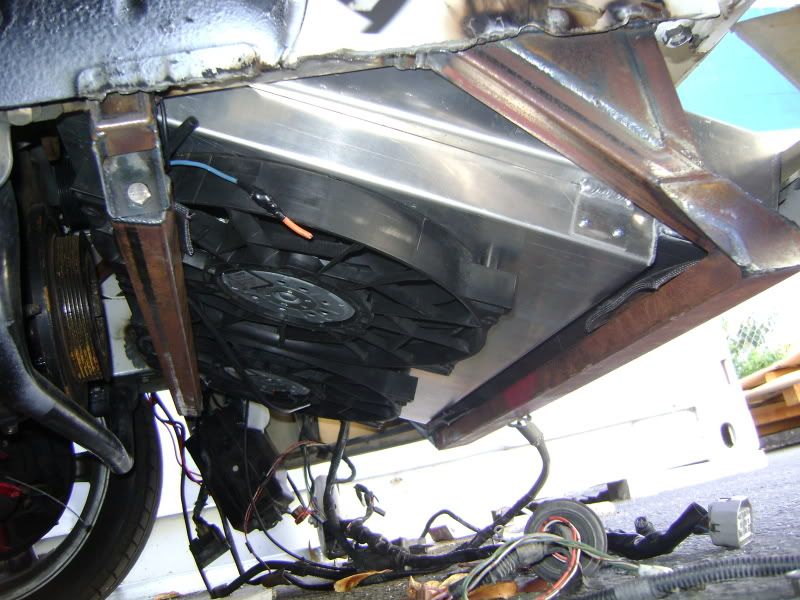

You will get more cooling with the radiator straight up and down plain and simple. I work in the drift scene and see cars with V mount setup's all the time have cooling issues compared to a regular setup.. Although V mount is cool, its not very practical.

V-mounting is more effective in racing where the car has more forward movement and therefore airflow. Time-attack is a great example of this. In low airflow situations (drift/auto-x/street driving) it becomes a liability.
Drift is extreme in the small amount of airflow the radiator sees vs the power used and rpm's the engine turns at; so fans are relied upon to provide the airflow. They are never enough it seems...

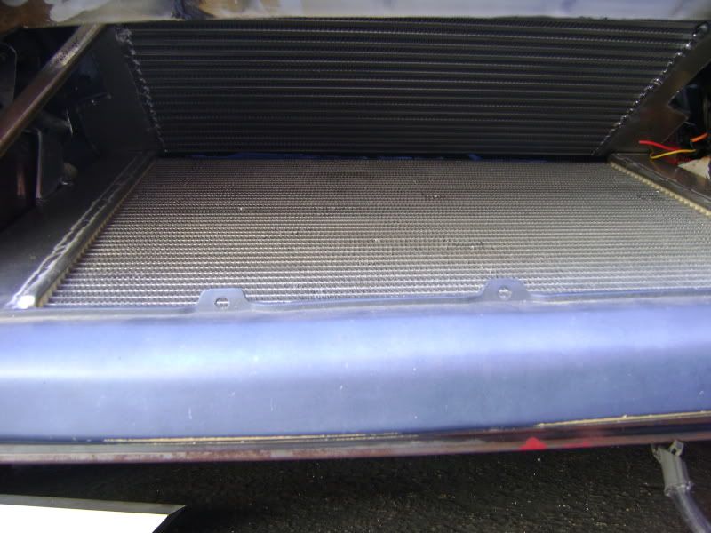

Thanks for all the feedback guys. I have heard that the v-mount isn't quite as effective at low speed however I want to try it anyways and we'll find out for sure. I got a few more pics today.
Started cutting on the bumper the other day. Not nearly done yet but it give a general idea:
Lots of surface area (radiator on the bottom, intercooler on the top:
Here is a pic of the radiator on the car, you can see the mounts pretty well

Proper ducting is about the best thing you can do with some very high quality not cheap electric fans. Alumi-tape and the plastic or sheet metal helps TONS! Thats where most V mount setups lack and then start to cause overheating problems. Ducting is key!

No I don't want to use ducting. I am going to put all this work into this setup and not actually do it right.:icon_razz lol
There will be ducting as well as full underbody aero ducting and a custom rear diffusser
