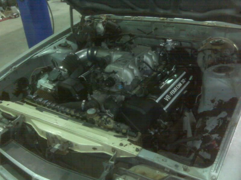

RogueSteel;1433134 said:Mother of god.....haha respect the classics
Subbed, I want to see this!
LOL... I wanna see it running too...

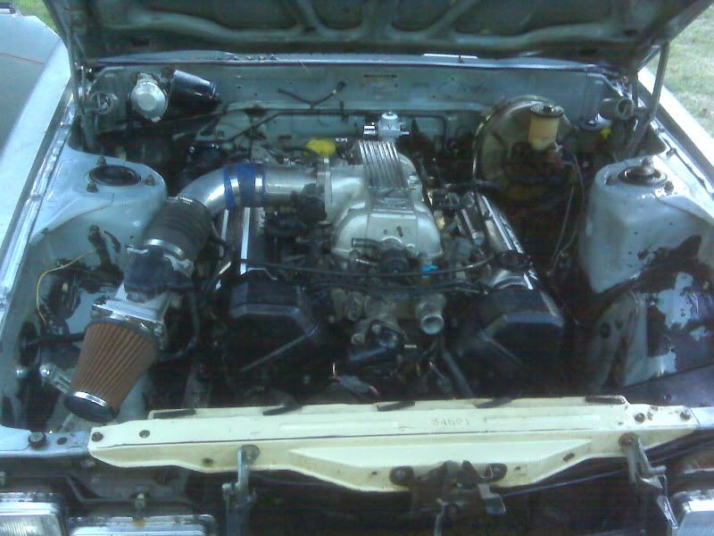

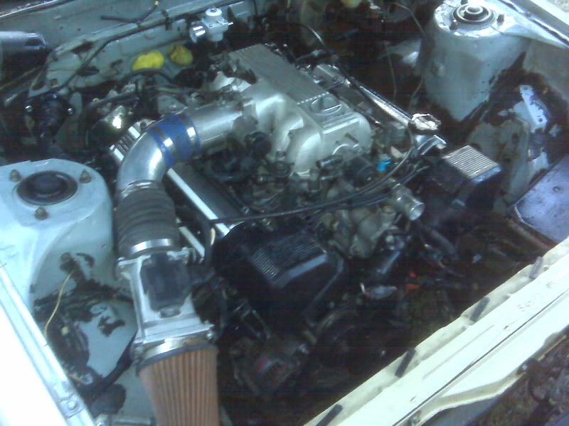

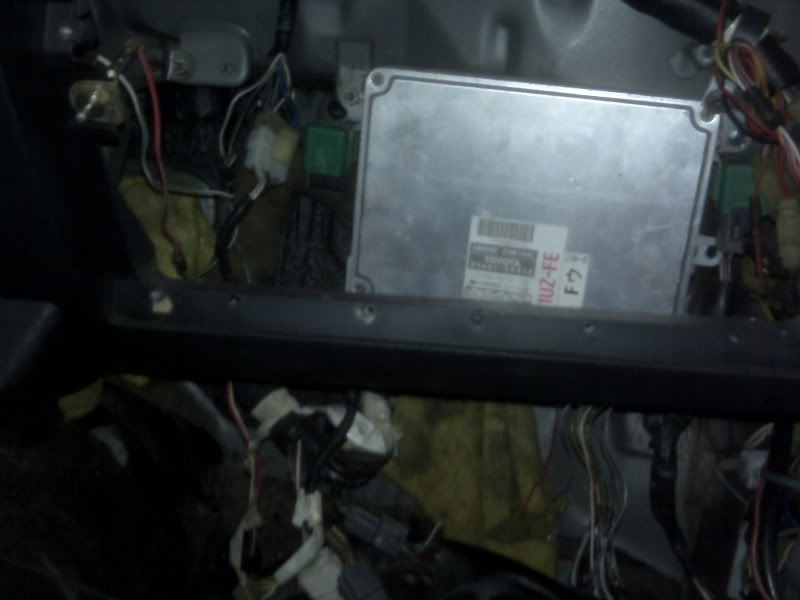

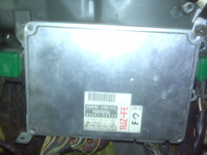

Zerocool;1433313 said:Looks like fun, what are you doing for engine managment?
Stock ECU and nitrous for now, I have an aem and an emanage blue laying around not being used. I may end up going one of those routes. I personally think the emanage blue will be more than sufficient for the supercharger. Tuning a supercharged engine is much less of a task than a turbocharged one. I won't need two step features or anything like that, as the car is auto and I have no need to build boost from loading the engine.
funky_monkey58;1433321 said:If I were a betting man, I would say he is likely to go with a maftpro?
Doubt it.
