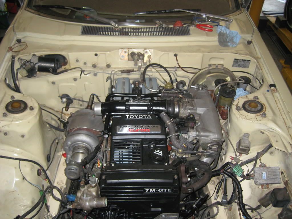

IMO the linkage setup on the LHD 7m engine is absoutely hideous.
Since I had to go with a new cable for my drivetrain swap anyways I got a lil creative and used an automatic transmission kickdown cable from an Isuzu SUV, looks much better than the OEM LHD setup.
