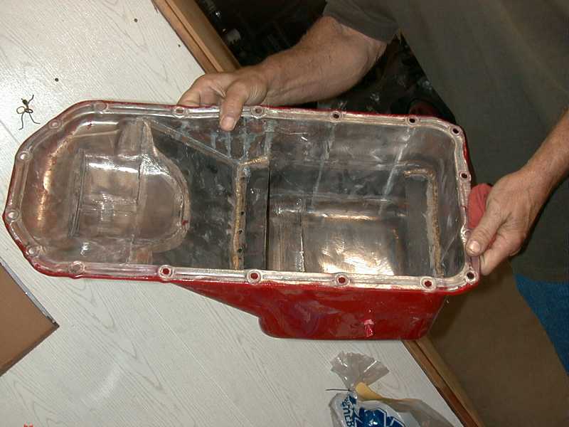

Hey all thanks so much for your advise. Yeah i'm going to try the whole magnet thing tomorrow. Does anyone have a pic of inside an oil pan?

PS. The pic of the sump would be real good! cheers

Pete: I don't have a stock sump handy sorry.
I can describe it though ;)
There's a sheet metal baffle that's horizontal about 50 mm down from the mounting lip, your tool will be sitting on that so I can't see the magent thing working.
I also have doubts that Oil will be enough to "wash" it off the shelf into the bottom of the pan then you have the Lip at the drain plug to get it over if you get that far!
Sorry to sound negetive but I'd just drop the sump.

something allong the lines of this IJ? or is the shelf bigger/ more vertical?
to bad you cant pick up the car and shake it arround untill it falls into hte sump.
i dunno if the shelf isnt much bigger than this a good volume of oil COULD flush it off of the shelf or using an air compressor and nozzle small enough to shoot into that hole. (just plug the other holes so oil doesnt shoot straight up out of the other oil galleys) and a wire feeler/hook could get it to the drain plug, i dunno its worth a try before dropping hte crossmember, $150 is a $150 you got till monday anyway.

AJ: The horizontal shelf is much bigger, think of the pickup there is a big enough hole in the baffle for it to fit through!
Maybe jacking up the back of the car would help but it still might not roll forward as it's a hex key so will probably be sitting on a flat (I'm assuming Petes used a 10mm key in a normal socket and has dropped just the key)
